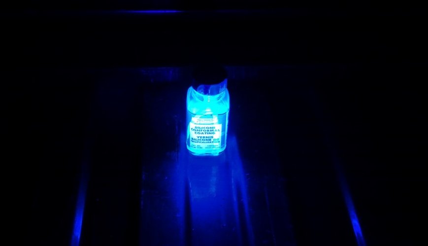

Conformal coating is typically UV sensitive as well so you can see see any missed spots under a black light. In the first photo, my ESC and dig servo both glow bright the conformal coating.
