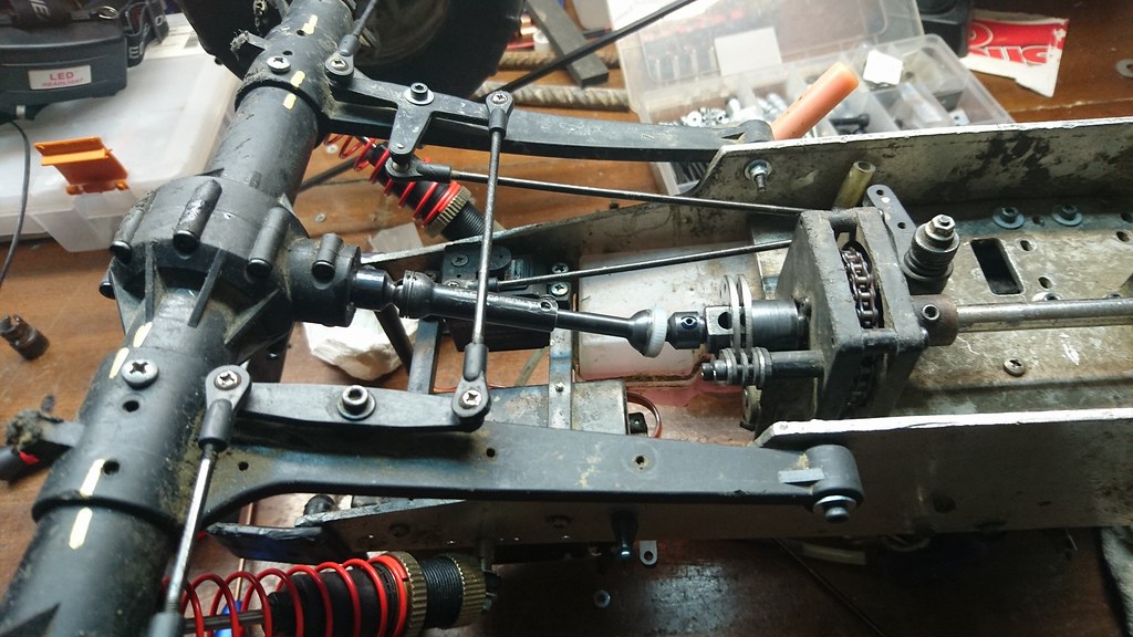

My final version of front cvd. Two bushings with 4 set screws each. Already made two tanks of fuel and they hold just fine

Didn't had the chance to try them furthermore. Hopefuly this week/end. But, compared with the first version, they are bulletproof. Consider this tipe of connection is commonly use to rotate a differential, hence two wheels, so why wouldn't it resist to only one wheel?

One and a half year later... and they are holding strong! "thumbsup" Thanks cmbscx10 for the tip, using Losi LST driveshaft.
And if we are talking about this, there are my latest upgrades.
For the rear driveshaft it was pretty straight forward, only had to reduce (on a lathe) the output of the pinion from 8 to 5 mm

For the front driveshaft I had to fabricate that small piece of metal, nothing too complicated. At this moment, the only difference compared to the last picture is that I'm not using that Junfac driveshaft, but I have on both ends the RC4WD ones. However, I'm not very happy with them, after not even 2 minutes into the first run, the rear driveshaft (the only one installed at that moment) fell apart in the snow. Luckily, I was able to recover all the bits and pieces from the snow and rebuilt it. Furthermore, if you look closely at the rear driveshaft, I manage to fabricate a protection for that little pin that fell apart. It's made from 12mm copper sleeve, painted in black so it's hard to see (it's what you use to connect two copper pipes). The thicker pin stay in place just fine, no chance to loose it so there is no need for a protection.
