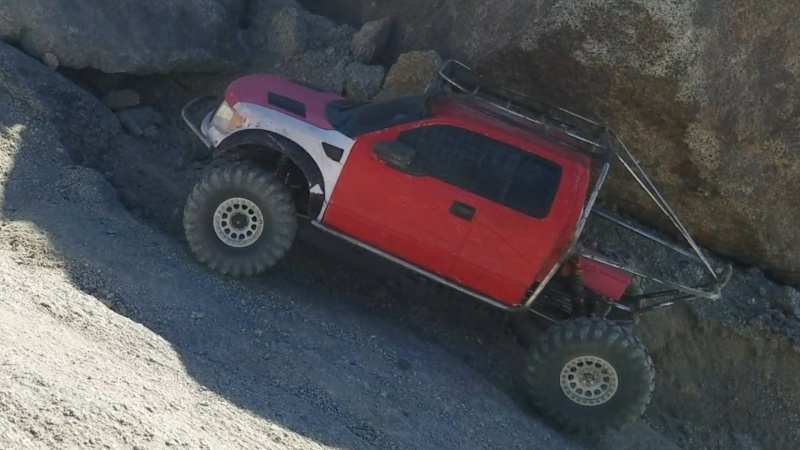

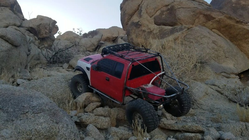

lol sounds almost exsacly like my trx4 build same body but in red and same axles with red highlights but no wideners and only 6" tires and only 18 inches long
my 6 year old grandson just beat the snot out of it till the rodends gave out lol
i only have a few runs with the capra axles and even with no brass its still alot more stable than the trx4 axles all brassed out i did loose the open/locking diffs though
no video after the axleswap but heres a few pics in my backyard crawler course
Looks super scale and legit with the smaller tires fit under the body like that. Bedazz lookin fuel cell doesn't hurt either ;)
Very cool and love the cage of course too albeit not into tucked rear ends they sure crawl nice.... i apparently like draggin' a big rear end up the hill 😜
I'm a little more after the mega truck look but nice to see trx4 bigged up!! And somethin' about a back woods off-road hauler and or crawler lookin' hack job (mine are pretty hack at least lol) trucks with hard metal gritty guts under them just gets me goin!!!!
Very cool and love the cage of course too albeit not into tucked rear ends they sure crawl nice.... i apparently like draggin' a big rear end up the hill apparently. 😜
thank you the fuel cell is just a servo case painted red with some details
yours looks good too i think we have the only 2 cab only new bright raptors outhere or atleast on here lol
funny almost the same truck yet so different
the mega truck dosent work were for most of my crawling but dose look good
