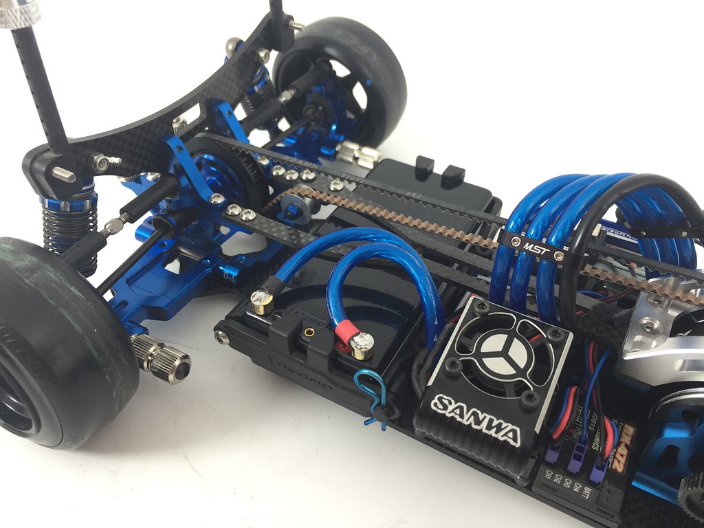

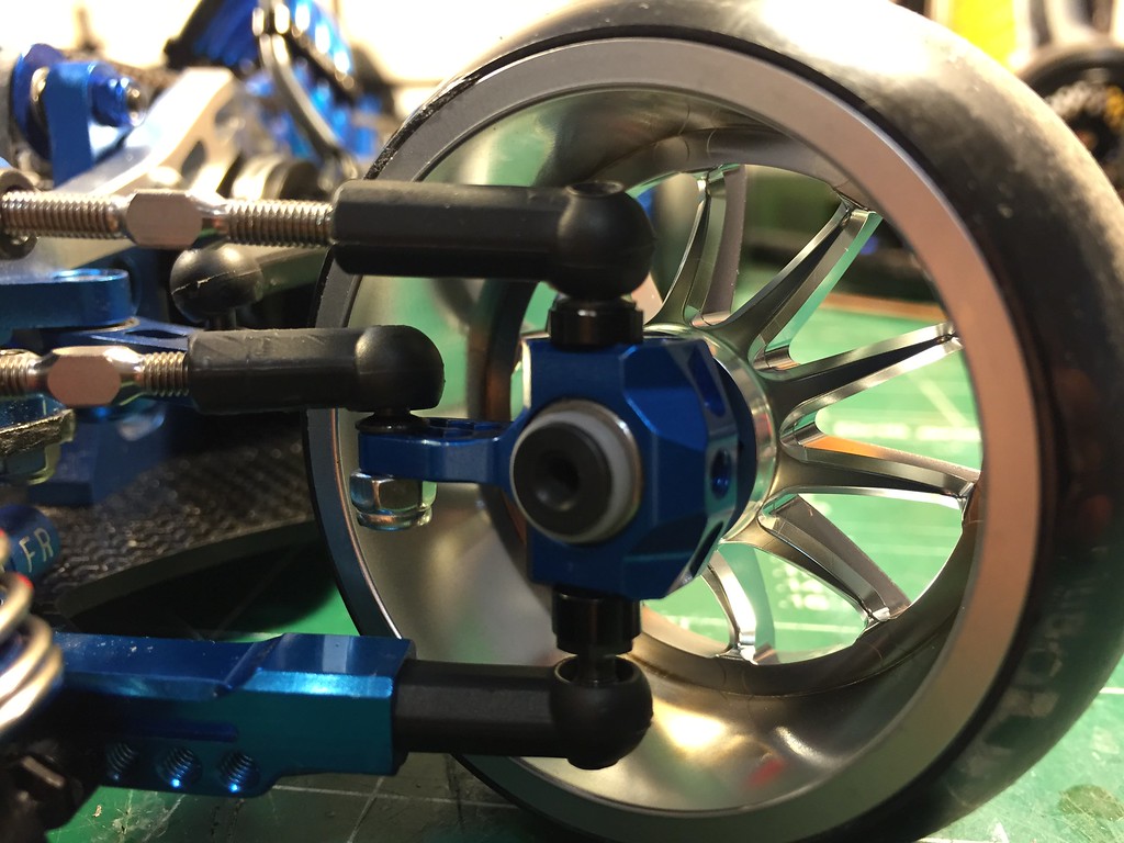

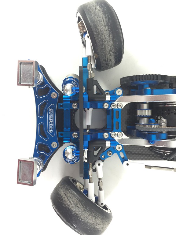

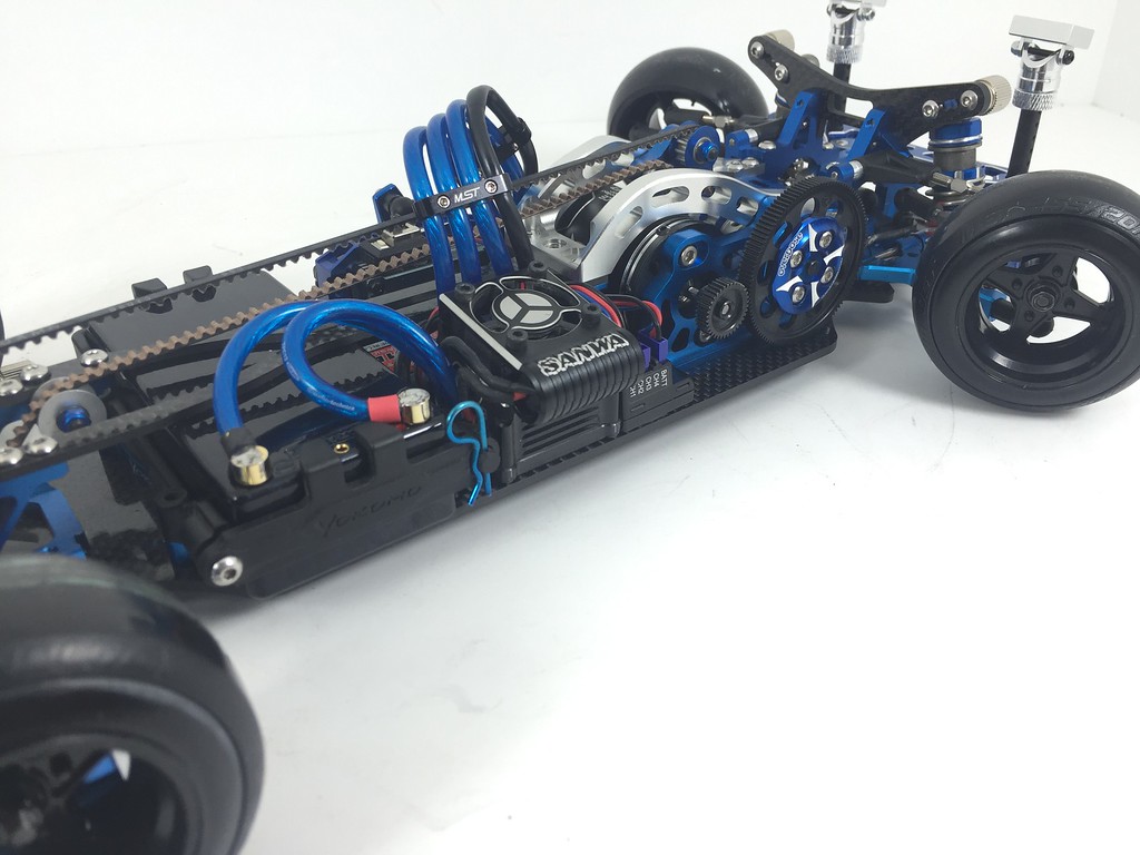

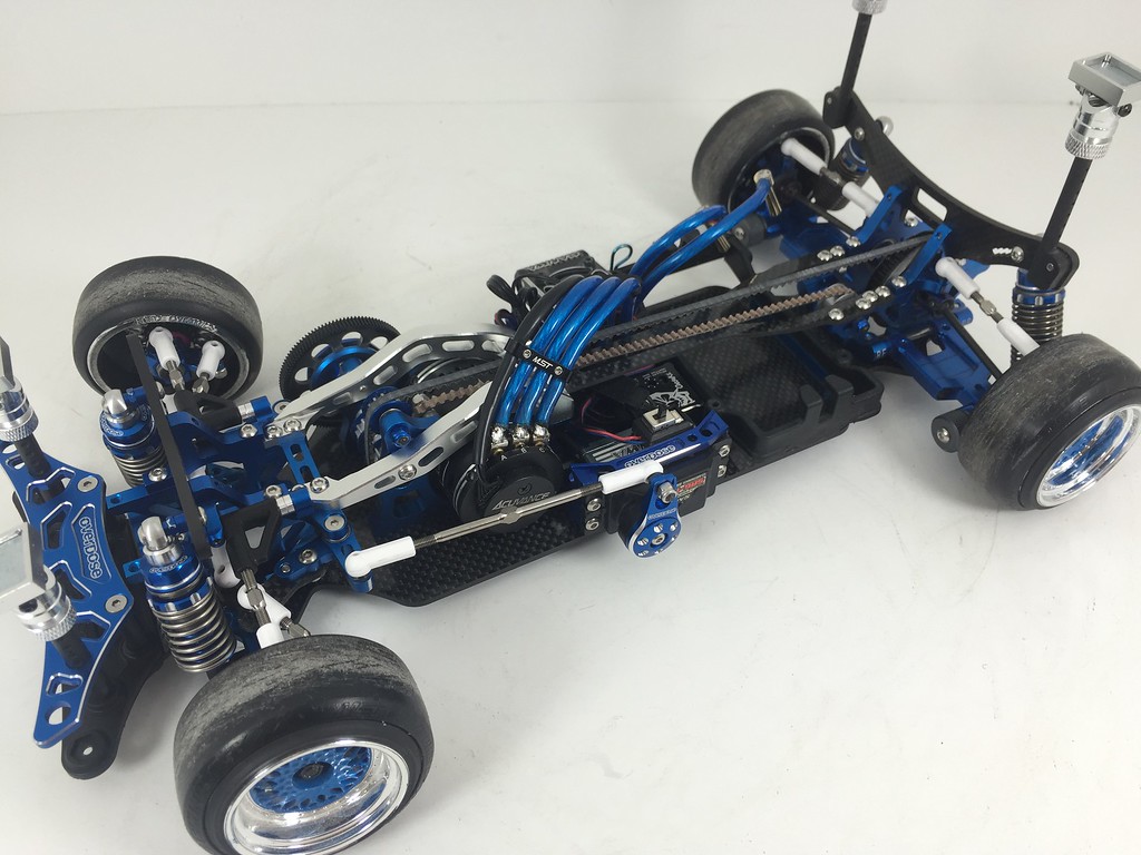

There's been quite a bit more progress on the DRB since I last posted. The gyro and servo are still working well and I've been continually making improvements to the suspension. I adjusted the front end quite a bit for more angle without binding and it seems to be working. I'm also still trying to get the rear end softer and may have finally stumbled upon a solution. You see, I'm running Wrap Up Next rear arms/hub carriers and it moves the lower shock mount all the way out to the carrier. This does a few things, but two downsides are less overall suspension travel and a stiffer effective spring rate due to a lack of mechanical advantage when the suspension tries to compress the spring.
I picked up a set of super soft (12.25?) rear Wrap Up Next (WUN) VX springs. That seems to have helped a bit compared to the MST yellow/orane springs I'd been running lately. But perhaps more importantly, I moved the hub carriers inboard just a bit. The WUN carriers/arms have lots of adjustment available, which made this possible. This narrowed the track, but also have back some mechanical advantage to compress the rear springs. In order to keep up with everyone at RC Garage in Houston, I've been experimenting with adding weight to the rear end, as well.

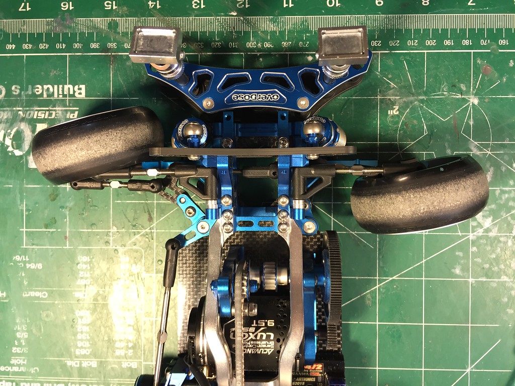

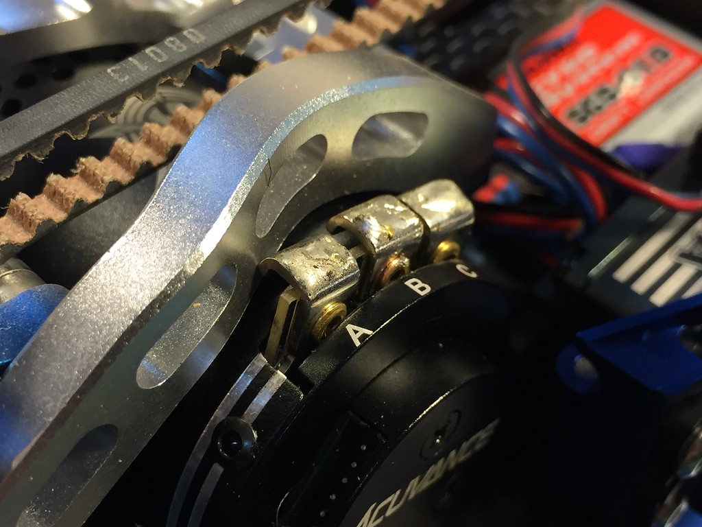

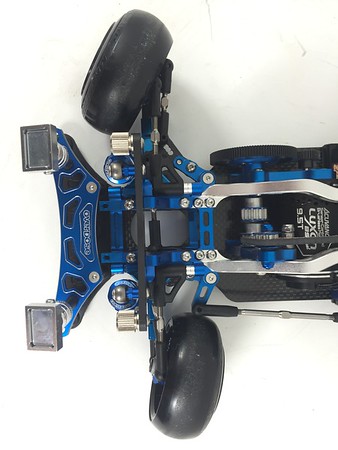

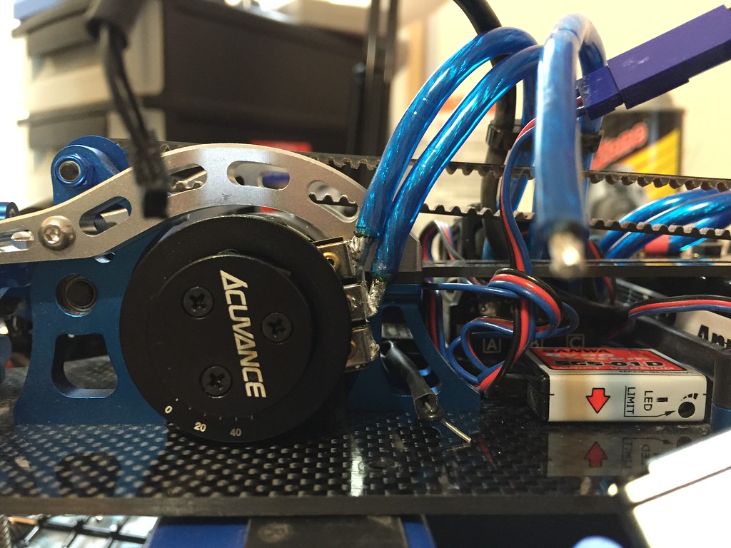

One of the next things I wanted to do was upgrade the motor. In all honesty, the Speed Passion 10.5 has served me quite well and I don't have any complaints about it, but I wanted something a little nicer for this build. I did a bunch of research and had decided on a Tenshock 4 pole motor, but they're next to impossible to find. I'd heard many people speak highly of Acuvance motors, though, so I decided to give one of them a try. Couldn't locate any 10.5s in stock so I opted for a 9.5 instead. In preliminary testing, it doesn't seem to be excessively overpowered at all, so I think it should work out just fine.
But there's a bit of an issue with mounting the motor. With the solder tabs oriented where I wanted them, they were contacting the chassis brace.
That's not good. I could clock the motor over about 60 degrees, but now the angle will make it difficult to cleanly route the power wires to the motor.
Since I'm not sure I could find a happy middle ground between the two positions, I opted for the latter. Honestly, it's not as "clean" as I'd prefer and I think I'll eventually shorten the wires to tidy things up a bit more, but it's not too bad the way it is.
I also moved to a larger spur/pinion. Running a 112/36 which puts my final drive at 8.29 now.
Steering lock is adequate.
![IMG_5281-XL.jpg](/forums/proxy.php?image=https%3A%2F%2Ftommyr.smugmug.com%2FHobby-Stuff%2FYokomo-DRB%2Fi-t73j2Lv%2F0%2FXL%2FIMG_5281-XL.jpg&hash=b04a04c615c6c0e9a7675ec4e808cda7)
![IMG_5270-XL.jpg](/forums/proxy.php?image=https%3A%2F%2Ftommyr.smugmug.com%2FHobby-Stuff%2FYokomo-DRB%2Fi-LQgrHpH%2F0%2FXL%2FIMG_5270-XL.jpg&hash=ec10f6b464f8dd2d8e31a05a59f694ba)
![IMG_5272-XL.jpg](/forums/proxy.php?image=https%3A%2F%2Ftommyr.smugmug.com%2FHobby-Stuff%2FYokomo-DRB%2Fi-7X3Qp53%2F0%2FXL%2FIMG_5272-XL.jpg&hash=5ec94f28aa7e5388a3d9f9c3a9615b6f)
![IMG_5289-XL.jpg](/forums/proxy.php?image=https%3A%2F%2Ftommyr.smugmug.com%2FHobby-Stuff%2FYokomo-DRB%2Fi-4vGJ2SR%2F0%2FXL%2FIMG_5289-XL.jpg&hash=b857cc091b7d97ae2c2e633386b47c62)

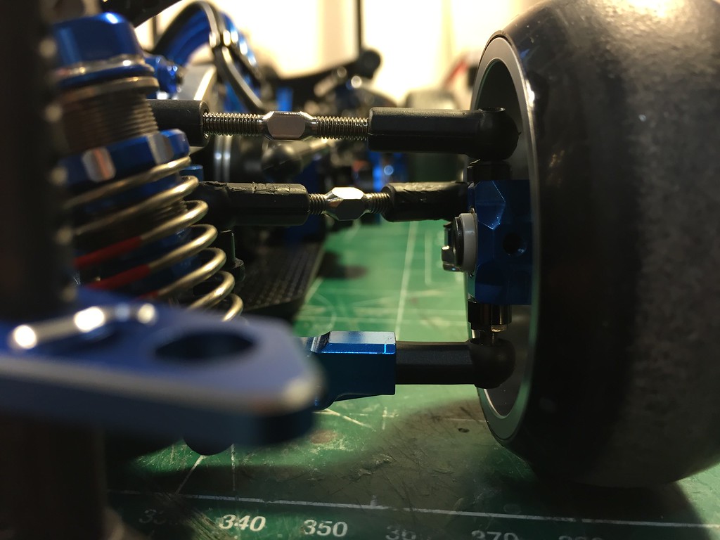

![IMG_5292-M.jpg](/forums/proxy.php?image=https%3A%2F%2Ftommyr.smugmug.com%2FHobby-Stuff%2FYokomo-DRB%2Fi-fWVKgbw%2F0%2FM%2FIMG_5292-M.jpg&hash=6c4f3d083ed0c688af180278b8eb17d5)
![IMG_5290-M.jpg](/forums/proxy.php?image=https%3A%2F%2Ftommyr.smugmug.com%2FHobby-Stuff%2FYokomo-DRB%2Fi-V6t6cK2%2F0%2FM%2FIMG_5290-M.jpg&hash=321ed9e9833d61f3b0f71b71882ecb70)
