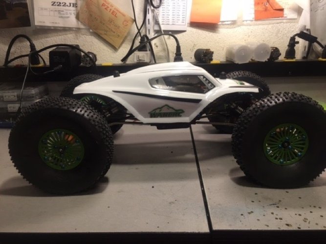

So winter boredom set in and the 12 step program that was supposed to help me with my RC Crawler Build addiction FAILED
Built this Truck Last Year so this is just a refresh
[FONT=&quot]1st of the trucks thru with winter [FONT=&quot]m[/FONT]aintenance[FONT=&quot] [FONT=&quot]p[/FONT]rogram[/FONT][/FONT]
[FONT=&quot]Ready for a new season.:mrgreen:[/FONT]

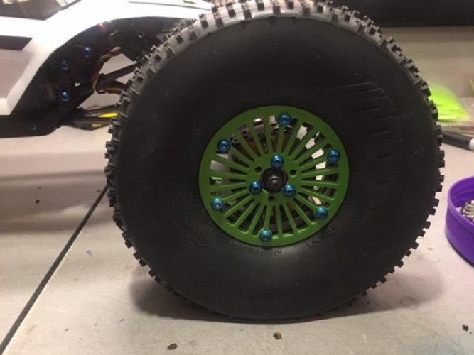

5<sup>TH</sup> Dimension 24 spoke G-10 wheels TNX Chris & Dan ."thumbsup"
Narrowed /Comp. Cut by Me Voodoo’s Gold’s Up front, Blues in the rear[FONT=&quot]:mrgreen:

[FONT=&quot]Fresh XR-10 body & paint.[/FONT]

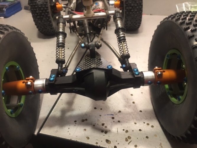

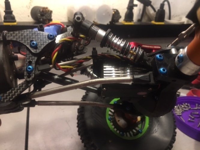

Chassis
YTC Villain with CCC Bulldog Trans plus RC4WD lightened Berg Gear
SX-10 Icon 7mm Shocks front & rear internally limited with MRC Light Springs
Titanium 4 links & drag link by me
Axles
Axial Ax-10 with XR-10 mod.

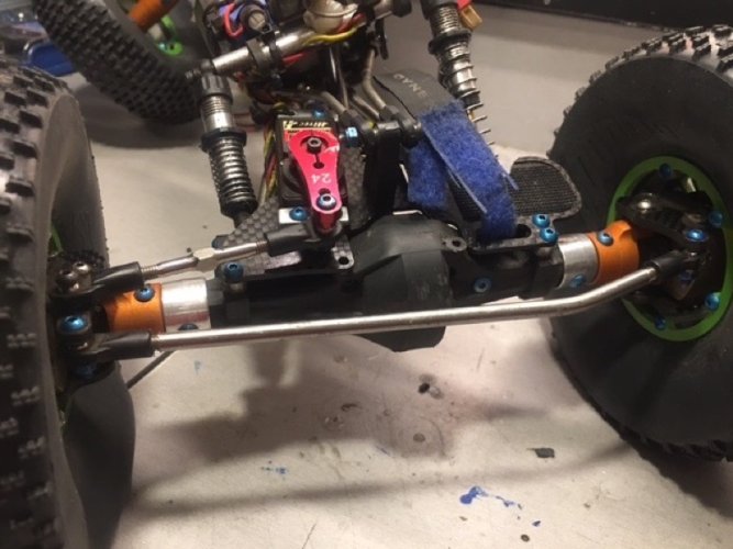

Front:
Axial Overdrive Gears and 70 Deg. Universals, VP 8 Deg C’s,
Dlux Knuckle weights, Brass Splined Beefy Tubes by me

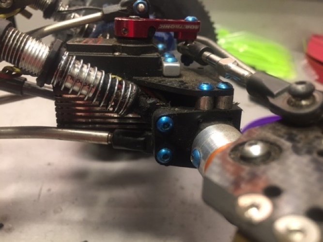

Hulksta Eng. Smash Plate Servo/Battery mount TNX DAN
Junfac drive-line.
Titanium 4 link & Tie rod by me
[FONT=&quot]Holmes Torque [FONT=&quot]M[/FONT]aster Spool[/FONT]
Rear:
Axial Under drive gears, VP Clamping Lockouts,
Hulksta upper 4 link mount ,
Aluminum Splined Beefy Tubes by me
Titanium axle shafts,
Junfac drive-line.

I ordered a smash plate today.
DO you have to use the axle collars or can the stock provisions handle the work?
No It comes with all the hardware to fit the stock Ax-10 axle housing ,I just modified things to make it fit with the CCC axle collars
The shorter spacers had to be used to fit the axle collars
Depending on your Shock / 4 link set up you may have to grind some clearance to clear the left side shock but that's no worries the battery still fit just fine"thumbsup"

nice simple rigs always like this chassi and we don't see many here so i love the way of been different on the other parts too!!!

The wheels look cool do u know if they vome in other colours? Nice build anyways mate&#55357;&#56397;
