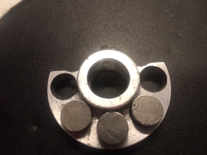

So after the initial test/tuning with initial set of rear weight holders made out of Delron on my SuDo Pro truck
Decided I liked the way that truck handled with rear weights. So fired off the computer and wrote the G-Code and made a couple set's out of 7075. For my Truck and my Son's Hulksta Riddler "thumbsup"
Replaced the brass weights with some Pinewood Derby Tungsten weight's Settled on 1.9 oz per side for now

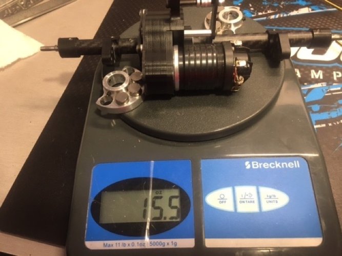

Well after an hour its assembled and ready to install in the truck as a retired CNC Shop owner/Machinist I always looking at Fit and Finish this was an A+++ RobBob for its intended use."thumbsup""thumbsup"
Gear mesh was spot on. The motor makes more noise then the gears.
The only fitment issues was a little more end-play on my Titanium long side axle shaft, the stock shaft fit just fine so I add a .010 shim between the bearing & shoulder an perfect O:)
Only other mod so far will be to bore about .034 so my rear axle weights will fit over the outer tube bearing retainer's
