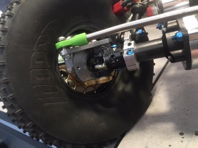

Since I’m not a fan of threads in Delrin. I machined some Aul. Clamping style 4-link shock mounts out of 7075 T6 also made some of my 1pc 7075 T6 hubs"thumbsup"
A little Boredom set a couple of weeks ago and in so since I'm not a fan of threads in Delrin.
I decided to machine some new front tube's for my Superlites out of 7057 T6"thumbsup"
Basically just duplicated Dlux's tube design but add my clamping style 4 link / shock mount's.
I was going to Spline the C hub end for Axial Wraith style
Chubs BUT GOT LAZY and stayed with AX-10 Style C hubs LOL
This may change later this winter when cabin fever sets in.:lmao:
I need to ad some spacer's under servo to raise it up even with bottom of the tube so it does not hang up on the rocks
After they were finished they only weighed .26 oz (7.3 grams) more then the Stock Delrin tubes :)
Please note I only make these parts for myself I will not make part's for other people

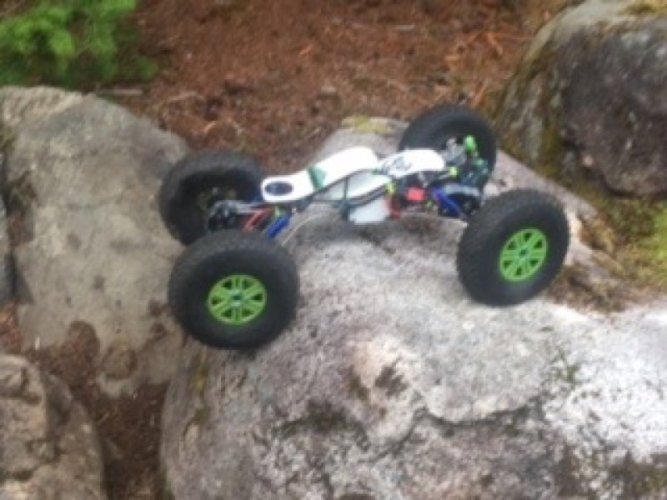

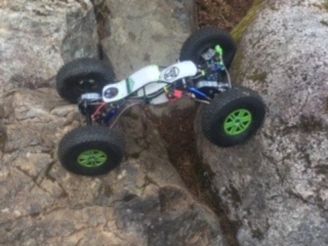

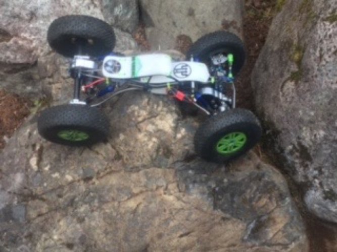

Been running Dlux SAF Low Ratio Berg gears in My Super Class Truck for some time now and love them.
Decided to install them in my 2.2 Pro Truck and what a deference in the
drive-ability they made.
This line was previously unmake-able
Drop in to the notch
Push the front part way up the face Then punch it and jump-up
To the top :mrgreen:
I never made this line Before installing the low ratio gears the tires would just spin and slide off the face and crash:oops:
