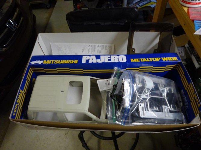

I've had a soft spot for the CC01 Metaltop Pajero for quite some time, but I was too busy on other builds last year to pick one up before they were discontinued. I almost picked up what was probably the lone remaining one from RPP last summer for a future build and kicked myself when someone else snatched it up.
Fast forward to just over a month ago, when I saw radishkid put his nearly complete build up for sale in the classifieds. Everything was completely assembled except for the shocks, brick mod done, and body was painted with base color coats. The price was right, so I pulled the trigger. He even sent the original box (call me crazy, but I like to keep mine). Thanks, radishkid!
As the thread title suggests, this one is going to be a fun tinker toy whenever I need/want a break from my more serious builds. Which explains why it sat on a shelf for a few weeks until I finally got around to getting it running over the past couple of weeks. I’ve been reading up on OSRC's awesome CC01 tips thread on UltimateRC and have now done enough that I thought it was a good time to share progress and my musings about future possibilities.
Here's what I started with:

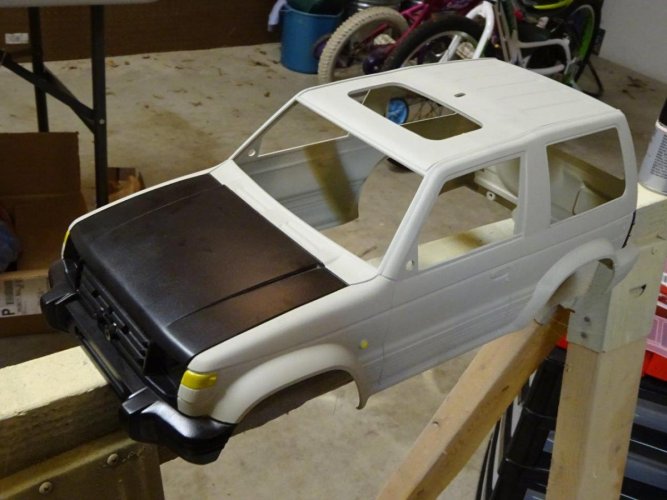

Body painted by radishkid:

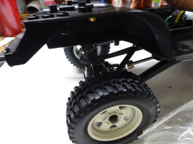

Much more betterer. For a rear shock mount, I tried a variation of OSRC’s mount fabbed from part of the stock link:
It seemed pretty trick, but the ride height is way too high in back:
:oops: I’m going to pick up one of the GPM adjustable shock mounts so I can play around with ride height a bit more.

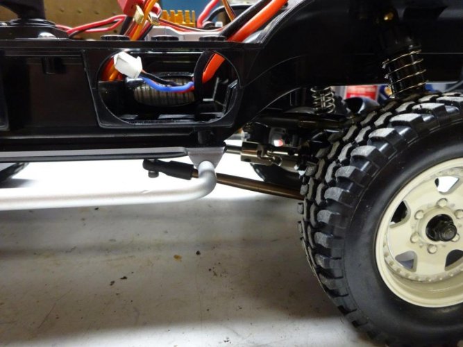

In the meantime, I swapped out the knuckles, c’s and lower arms up front for the GPM parts:
Since I’m not going for the blingy look, you'll see that I’m sticking with black and bare metal wherever possible.

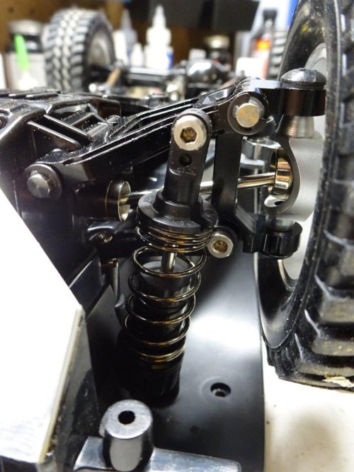

The last task up front was fitting the GPM steering rack. At first, steering was actually worse than stock. After playing around with a few things, I came up with the hypothesis that there wasn’t enough of the bell crank shaft exposed on either end of the ball bearings to allow the upper and lower crank arms to bite. So I decided to trim the chassis tube and white plastic bearing bushing a bit to leave a bit more exposed. I then added a metal spacer (either 1 or 2mm, can't remember) between the upper crank arm and the upper crank screw, with thread lock on both sides of the spacer (plus on the screw threads, of course) to try to keep things from slipping.
Here’s how it now looks:
Thus far, in garage floor testing, it’s much, much better than either stock or the GPM setup unmodified. I don’t know how well it will hold up to trail abuse, but we’ll see. I’ve ordered the Hot Racing steering setup as a backup plan B.

Thanks to both of you. I just ordered the Tamiya swing shafts, so those will be making an appearance before too long. Re the tires, I'm wondering how you're getting those tires to work without rubbing. I'm getting some rubbing up front with the stock tires, and they're only 3.35-3.4". I tried 1.55 Mud Thrashers (3.67"), and they were even worse. The other tires you mentioned are in the 3.7" range, as well. Are you raising the ride height to get more clearance? Or are you trimming the fenders a bit on the Pajero body? Or is there something else that can be done to help with the rubbing?
Thanks for the help...
I do trim the body, you can get a fair amount of clearance and still keep the stock look. This one is trimmed pretty good up front. I usually take quite a bit off the front bumper on the very botttom so when the tire swings side to side it has more clearance. Unless you are a Tamiya Expert, you'd never know by looking at it.
