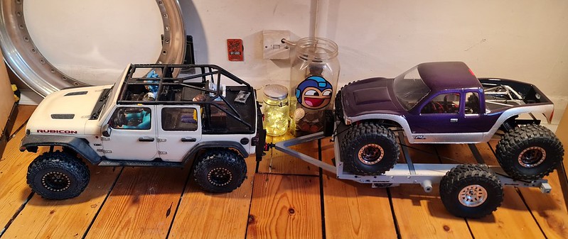

This was actually my first 1/10 scale build I did, but never documented it. Made from the kit, it went through a few iterations including 4.75 tires before settling on the 4.3's seen here, ran with the amazon dig gearbox before going back to stock as I found the weight balance was better. The top got chopped and passenger window was opened. I wish I didn't, but decided to paint the rollcage black and now everytime I come back from a run I'm touching up the cage :roll:
Current Spec:
Hobbywing 1080 ESC
Holmes Hobbies Cawlmaster 13T
That Amazon 35kg servo
Amazon Red servo winch
Brass Portal covers
Incision Portal overdrive gears and rear underdrive diff gears
Metal axles
Brass knuckles
CGRC high clearance steering link
Metal Panhard mount
Proline G8 4.3 Super Swamper on Cheap Method Beadlocks
Treal 8mm Brass Hexs
Rock lights
Club 5 racing illuminted licence plate surround
3D printed Items include
Yeti Cooler
Alcohol
Oil Can
Coke cans
Golden Gun
Ghetto blaster
Centre console with cupholders and levers
Rick & Morty passengers
3D items were sourced from thingyverse, including Rick and Morty, athough they were standing models. So I spent a bit of time making them sit, scaled and printed a few times until I got something that fitted.
OK so the legs ain't great, but they have some :ror:
I blacked out the lights top and bottom for a little more scale
