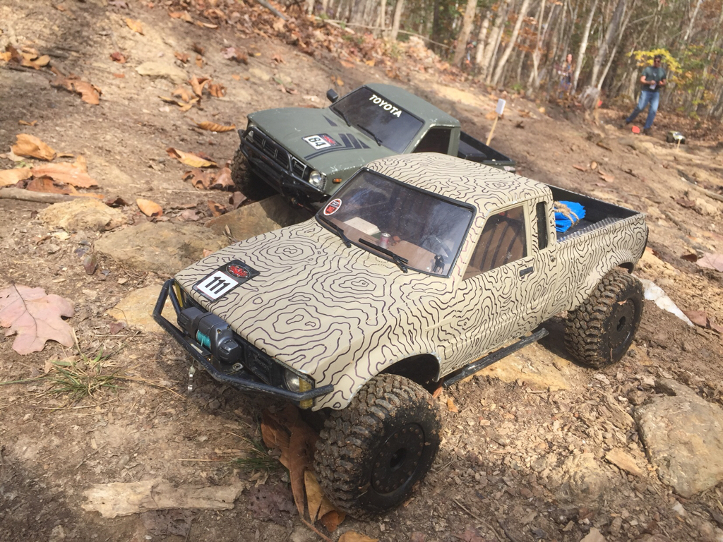

Team FU-Nominal had a strong showing. Wyatt hit only 1 or 2 gates all day and the Little Green Yota performed so much better than I expected.
Father & Son
Todd’s “Topo Yota”

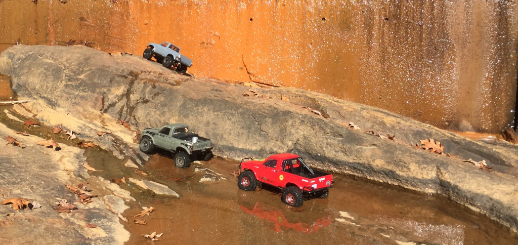

So the next week Todd, Terry and I hit Davos Dam.
Terry had just received his Marlin Crawler, so you know a full on leaf sprung assault was in order.
While the leg is up...
Leaf sprung flex shots?
I’m just here for the lulz...

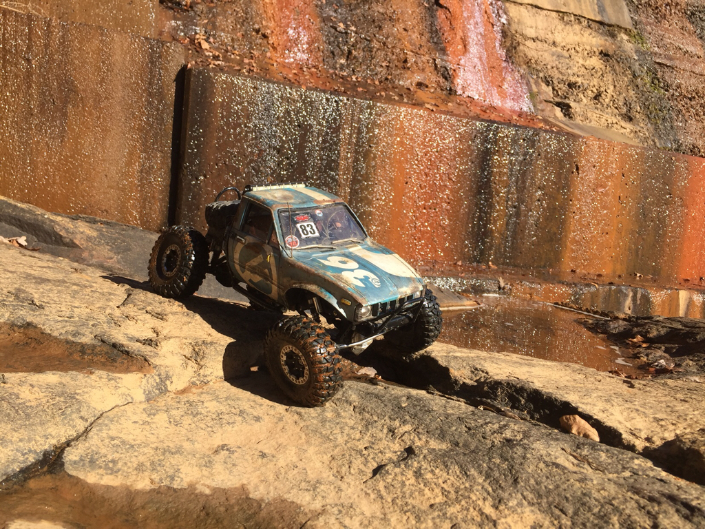

Anyway we decided to give Hell’s Gate a go. Hells Gate is a pretty challenging line and has two levels.
Honestly I don’t know if anyone els has ever tried it with a hardbody, leaf spring truck before...
How about a stock Marlin Crawler?
Todd and Terry made it up.
Yes, I made it up.
(Terry is very trusting)
How about the Little Green Yota?
Yes sir.

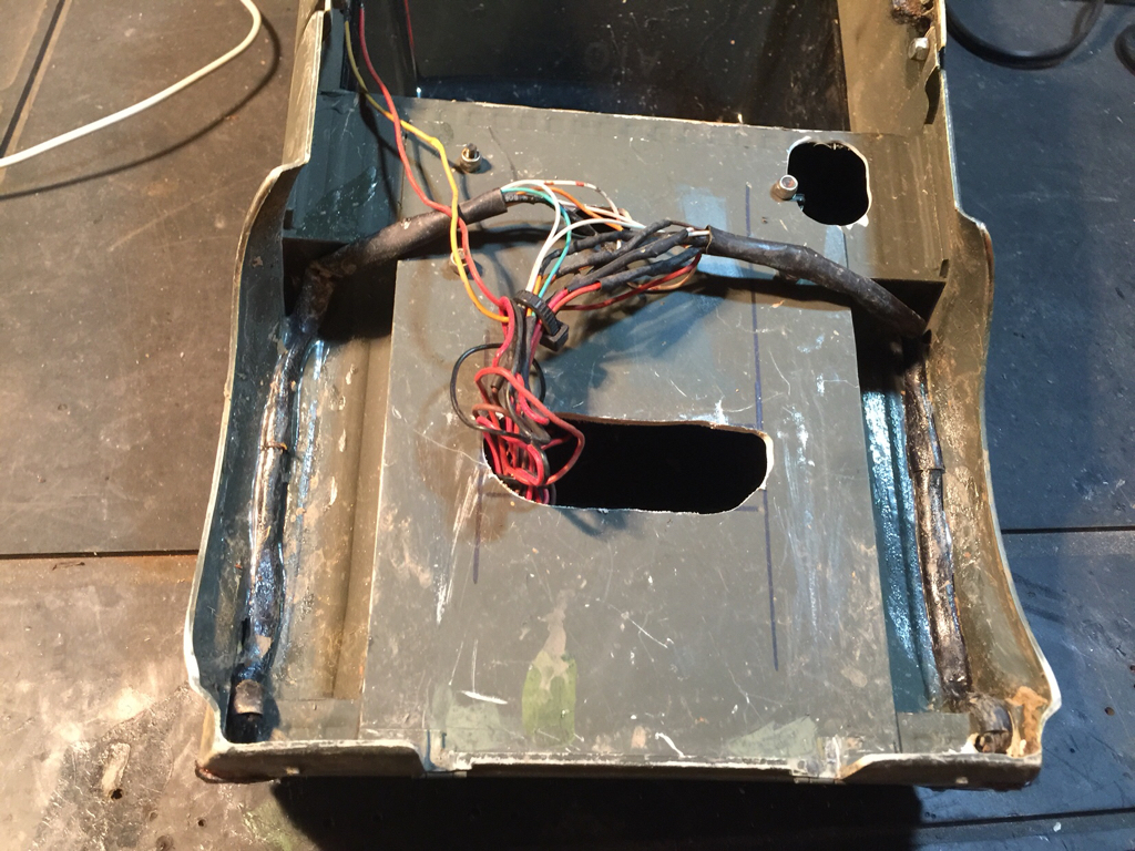

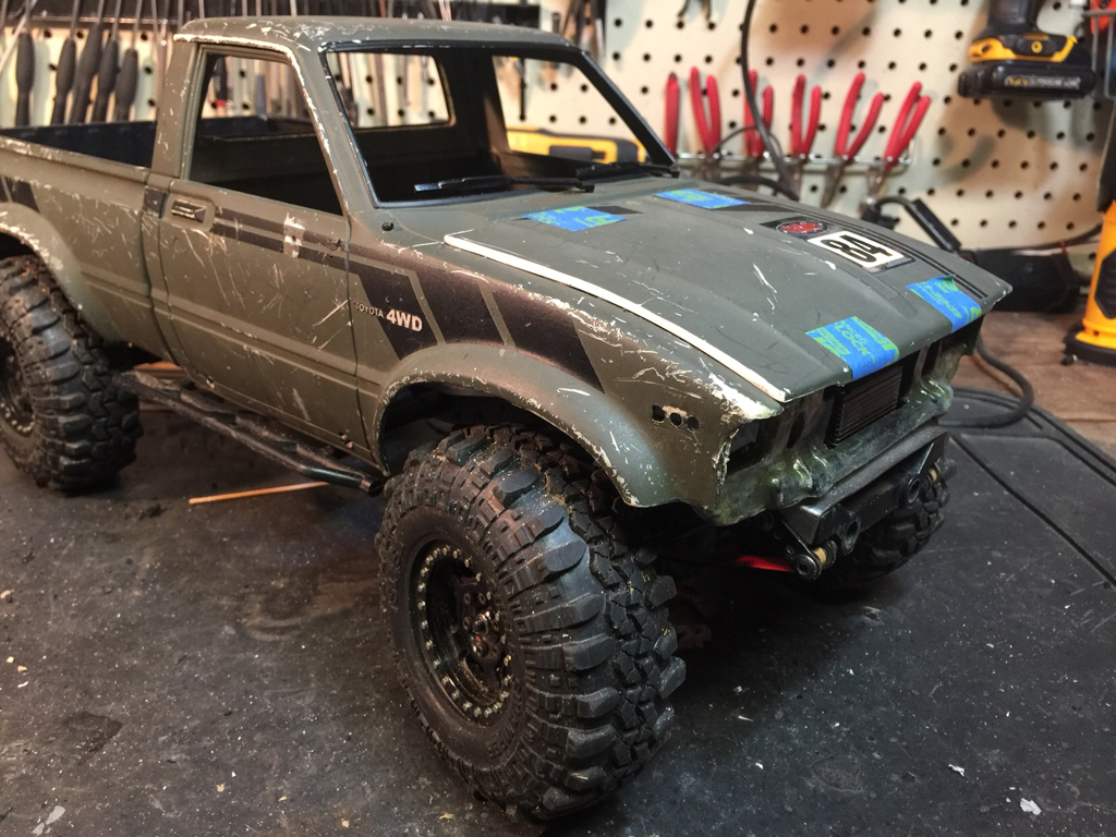

First let’s see what we’re working with.
Body is pretty beat up, with plenty of battle scars.
Love these TRD decals, and the Toyota 4wd emblems on the side (not hilux). Those have to stay.
I’m thinking I’ll just weather and layer the paint, keeping the soul intact.

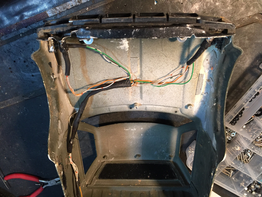

Wiring is obviously legit, so yeah.

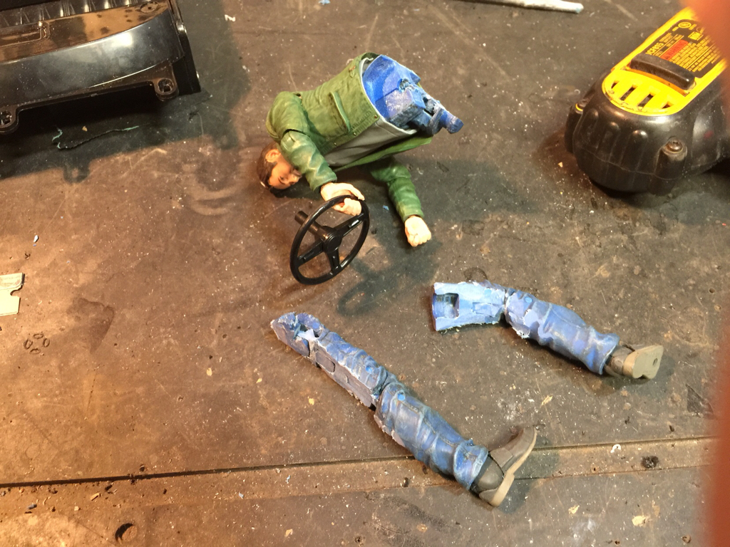

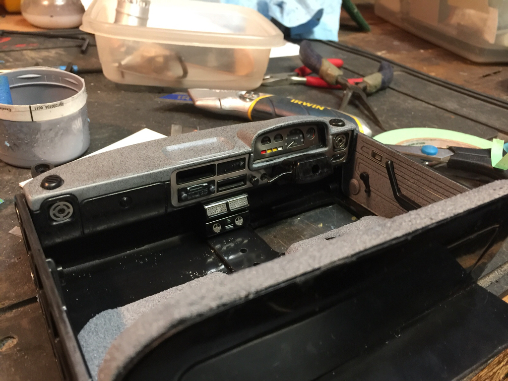

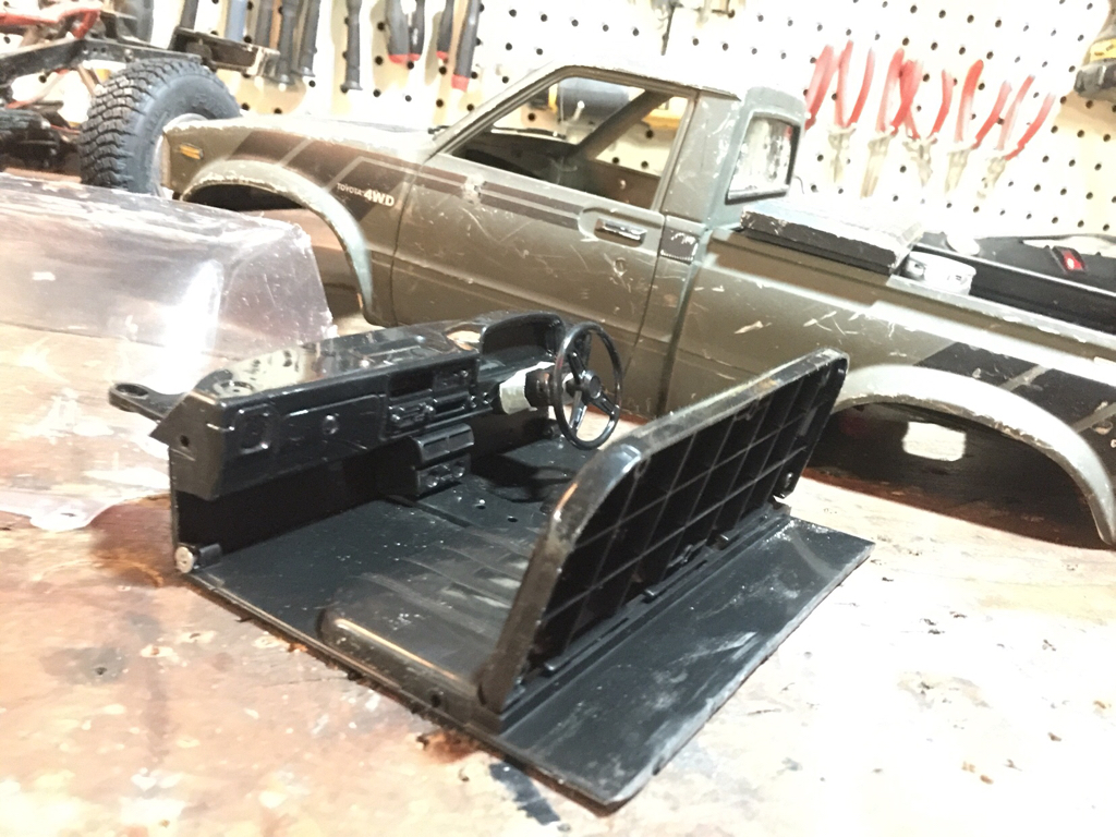

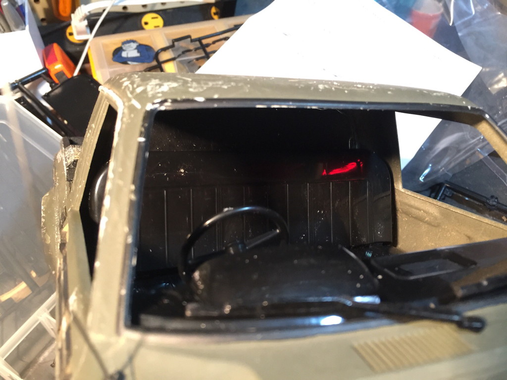

Soooo interior....
Ummmmm
I need foot room.
aaaahhhhhhh
Not a bad start.

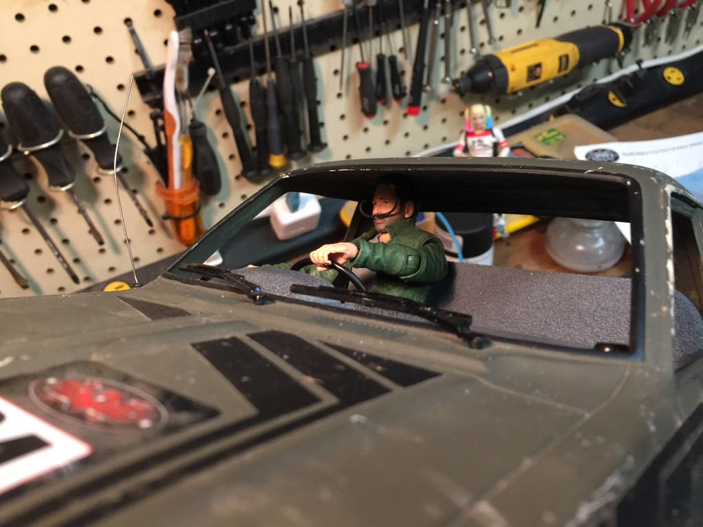

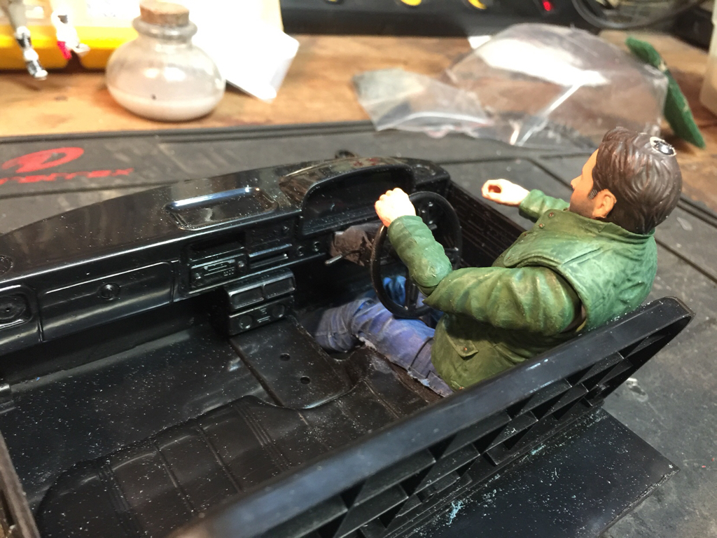

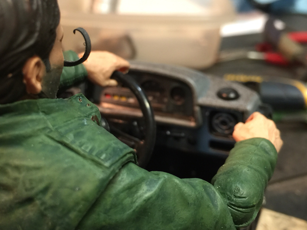

Bring it together.

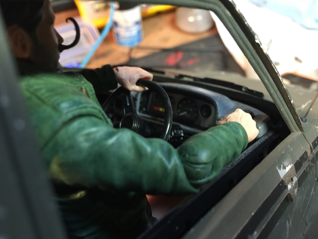

Yes sir, he fits.
I really dig the detail of this interior. Again, best $40 EVER.
So the interior is pretty much done until I go for final instal and weathering.

The last interior I made took forever and was mostly done from scratch, based off of a bruiser seat/dash.
Love that interior, but it took me months to complete. Worth it? Sure. But I’d have rather started from this 4 door interior.

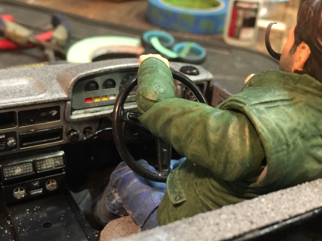

The one for the Little Green Yota took me a week or so, working slowly and having a few beers.
Took me longer to get the driver to fit properly than any other part of it.

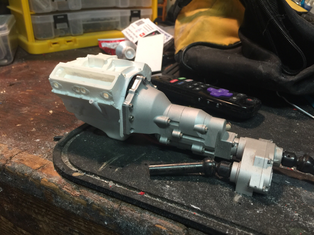

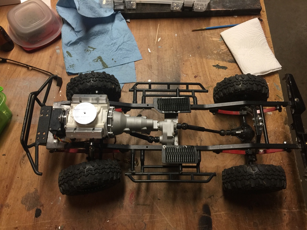

Little update: Driveline
The combo is working well, so I’m not gonna change much. I’ll mock up the driveline, then once it’s good, break it down.
Next I’ll waterproof all the electronics, paint and assemble.
But first...

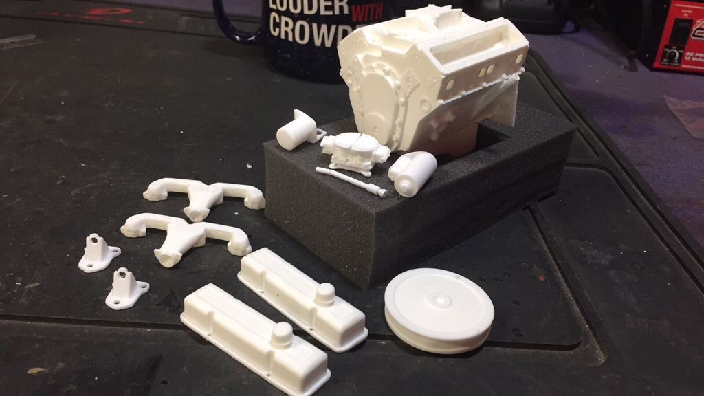

It’s not a Hemi, but it’ll do.
I’m pretty excited actually.

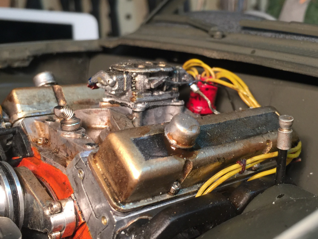

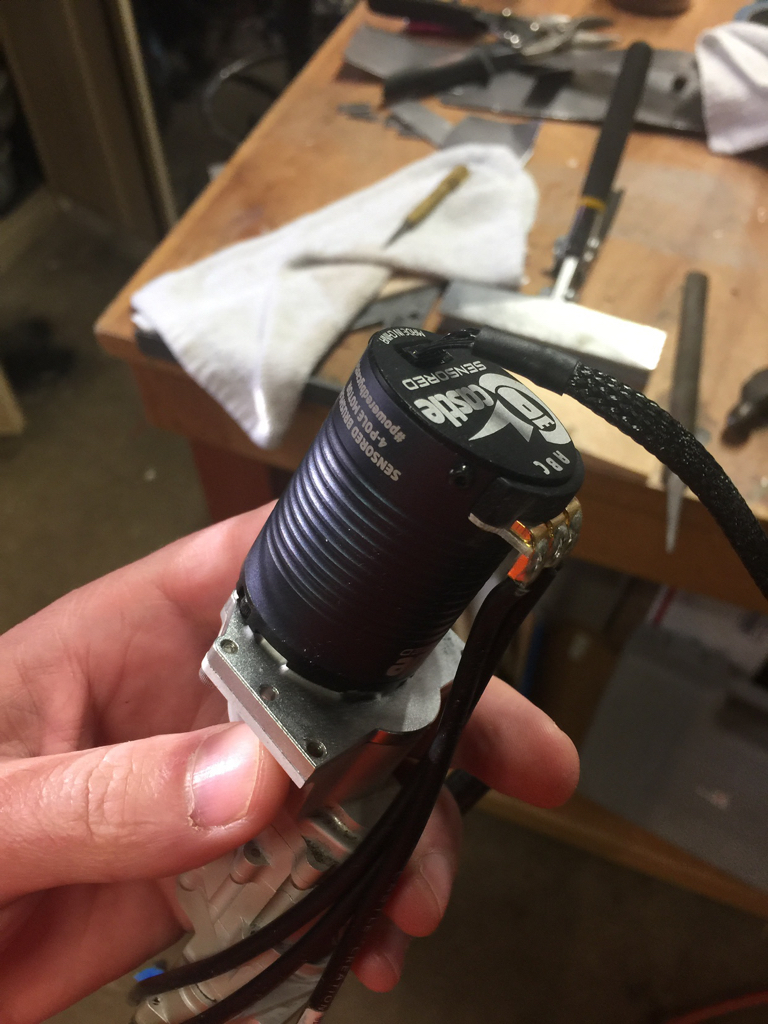

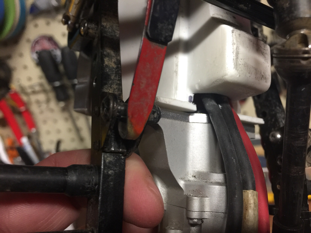

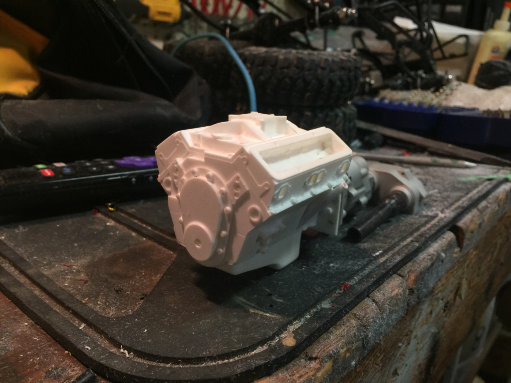

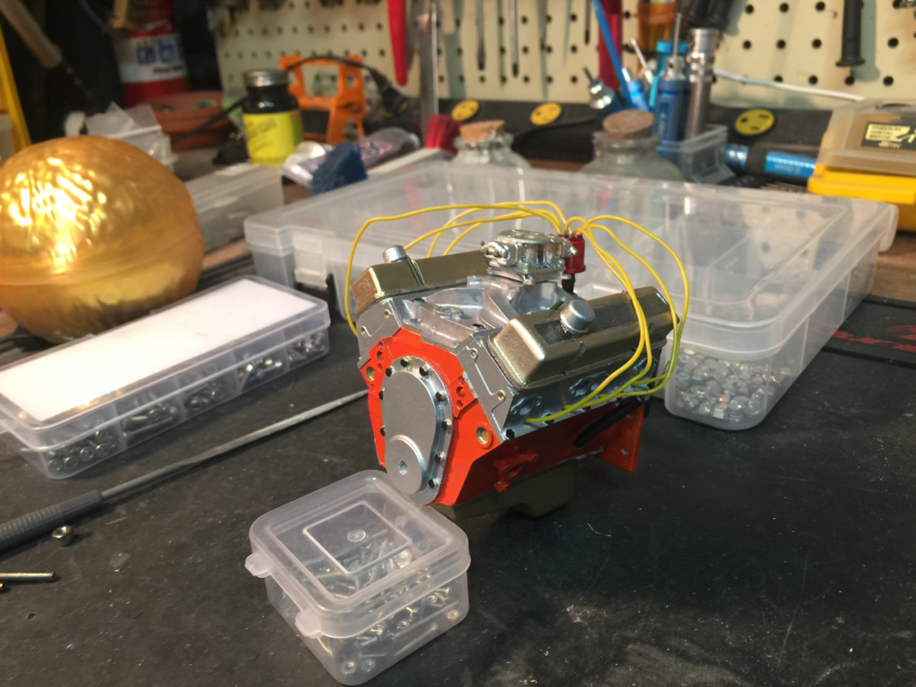

After making some dust, I was able to stuff the Tekin brushless can in the cast V8.
Tasty.
I ran the wires out the back of the oil pan. I think I can keep them pretty much out of view.
I still need to test fit the sensor wire, but I have plenty of space.

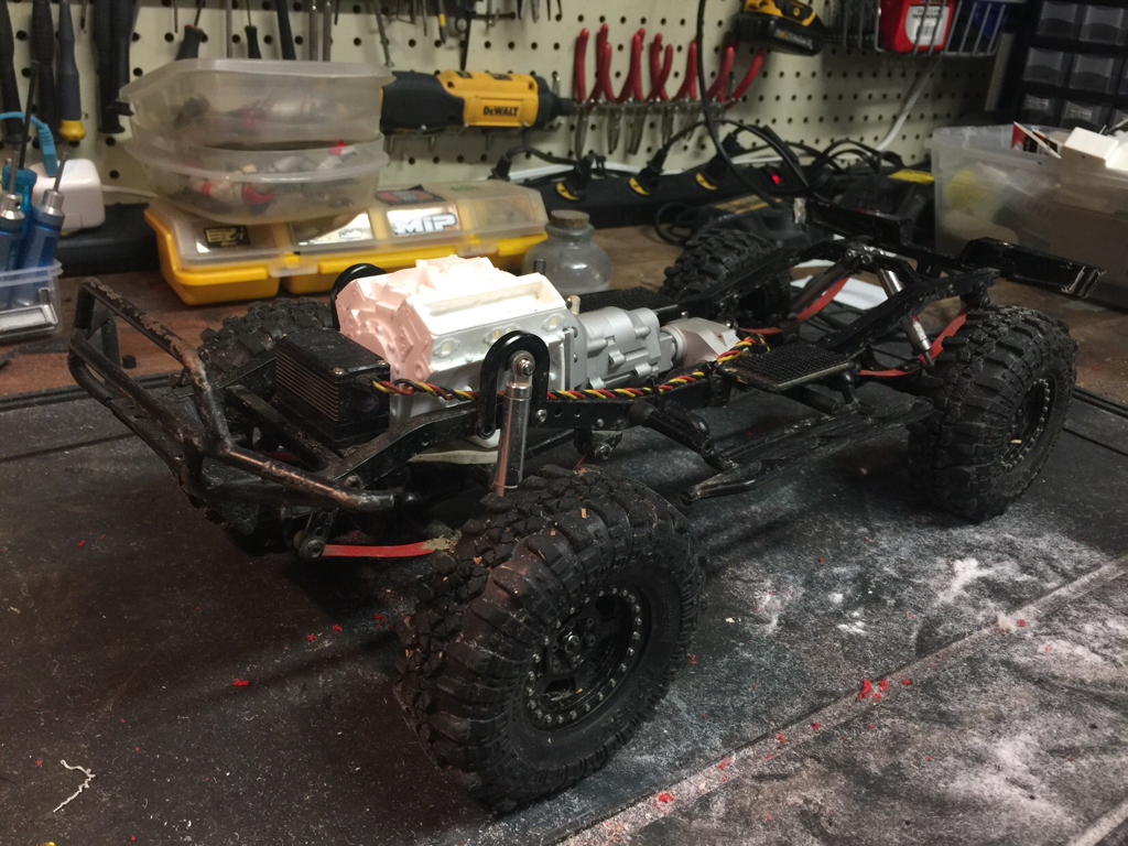

I needed to start mocking things up.
It’s not gonna leave much room for the motor, or any scale goodness.... also the motor is sitting pretty far back. hmmm....
Seems we’re gonna have some clearance issues. LOL

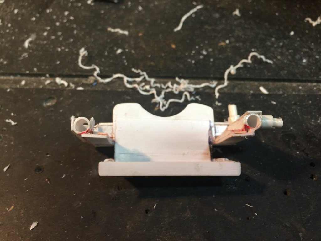

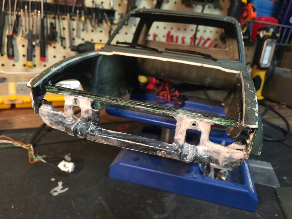

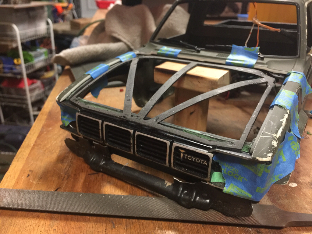

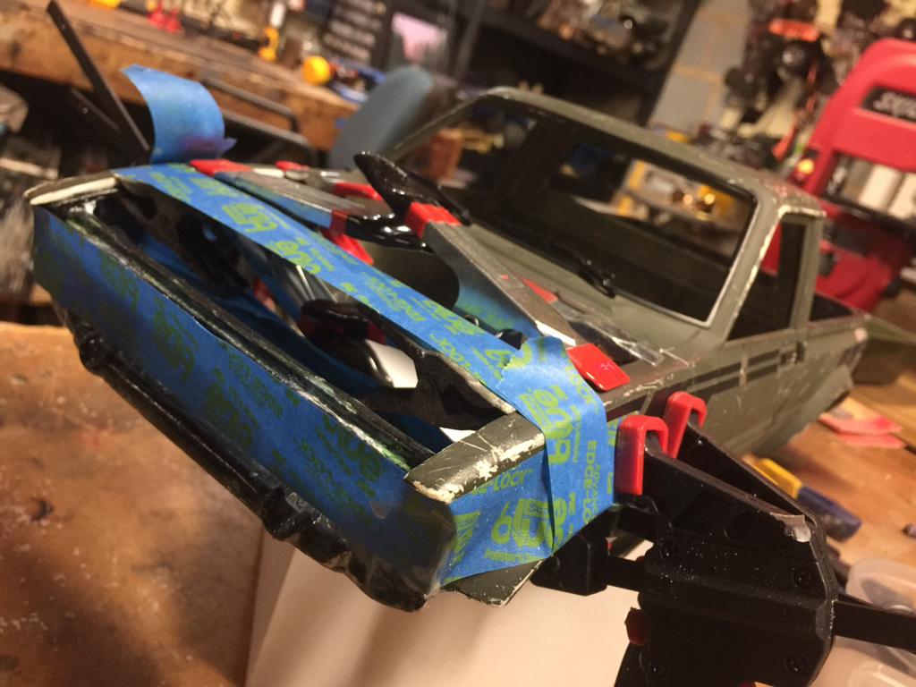

I got busy, and decided to mill a groove into the upper radiator support like the 1:1.
Little mock up:
The fit is nice, especially for non-production parts. I of course cleaned these up further, just because it’s what I do.
I also removed some of the supports for the hood frame.
Time to make it permanent:

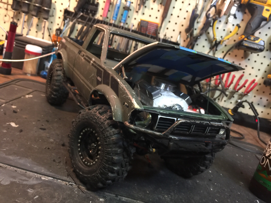

— UPDATE —

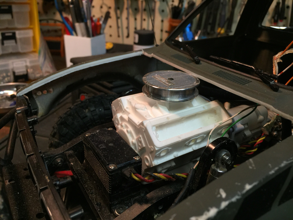

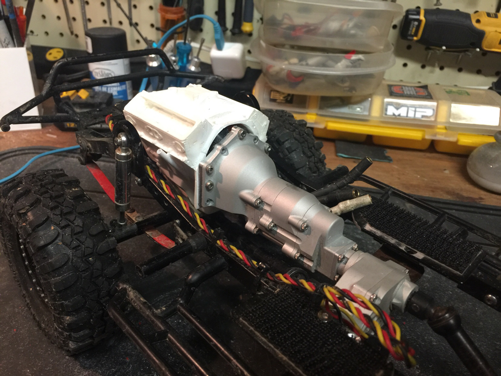

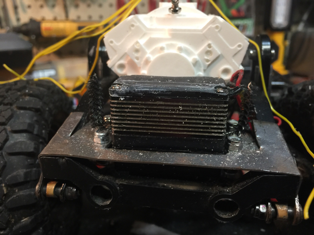

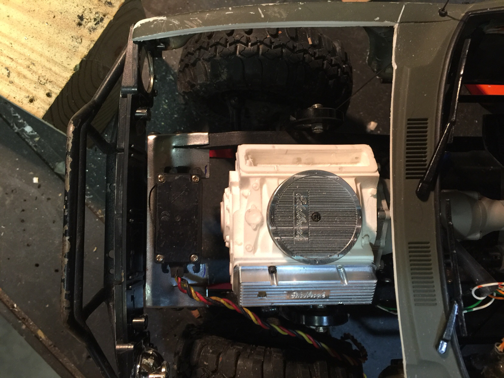

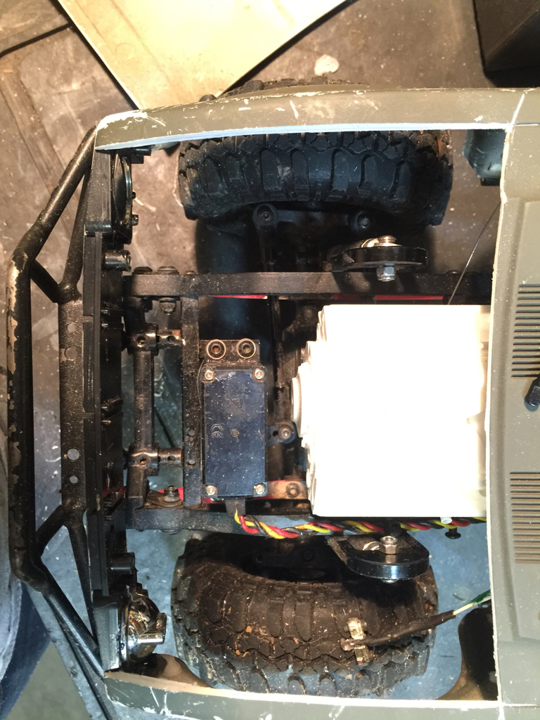

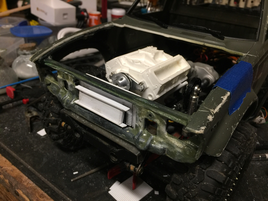

Ok here’s a bit more on the engine placement... originally, the motor was just sitting way to far back because of the servo’s position:
No pulleys, the motor is in the firewall. It just wasn’t gonna work.
I needed the servo moved up, as well as the motor, like this:
So I made a sheet metal servo mount which moved the servo as far forward as it could go while still being behind the radiator support.
Mounting the servo on the underside, along with a little shaping of the top of the servo allowed me to fit the pulley kit on as well as get the small block into the correct position.
A little radiator and trans cooler to hide the servo....
The radiator mounts on airbrush cleaning brushes, which fit snugly inside of styrene tubing on the sides of the radiator.
Much more to come, I promise I’ll keep plugging away until I’ve caught y’all up.

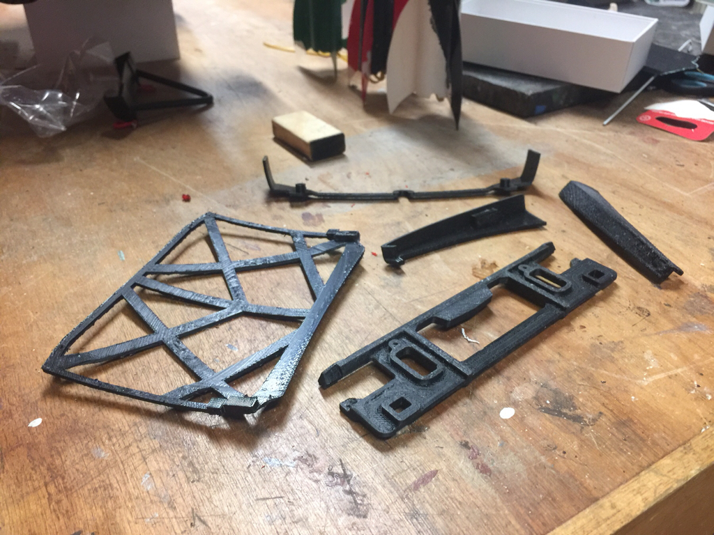

— UPDATE —

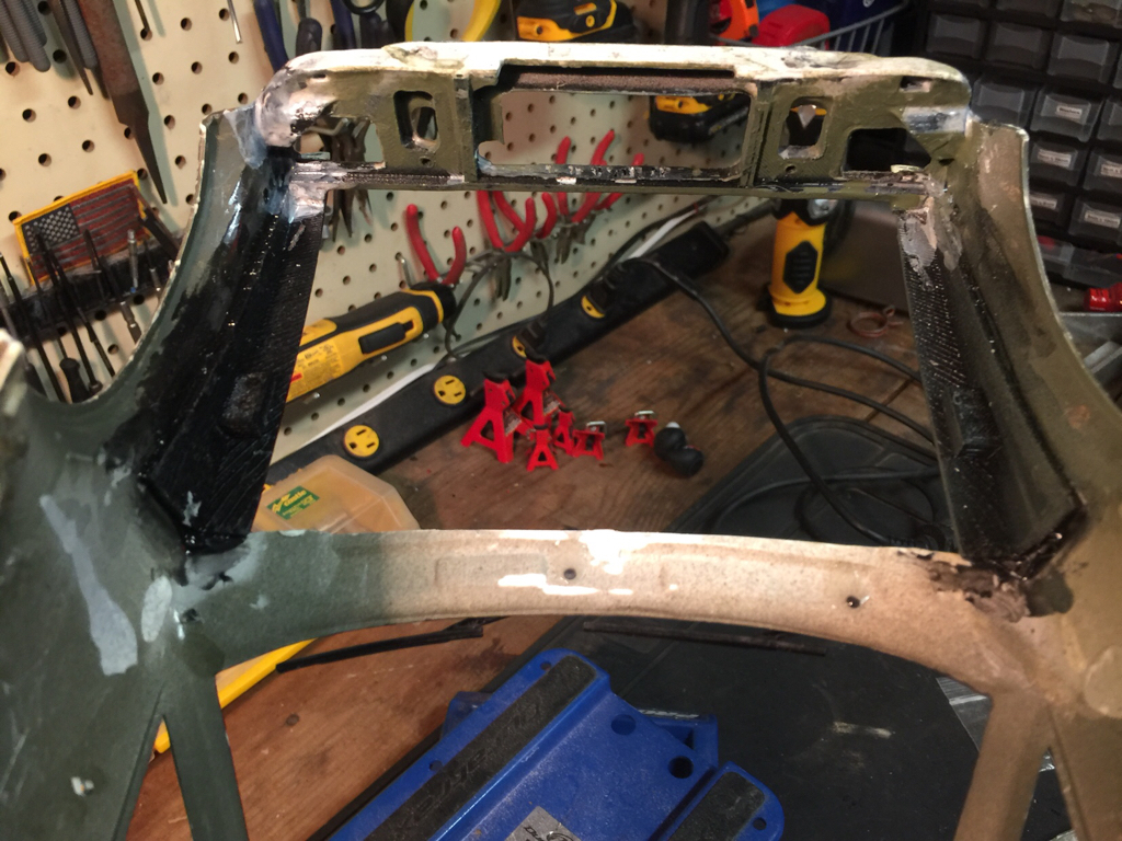

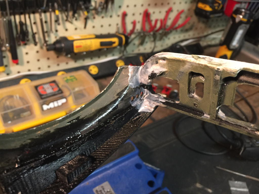

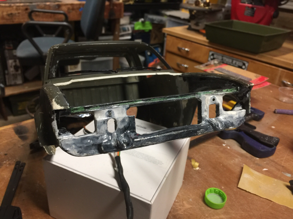

Ok here’s a rundown of the radiator support. The Bowhouse hood hinge kit is designed for use with the Mojave grille and is a perfect fit for it.
However as this truck has almost nothing on it which is in the stock location, and will be using a chopped down version of the Tamiya grille. So some modifications were necessary.
I’m a big fan of the look of N00b’s radiator support, especially under a cut down grille. So I’m decided to combine the two.
The Bowhouse part is nice and beefy. Plenty strong so I chopped off the top of the N00b support and grafted the bottom to the Bowhouse part. (I used MEK Substitute). I then began to fill in the rest with MEK goop (styrene and MEK goo)
It’s a start.
Next was to fix it into place permanently.
No it’s not pretty, but it’s strong and looks pretty good from the front. (Yes I see the hanger on the side. I’ll get there.)
I threw a little color on it and dropped it in for fitment. Not bad.
Here is how the radiator support ended up. Photo cropped to keep a little mystery....

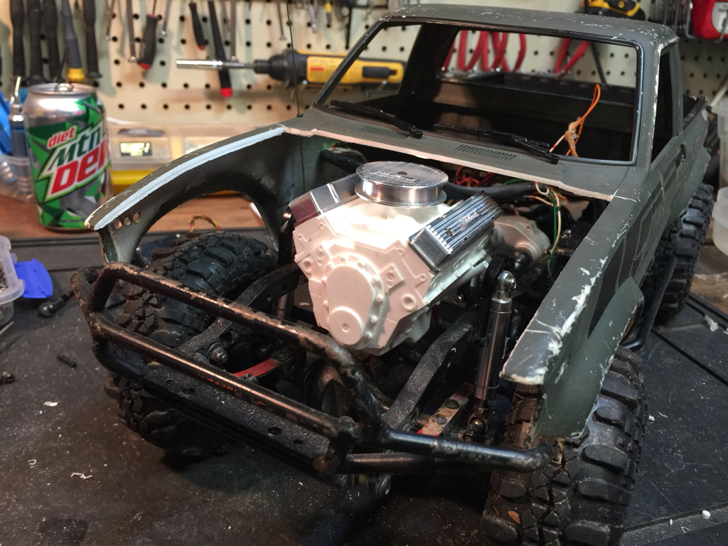

Alrighty before I sneak off to the shop, I should post another update. Let’s take a closer look at the hood and the bowhouse kit.
When we last left off I had the radiator support in place, as well as the side pieces for the hood hinge kit. I decided to go ahead and mock up the hood.
This version of the kit uses the RC4WD blazer hinges.
Everything would have gone together perfectly, but I have things shoved around, so I moved the hinges forward a bit. Easy enough.

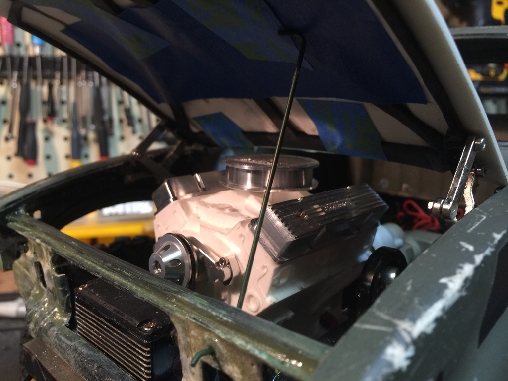

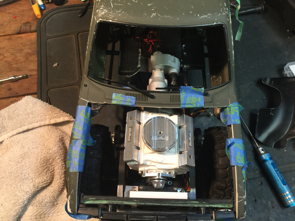

<french photographer voice>
Oh that’s so nice. Show me your V8....
OOOO-LA-LA
Now show me with your grille... does it fit?
Yes. Yes it still fits.
Ok. Ok. Now you’re a shy little Yota... hide your V8, close your hood
No no no
Close it all the way.
What do you mean you can’t?
Oh that nasty small block is too tall for your hood to shut!
Huh, let me see...
Yes, that will do it. <\french photographer voice>
Lol

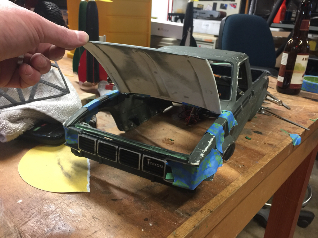

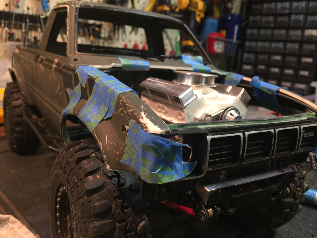

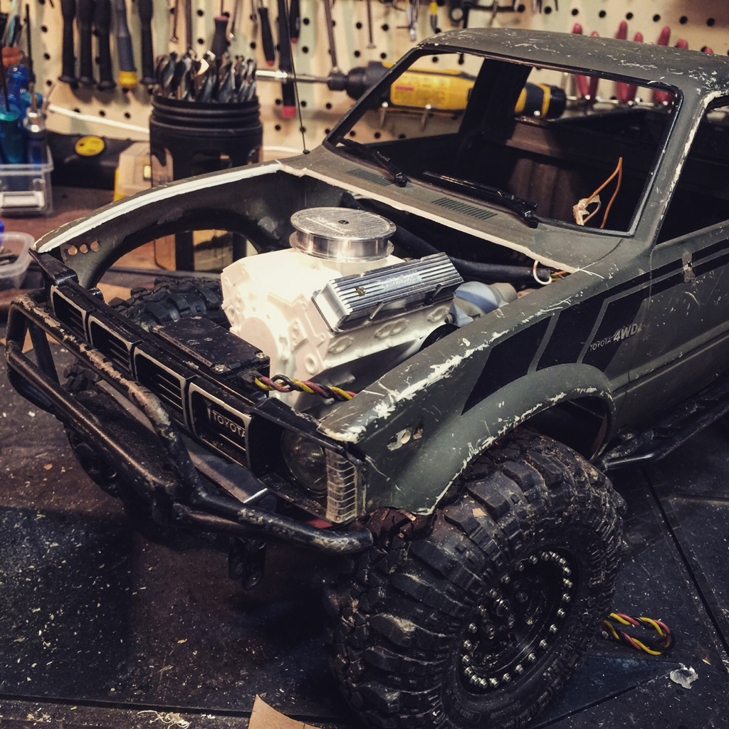

So as usual, I’ve made the motor too big for the hood to fit. The Bowhouse kit is great, this is all my fault.
So for now, until I figure out exactly how I want to modify the hood, I’ll go without it. I think I’m gonna take this truck on a journey as if it’s a barn find which is undergoing a resto, in stages.
So for now, I’m up to no hood.

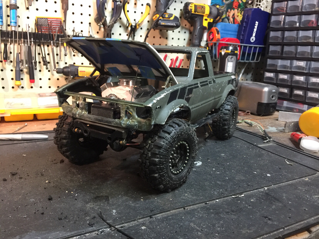

Sorry it’s been awhile...
Some pics of the progress....
