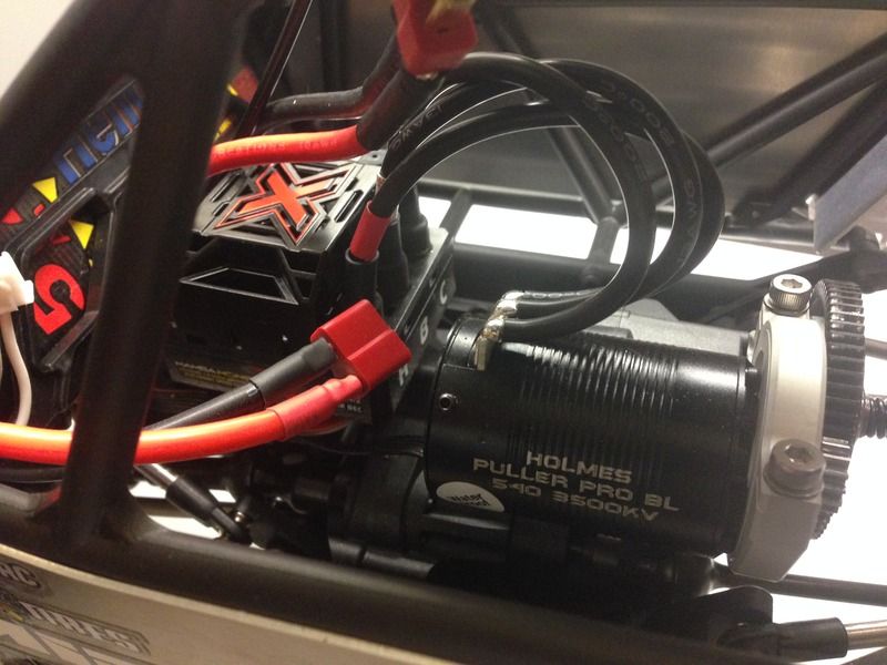

My Castle MMX is waiting to be paired with a HH Puller Pro 540 3500kv enroute to me as I type. Stock trans/gears for now with a Robinson slipper and VP motor mount. All that transferring power with MIP drive shafts. Outside of that, I did some "dress up" with some aluminum panels to start, RC4WD fuel cell and soon to come, a DMG spare mount. For 2 months I've been staring at this rig (after a very short stock test run) waiting to run it again and she's almost there...

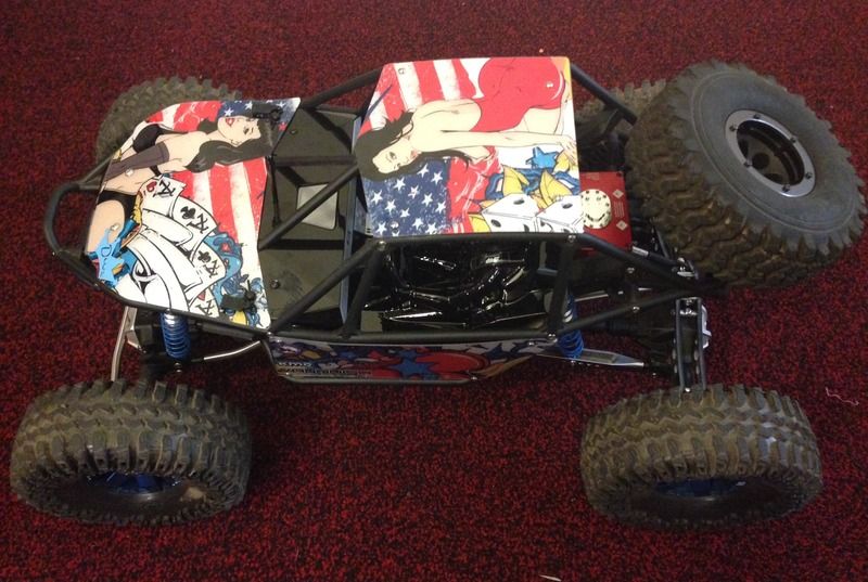

So this one (was not planned) was supposed to be just a "basic, stock" rig. Leave it to a woman to start "shopping"! The first addition (was actually started before the second Bomber was even purchased) was the custom panels from Krawler Konceptz. Which I have to thank Michelle for an amazing job! New "shoes" (do I really need to explain this one?) were obviously a must for her. The new VP Rockstars were an easy pick wrapped in RC4WD Iroks. I kept things simple with Incision SS links and a set of Supershafty trailing arms (in the mail as we speak). VP Stage 1 in red, Incision axles and Dlux axle trusses rounded the rest of the upgrades out. I still haven't decided if I'm going to run the front truss yet (I need to let her drive it first). Everything else has remained stock with the exception of swapping out the AE-5 ESC for my preferred AE-2. Both rigs are running Castle Bec's set to 7.4v for the Solar D772 servos. That's one thing I can't pull the trigger on! I've had great luck with these servos over the years and I just can't beat the price! Anyways, again a couple more dress up items for her and she'll be good to go..."thumbsup"

I finally got my motor and ESC wired up, installed and started playing with the programming. The Castle MMX auxiliary function is awesome! I'm so glad I listened to 84yoda on this one "thumbsup"

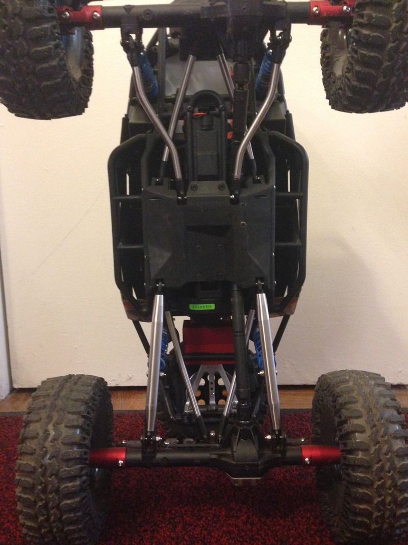

So I finally received the last of the parts for my "Hers" Bomber. The SuperShafty trailing arms are a perfect fit and finish! I added the DMG spare mount which will help with rear clearance (and IMO, looks much better) and the RC4WD fuel cell which has been a pain to find in the last month or so.
The good news is, the wife loves it and even snuck it out while I was at work and ran through a 3s pack! Bad news is, the "His" Bomber (mine) is down at the moment. Blew up my servo (Solar D772) last weekend while testing the MMX settings! I see a HH servo in my near future. Btw, on 3s 5200mah and 14t/64t gears with standard HD gears... Bitchin! "thumbsup"
Just looking at the bottom of "hers", you may want to make sure there's no binding in that rear driveline as the suspension compresses. It looks like it's bottomed out now. This will cause problems with the drivetrain and something will have to give in a bad way. HTH
Good call on that one Screamer. I didn't notice that before. I was more concerned with the clearance around the drive shaft but when I compressed the suspension on the bench I noticed the binding. I'll have to swap out one of the outer shafts for a shorter one. Thanks!
