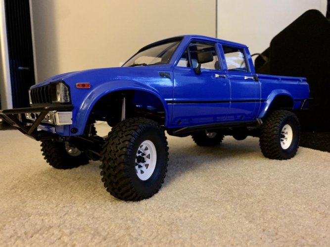

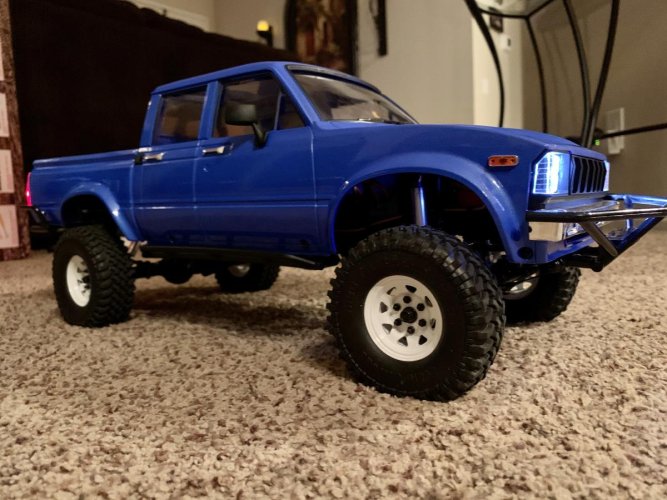

Well I got my tf2 lwb rtr and I must say it’s pretty cool. I shimmed the rear diff the front was ok lubed everything, blue lock tight on everything. I replaced the front shock hoops with the Gelande 2 hoops moved the hoops back to give it a bit more steering. Removed the internal springs removed the smallest leaf and put it on top of the pack to keep the leafs from spring wrap. Swapped out the stock servo. Waiting on steel front and rear bumpers and the front reverse Shackle Mount. 9625DBAE-5509-4684-8F98-741529C2AE97.jpg

Congrats on getting the TF2!"thumbsup"
These are cool rigs and can be made to perform well! Check out my Marlin thread here:http://www.rccrawler.com/forum/rc4wd-trail-finder-2/607692-b-mow-buys-tf2-marlin-crawler.html to see what all I had to do to make great!
You should start a build thread so we can follow along with the build progress.
Looking forward to seeing pics and videos!:)
