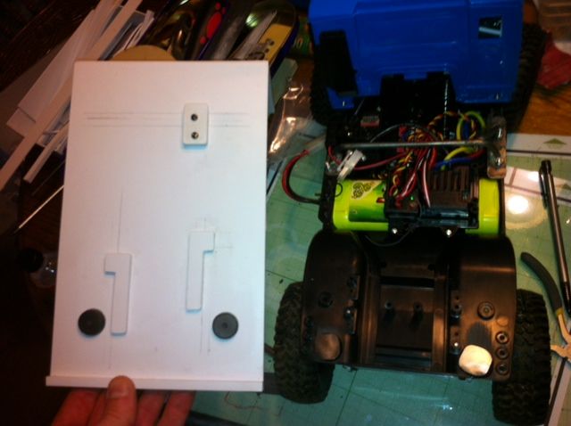

First off, I sorted out the mounting for the bed. Using my new found love of brazing, I made up a cross member over the electronics, which bolts to the edge flanges on the chassis. Made a little catch that slides under the bar for up down and forward location at the front. At the rear, I made two L shaped pieces that locate off the shock bosses, for cross car and rear location. Couple of magnets to hold the back down. Really the only thing I might need is cross car location at the front mount, but I may leave that for now.

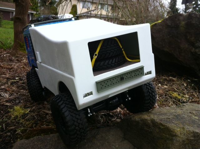

Finally, I doubled up the rear floor, recessed the 1/2 spare into it, and tied down the spares. Doesn't look like much in the plan view, but visually I think it'll make a difference when viewed through the rear hatch.

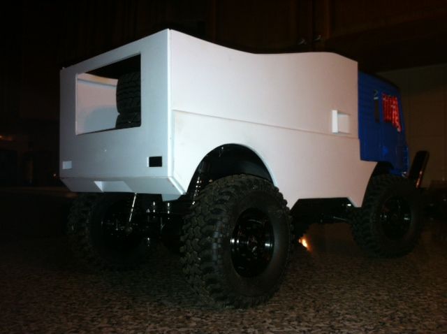

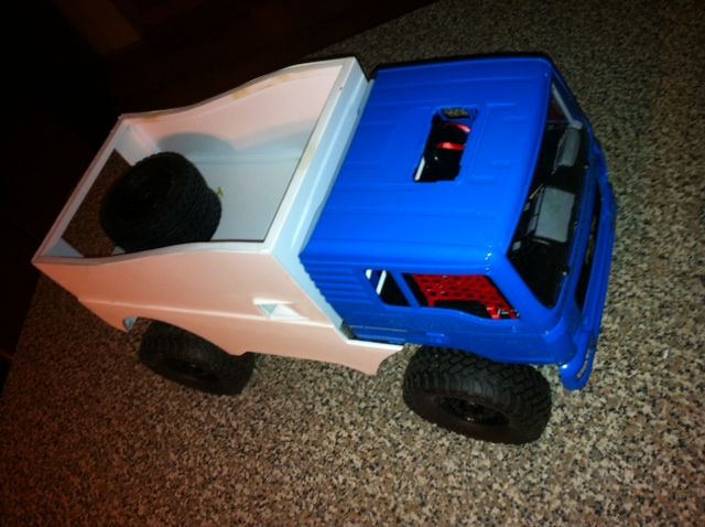

I finally plucked up courage and started framing up the rear body. Overall, I am very happy with it. I screwed up by not accounting for material thicknesses in a few places, but nothing that isn't fixable.
I was also getting really mixed results with bonding, some places the plastic would liquify and make a fantastic bond, other places it seemed to glaze over and just form a 'stick' bond. After every joint was made I went round and inspected as best I could, hit with more glue as needed and shimmed with shavings, so I am fairly confident it'll stay together - certainly feels nicely robust right now, but I guess time will tell!
I have a lot of sanding to do!
It's very cool to see it all together without being held together by tape.

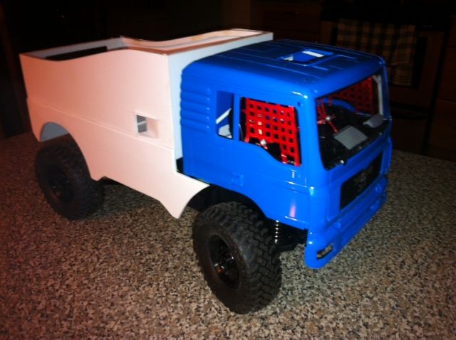

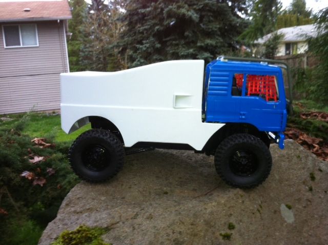

Been a while since I posted updates, but rest assured i haven't forgotten my little truck. I've been doing a lot of little, time consuming stuff that doesn't seem to make a big difference, and then suddenly ... it looks like a complete truck!
So here it is ...
Repositioned the cab a couple of mm, and added a third mounting point. Painted the inside of the rear body, put the roof on and started the seemingly unending task of sanding. Got some Axial lights, added a mount bar under my cage, an extra cross beam on top , made some seats and mounted it up. Made up an extra support for the front grill, so it doesn't fall off every time I look at it.
It's coming together ... time to start thinking about paint ... :shock:

Forgot a rear shot yesterday ...

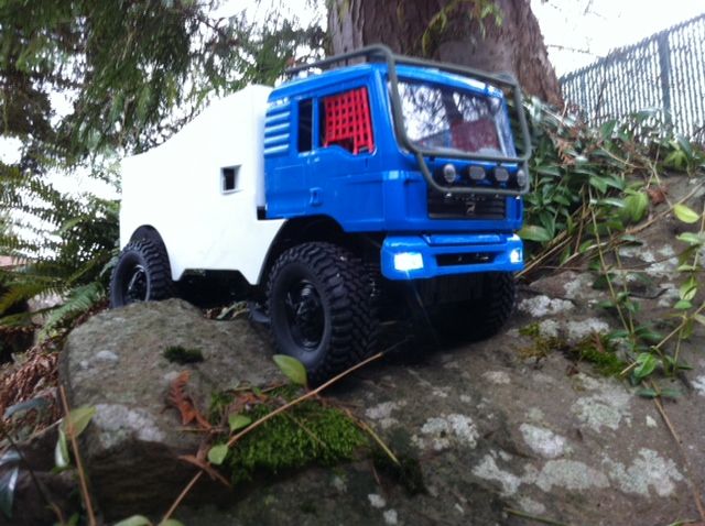

I took it for it's first trail ride yesterday ... looks good with some mud on it!
Overall I was very happy, didn't do anything too technical, just bashed along some footpaths, but it worked very well. Going to need to do something a little more robust to hold down the spare tyres ... and maybe something else to hold down the rear body. Over jumps you could hear it jumping around on the magnets.

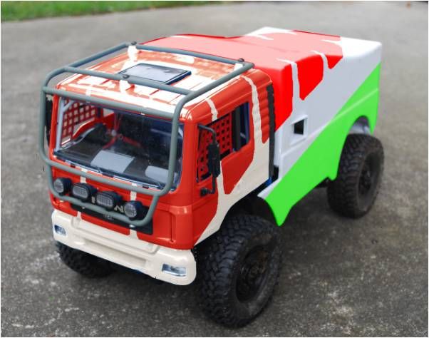

This is my inspiration for paint, by the way ... Kawasaki France Racing from back in the day. This is me doing my best Terry Rymer impression about 20 years ago! I'm trying to figure out a scheme that doesn't look too fussy or too bland, but that I stand a chance of pulling off with my meager skills and zero experience.
Looks pretty cool, are you going to actually paint the white areas with a gloss finish paint? Will look much better than just two colours over bare styrene. I've always been a fan of the blue trucks like Red Bull, Gaulioses or KAMAZ.
I like the paint scheme. I think some black in there somewhere would add to it. Maybe a stripe separating the Green and White the same way the red stripe does/did on the nose of your bike.
