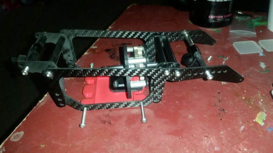

Next I built the Dlux hamburger Trans with his saf gears. Pretty straight forward. The gears come super close the metal spacers. I grinded them down a little to make more clearance. Mounted the Trans facing forward first but the motor was hitting the frame, so I noticed Tobias had a little notch taken out on the other side so figured that's where he had the motor. Turned the Trans around and the motor fit perfect. I grinded the notch down evenly on both sides so you couldn't even tell anything happened. I was only able to use two bolts. Put them pretty tight and seems to be pretty sturdy. I might tap a hole in the bottom of the Trans mount for another screw just to make sure it doesn't twist from Motor torque

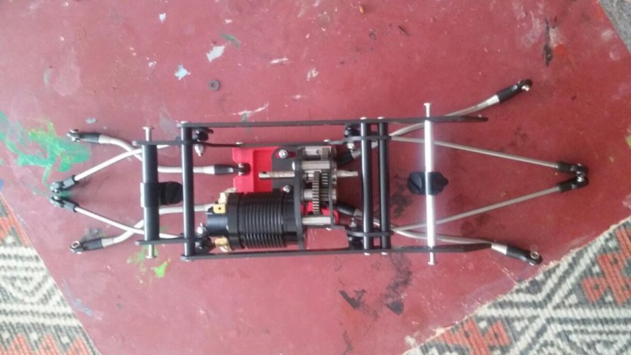

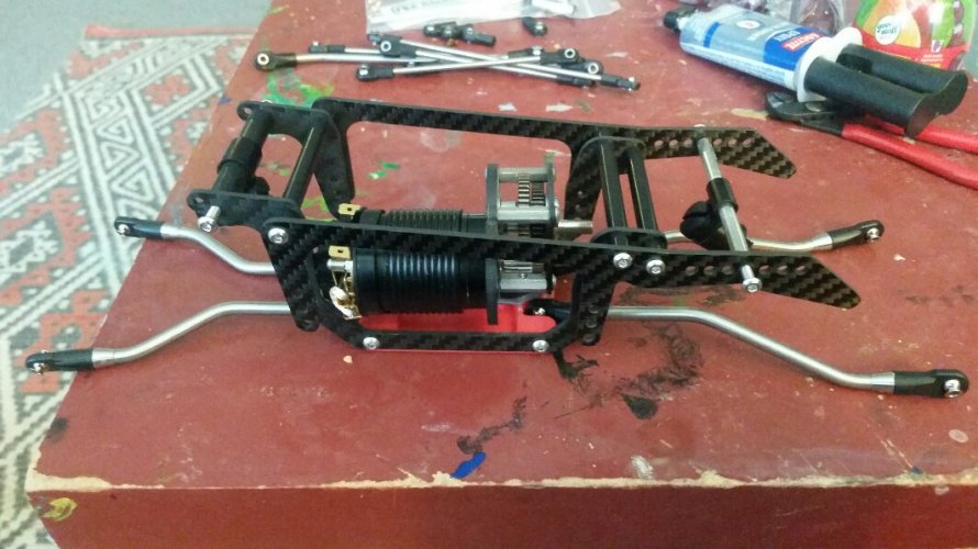

Got some parts in from Dlux today and did a little work. Need to go to the hobby shop tomorrow and get some bolts so I can bolt on the top links to the chassis. Going to try and finish the front axle tomorrow. Still have to drill all the wholes for the tubes and knuckles. But did get to mount the ti sliders on the links, mount the lower links to the chassis and also mount the motor. In the pics with the close up of the skid you can see part of the Trans mount in the space where the link mounts to. The link mounted fine but didn't move freely. So I slid the Trans as forward as possible then grinded away the part of the skid that was in the way. After that it was perfect.

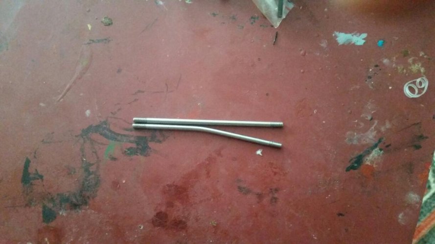

So haven't posted in a few days have been working on the Dlux berg axles for my Sudu mod. But this morning I mounted the top links. I had a problem with the links not being able to get close together to mount on the axles. They rod ends were touching the chassis. So I had three options, 1 I could use a bent rod end which I don't have and didn't feel like finding 4 of them, 2 shaving the chassis down a little to have the rod end not hit but didn't feel like modifying the chassis, and 3 bending the ti links which I ended up doing. I had a bender from harbor freight. I testes it on a steel link I had and bent easy enough. Tried the ti link bent it a little and released and it went back to straight. So when I bent the links I had to go a little further with the bend so when I took pressure off it would straighten out a little. Worked out perfect tho

I clamp Ti links in a vise and hit them with a hammer to bend them. For links i clamp them in pairs and hit one at a time. Sounds barbaric but it gets the job done. :lol: The quick impact gets them moving where a slow steady bend is tedious and as you've found has lots of spring back.
Yes definitely had a lot of bend back. I Def need to get a vise. Winnerone23 just told me he uses a vise also. I live in an apartment so have very little room haha
Slight bends
