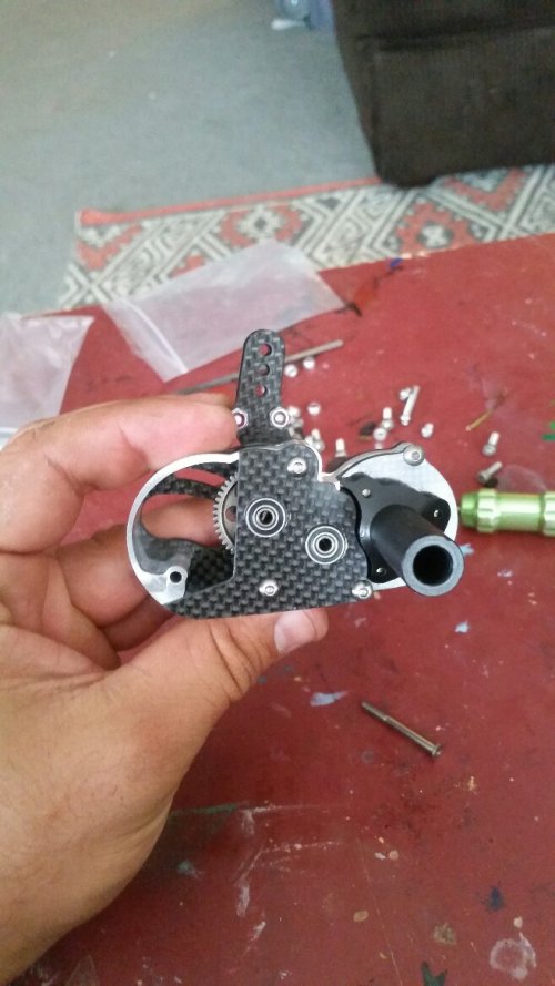

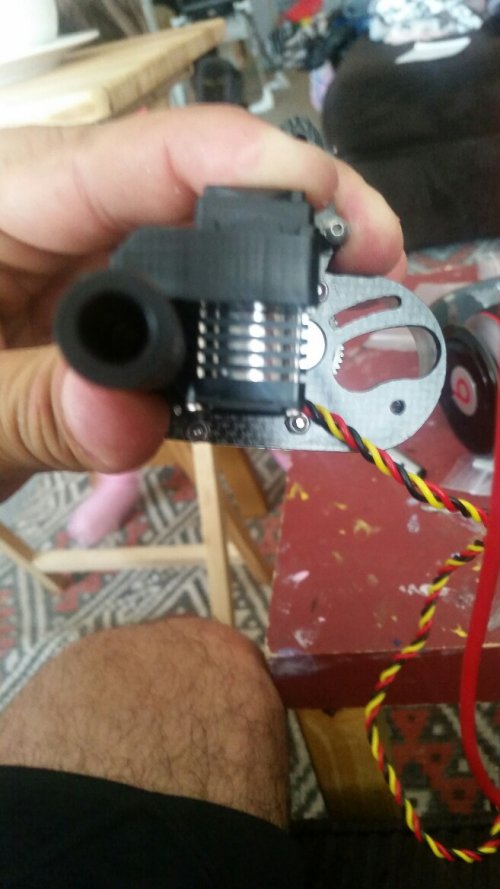

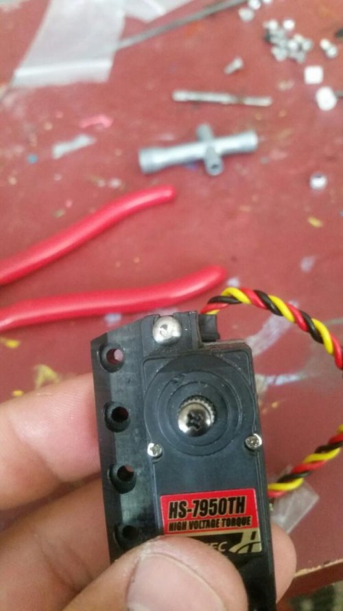

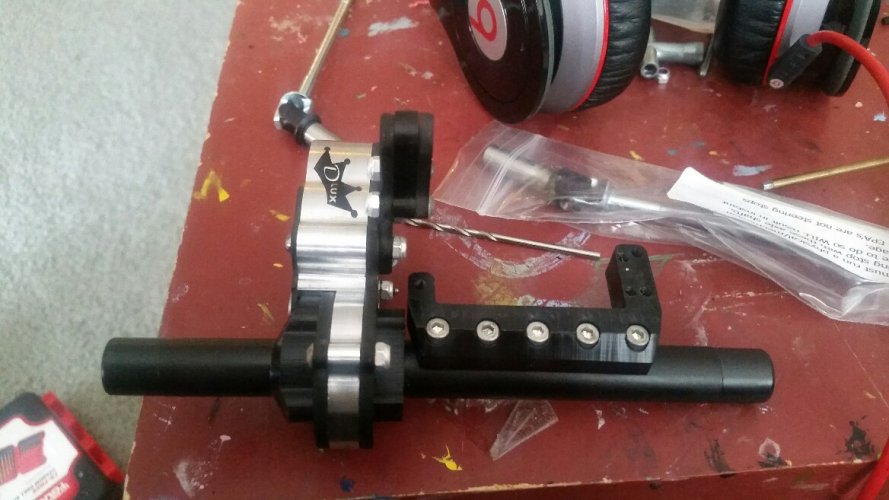

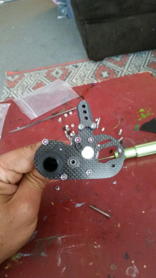

Okay so installed the bearing and tube, then the carbon side piece. Next I drilled, tapped and mounted the servo mount. I had to install the servo, grind down the tab on the servo that wasn't being used so I can push the servo and mount up against the tube. I then leveled it out with the bottom of the axle and drilled my holes. Used a tap just in. The beginning of the hole to get the screw started. The screw closest to the gears is a bit too long. Torqued all down the right amount it hits the locker so I backed it out a little. I might grind it down.

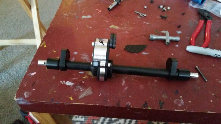

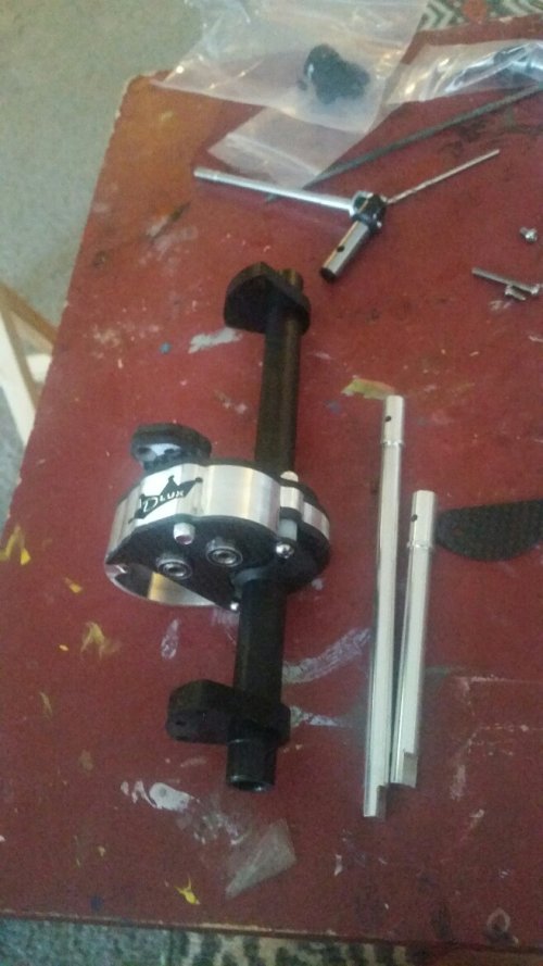

So I moved onto mounting the axial chubs. Erik says to drill them out with a 13mm drill bit. I have to to pick one up so I out the front axle to the side and opened up the rear axle parts. After completing the front the rear went together basically the same exact way besides the link mount being a little different. I through that together in about 20 mins.

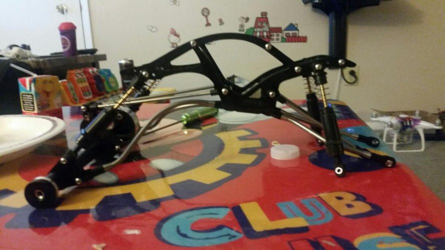

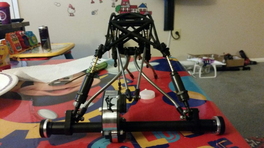

Alright got a little work done. Still waiting on knuckles. I've been going back and fourth between the berg build and the suduzero shafty build. I mounted the links, shocks, rear axle and hubs. The rear links I had to play with a little. If I ran them straight up they hit the top links so I had to turn them in and that worked perfect. I'm going to wait until the rig is completely assembled to adjust and finalize the position of the link/shock mounts

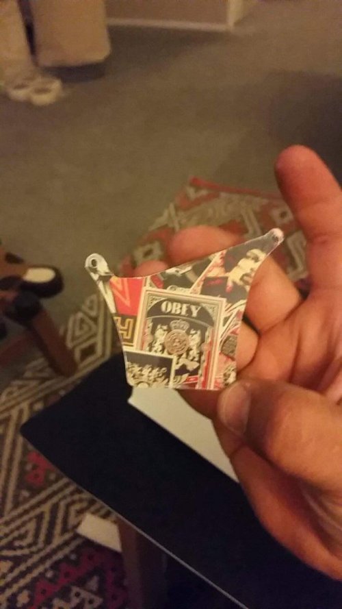

Hey everyone. Haven't posted in a while. I'm still waiting on knuckles, loaded dice and new wheels. Hopefully this week they will be in so I can finish this rig up in time for a comp. But as Ivr been waiting I've trying to find a awesome design for my panels. I found this one but printed out with out the white background. I stuck it underneath the label to see how it looked. Let me know what you think. First try

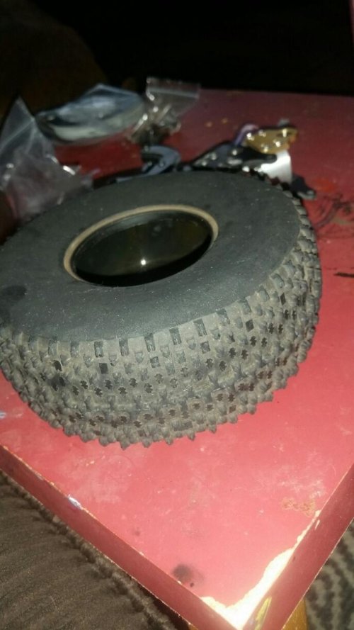

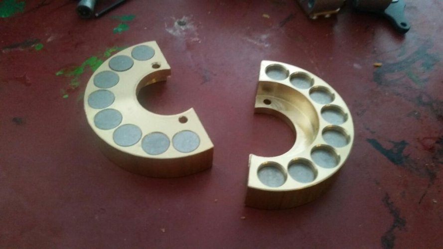

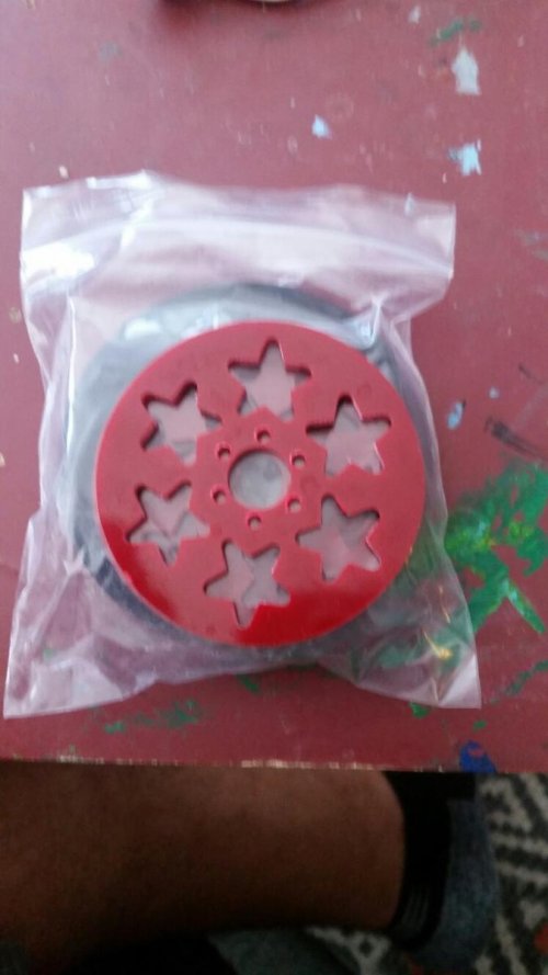

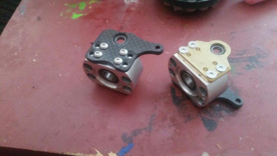

Hey got my parts in from Dlux! Time to get moving on this build. Here some pics of what I got in today. Right away I built the knuckles and hammered the slugs into the loaded dice, wanted to put the wheels together but I didn't do anything to my tires. So I decided not to use the rovers and go boss claws. Winnerone23 highly suggested it. I drove his rig this weekend and it was glued to the rocks! So cut two tires and shaved one.

Haha okay I'll get them when I get back from the gym. Basically in supposed to hammer the fba axles Into the missing link locker. I've been doing that. The short side axle won't go in any further. I grinded 2mm off each axle for the super lights. I don't know if I missed a step or not. Has to go in about another 5-6mm
