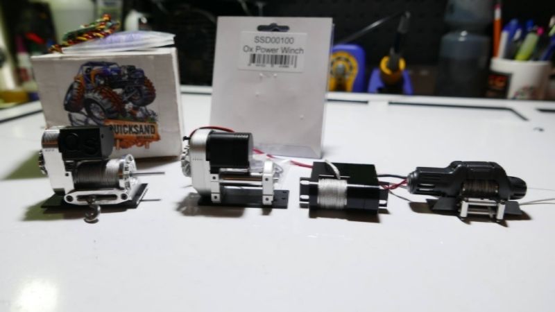

rc4wd posted a photo of their Warn 8274 on their Instagram, they didn't say when it will be available but they said its coming.
Sent from my iPad Air 2 using Tapatalk
Similar. Looks slightly smaller in this pic.
