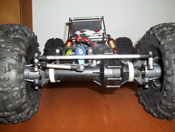

shaved the knuckles and C's to get all the steering i can get out of the shafts.
before
after
i like using the axial bend rod ends. they give me just enough clearance that i dont have to make bends in the tie rod.
this steering setup may end up changing. i just dont like how low it is.
just a tip. when allowing the knuckles to turn more make sure that the CVD is not now hitting the inside of the knuckle on full steering. i have found that they usually hit before you bottom out on the C-hub after you do the grinding.
know what i mean? i can take a picture tonight.
yeah man. what bart said. i put my tierods as close in as i can get. that way i dont need that long arm on the servo.
you might be able to tell what i did in these pics with the tie rods. the drag link id on the end hole, but the control arm from the servo is very close in. that makes the servo hve to move very small amounts, and also speeds up the action a bunch.
the bottom picture you can see what i was doing.
thanks bud. i did run into that problem, so i shaved some material out, inside the knuckles.
Flip the servo horn and put the tie rod on top of the knuckles. Could even use the closer hole on the horn and trim it down.
thanks for the help guys.
this is what i ended up with.
to make it work i put some spacers in the servo to move it back. so the tie rod wouldnt hit the servo horn at full turn.
