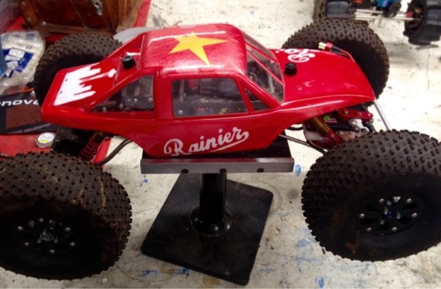

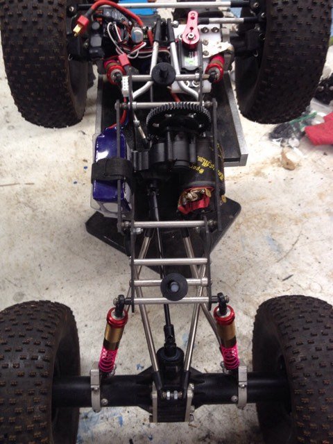

Here are pics of what it looked like when it arrived;

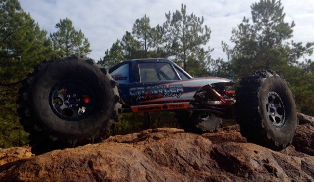

The only thing I have done to this rig is change the body and the wheels and tires. I've never purchased such a well tuned rig before. It's amazing what it does and how smooth it is on the rocks.

Glad to hear you like it. How much wider is it with those wheels?
I really do! Thank you for selling it to me / CI.
Track width as pictured is 10.75"
350 hub front
600 hub rear
1" width 6 bolt wheels
I could still narrow the track width if need be.

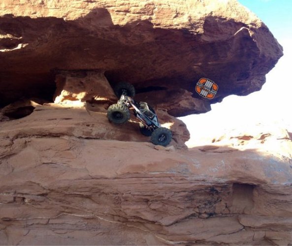

Some pics of the TF Sporty from the CI road trip to King of the Hammers 2016. This location had some great terrain to drive on:

The build up of this rc crawler began in April of 2013. The axles are customized Kyosho Twin Force or Mad Force straight axles that have been heavily modified. The Kyosho twin force was the electric dual motor transmission version, while the Mad Force was the nitro version. This rc vehicle features many rare and custom parts from Super Shafty. It uses an Axial transmission. The chassis is carbon fiber. The rims are Crawler Innovations 6 Bolt Wheels in the 1" width (P/N; CWR-5003); the tires are narrowed Hot Body Sedonas with shaved sidewalls, grooved lugs, and clocked tread pattern, the tire foams are Crawler Innovations Double Deuce Foams (P/N; CWR-1044 front and CWR-1045 rear. The RTR weight is 4 pounds 3 ounces.
