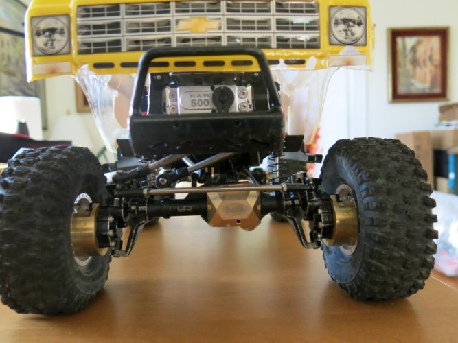

Ok my fellow Crawlers/Scalers RcBee here BUZZZ. and im sure 100% of you have this problem but I need just one or 2 with the solution!!!!!
ok so I can figure a lot out with my builds just on the fact I have the internet available for either videos manuals or to readily order parts!!! but the Servo Horn issue has been plaguing me for Iver!!!!
I have a lot off different servo horns and at this point mainly use Reefs servos and I do have the screw sizes correct and I never go farther into the servo or force a screw in but even when I have the screw in tight by the end or middle of my run its loose!!! lucky most of my servos have clamps but there has to be a solution!!!
So please help BENP TOPHER HUBOLDT SCALELIFE what's the answer!!! I know am power hungry with servos and im about to Change up to a Triple 777 and the Reefs Raw has already bent the Panhard and flip my rig over countless times so need a solution as im moving up in power and steering radius so need a solid connection to my servo.. BUZZZZZ
Also im gong to install 2 winches the Reefs triple 4 Smart winch and what to do about the screw there also??
BUZZZZ..... BUZZZZZZZ.....

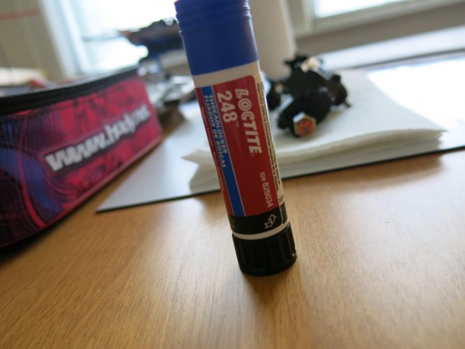

I will 2nd the blue loctite. I have had zero issue with a loose servo horn screw since.

I "third" the Loctite. I've got over a dozen vehicles & vessels, ALL of which have Loctite on the servo horn screws...and, I've never had any come loose. The only time I've ever had any come loose is because Loctite want used...which is exactly the reason why I now always use Loctite.
Just be sure to only have a very small amount, and on the threaded side. You don't want any getting inside the servo.

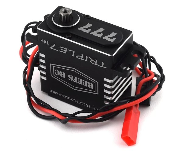

PHIL im using the Loctite and it will be used on a more expensive servo 777 if you have suggestions and or recommendations from your experience on other servos let me know id love to check them!!!! BUZZZZ.
alos i have a 3Brothers g13 servo which is direct power like the 777 let me know your thoughts on these servos????? BUZZZZ...

Make sure Loctite is blue or purple. Red will be hard to get loose.
I Loctite (Blue) every single servo horn that gets threaded into a metal spline. Have since the dawn of time, never had an issue getting one back out, nothing to worry about there. It's annoying when it gets loose on a crawler, it's expensive when your $600 nitro truck loses steering while going 50 and clips a metal pole. Ask how I know.. :)

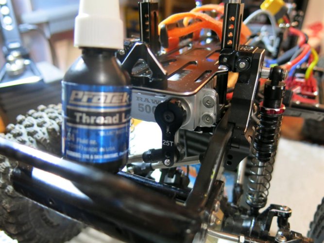

Yep, blue loctite. I have lost a lot of servo horn and steering link screws and loctitie gets the job done. My personal favorite is the Protek RC blue loctite

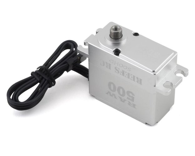

One of the contributing factors to the servo horn bolt loosening up is how tight the splines fit the servo. I've noticed there is some discrepancy in how the horns fit onto the splines. If the horn falls into place without any effort, it's not going to want to stay tight. I like it when I have to gently squeeze the horn onto the splines. If the splines don't fit tightly then the bolt will never stay tight as the horn rocks back and forth ever so slightly, loosening the bolt with it.
Also, once a horn has loosened up a couple times it's very likely that the splines are worn since the aluminum horn is softer than the steel output shaft. This makes it less likely that the horn screw will stay tight.
I never used to have this issue when I ran weak sauce servos, but now that the fleet is mostly running 470+ oz/in servos the horn bolts are definitely ones to regularly torque check, even with loctite.

You Are Correct I finally got everything set up properly and noticed the servo head has some play side to side and I have been beating this servo for over 2 months the splines don’t look too bad because most of my horns have side reinforcement screws but I definitely messed the gears in there so I went ahead and got a set of gears on reefs.com.... thanks for all the good info... Buzzzzzz.....
