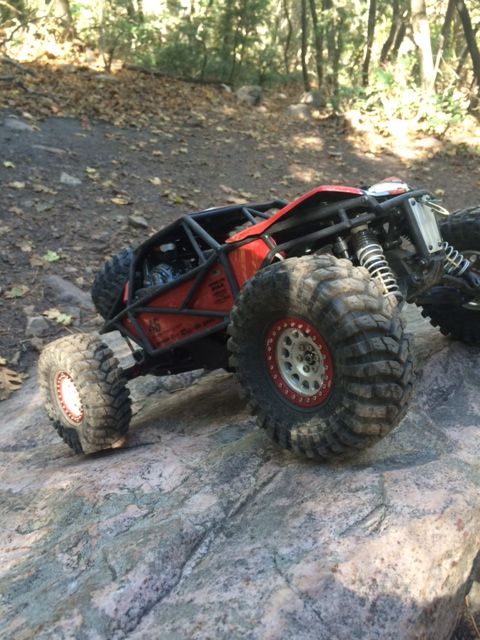

Shawn's YETI
STIshawn
Sep 5, 2014
33
SLC
Front End:
Axial HD Gears
Blue Monkey Long Spool Locker
Dlux modified Diff housing
Traxxas CVD’s
RPM A-arms (clearance for Traxxas CVD’s)
STRC Carriers
VP Knuckles
VP Steering rack
VP Steering posts
Traxxas Turnbuckles w/Revo Ends
EXO Front Bumper
Modified STRC EXO Shock tower
Pro-Line Powerstroke shocks (Slash 4x4 rears)
Rear:
Axial HD Underdrive Gears
Axial stock shocks w/Dual Spring added
Blue Monkey Trailing Arms
Blue Monkey Upper links
DMG rear skid plate
Traxxas turnbuckles for lower swaybar
VP Linkmounts
Dlux Modified axle housing
Electronics:
Tekin Pro4HD 3000kv
Castle MMP
Castle BEC
Hitec 7954SH Servo w/ Axial Servo Arm
Spectrum 301 Receiver
HeyOK Winch Controller
KMS K3 Servo Winch
Transmission:
12/64 Gears
Axial machined motor mount
Axial machined slipper plate
Body:
EXO Hood and Roof (some modification needed to fit)
Custom cut lexan side panels (thanks CarterFab for the idea)
VP Method 105 Wheels (350 SLW front / 600 SLW Rear)
Custom built 1” wheel cans (thanks again CarterFab for the idea)
Axial 2.2 Maxxis Trepadors R35
Crawler Innovations Deuces Wild Foams
Custom built Servo saver delete
[/COLOR][/SIZE][/FONT]
The journey to completion was long... but well enjoyed.
Made my own 1" cans for the VP's since nobody had any in stock...
Stock foams and VP's (Left) CI Deuces Wild on the wider cans (Right)
Blue monkey locker with traxxas CVD's (Defiantly not a bolt on)
Had to make some custom spacers to take the slop out of the hub since the hub pin on the Traxxas CVD's wasn't in the same spot as the stock Axial pin (2.5mm I think).
Dual rate springs I had laying around...
Blue Monkey trailing arms installed
Winch... why not?
Still not sure how I broke this...
I think she is nearly done... for now atleast
