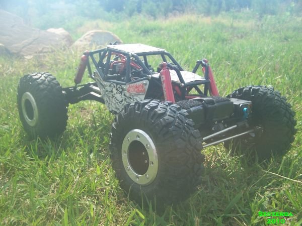

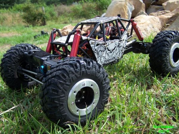

Got a set of RC4WD's 2.2 Spooky Crawlers from rubiredunlmtd to test out. And some donated beadlock rings from rubiredunlmtd.
They aren't as grippy as the Etna cuts but they still work good. I put in some stock rover foams. The Spooky foams seemed way to stiff and bouncy, rover foams are alot better. To scale it up more, i think some smaller diameter shock bodies are in need.
