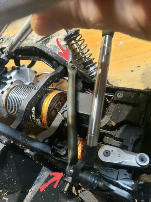

Nice job on the double shear bracket for the steering, that was a failure waiting to happen.

I made a bracket for the panhard mount to make it double shear as well as the mount on the axle out of 3/8 brake line. I flattened the end in a vice and drilled a hole in the flat spots. I wanted to go strait across but there was no good way to mount on the other side of the frame so I angled it i but. Doesn't seem too make a difference, the panhard mount is really solid now and with the one on the axle the steering is way better. I do have a castle bec set at 7.2 volts as well.
