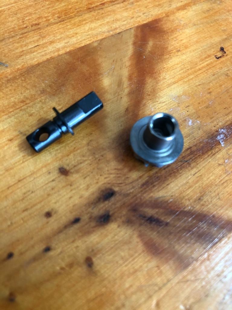

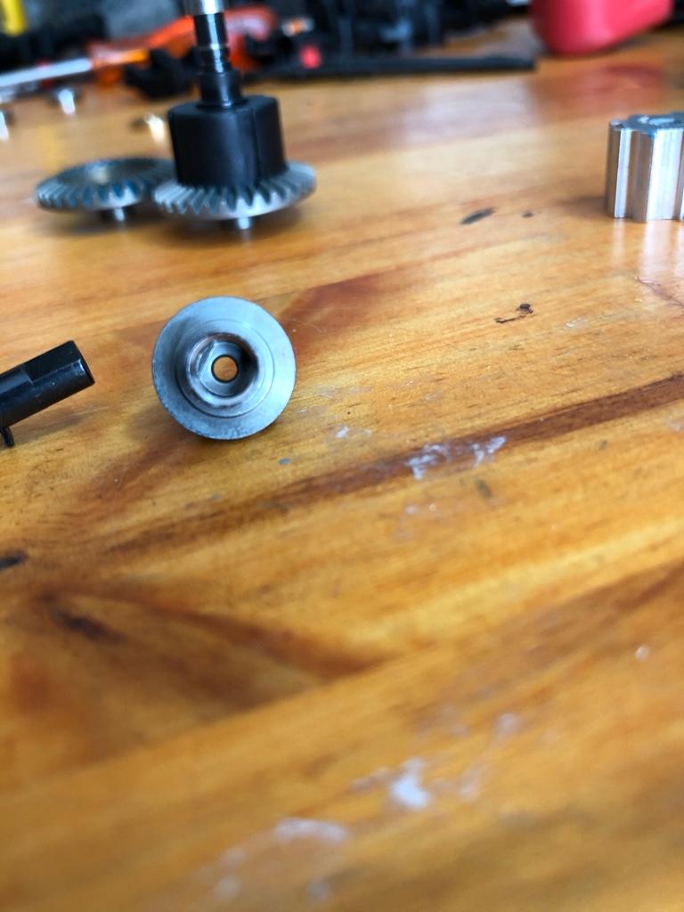

Here’s whats inside the axles:
Generic scx10 ‘cvd’ shafts up front:

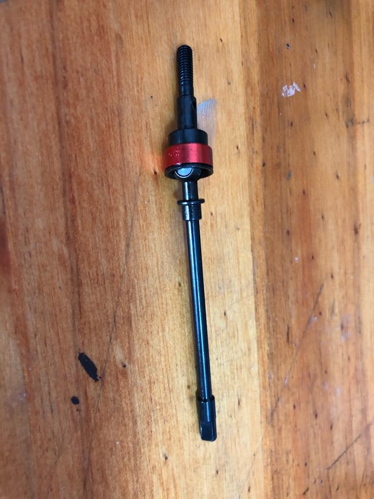

AR44 shafts in the back:

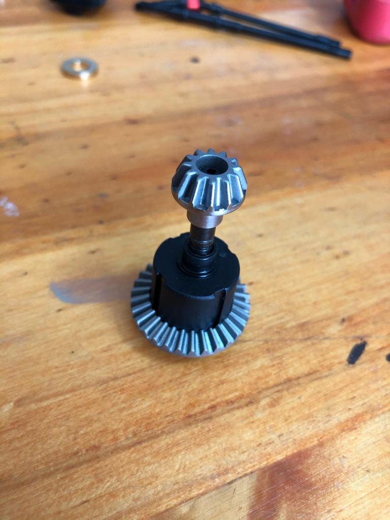

WLToys 12428 diff with locker:
The diff runs on the wrong width bearings too. Needs to be 0.5mm wider to eliminate slop thats probably causing the stripped gears everyone is complaining about. Will update this when I rebuilt the lot.
Shimmed the bearings and its almost perfect.

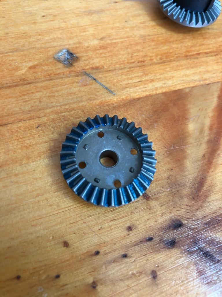

Replacement ring and pinion gears are dirt cheap at least.

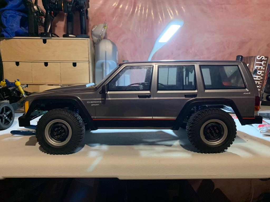

Well it’s been forever since I have updated my build!
I’m really happy to see all the activity in here of people chiming in on their Injora chassis’!
I FINALLY got started back to building mine. With all this COVID-19 crap there really was no excuse to continue the build!

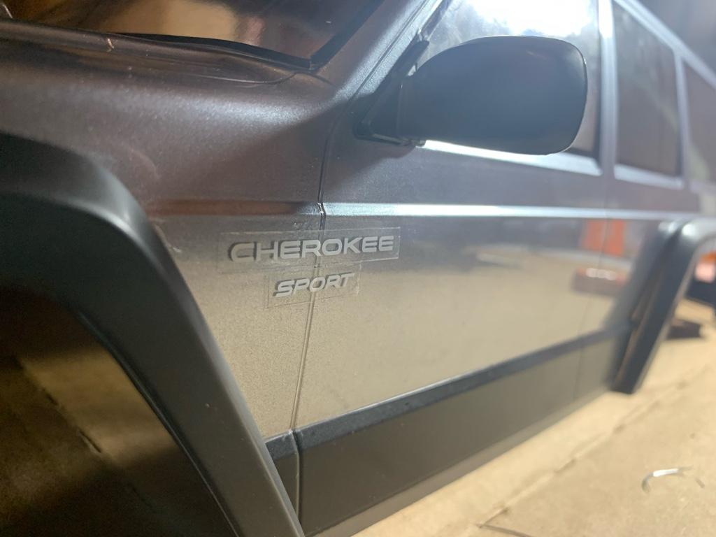

My body was waiting patiently for the paint that I selected. Tamiya PS-63, bright gunmetal. I painted the fender flares and bumpers black and coated it with Tamiya’s Flat Clear PS Paint. Came out really nice!

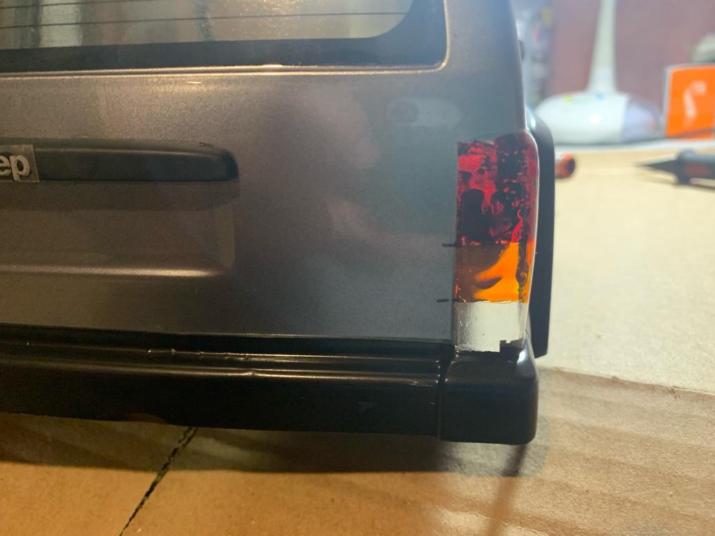

The Axial Cherokee body fits the Injora perfectly and will be mounted with some magnetic body mounts. The majority of the body is done: I just need to add the door handles, red ‘Sport’ trimming (edit: added), rear light buckets and then add some LEDs to it. Overall, really impressed with the quality of the body and look forward to driving it on the chassis- finally!
Stay tuned for more and thanks for following along :)
Really happy with how it’s turned out so far. I just positioned the magnets in place and they are now drying with some shoe goo. Hope it holds! Will see tomorrow morning :)

It’s funny you mentioned! Took it out yesterday, just around the yard a bit. A while since I last drove it. Runs great! I noticed a couple of the screws started to oxide on the heads (not from my doing as these were installed from the factory, and I cleaned my rig after I ran it).
Body and paint also holding up great too! Really a fan of this Tamiya flat PS paint covering the black portion of the body. I thought it would easily get scratched and wipe off but it’s very resilient!
