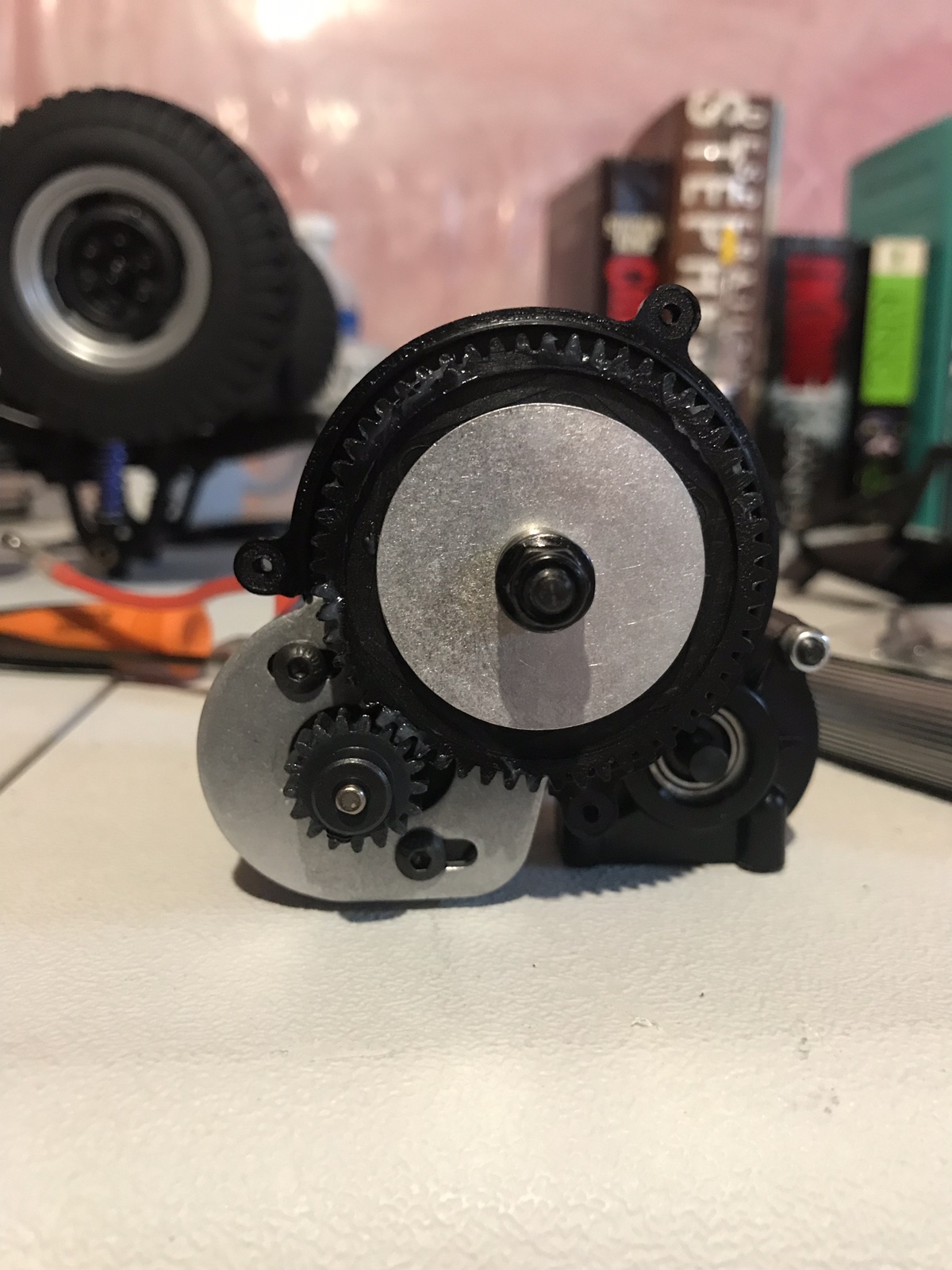

So I went back for round 2 on the transmission. i was in the process of taking off the spur gear cover and was going to tear down the trans. I’m hoping for metal gears here. Upon removal of the slipper spring nut and friction plate it has been revealed that the slipper pad is nothing more than a piece of circular foam tape LOL.
Im sure the slipper system would benefit from a better pad in place of the foam. :)
I then began to remove the three screws holding the trans together and once I was able to pull them apart I discovered that the gears inside are indeed plastic, but they were at least greased throughly. I added a little bit more just for safe measure and then added some bearing oil to all the bearings.
Once that was done I began to reassemble and noticed that the spur gear bearing was plastic? I’ve seen this before and figured to replace it with a ball bearing instead, a metric 5x11x4 fits perfectly, or for you Tamiya fans (like me) an 1150 bearing.

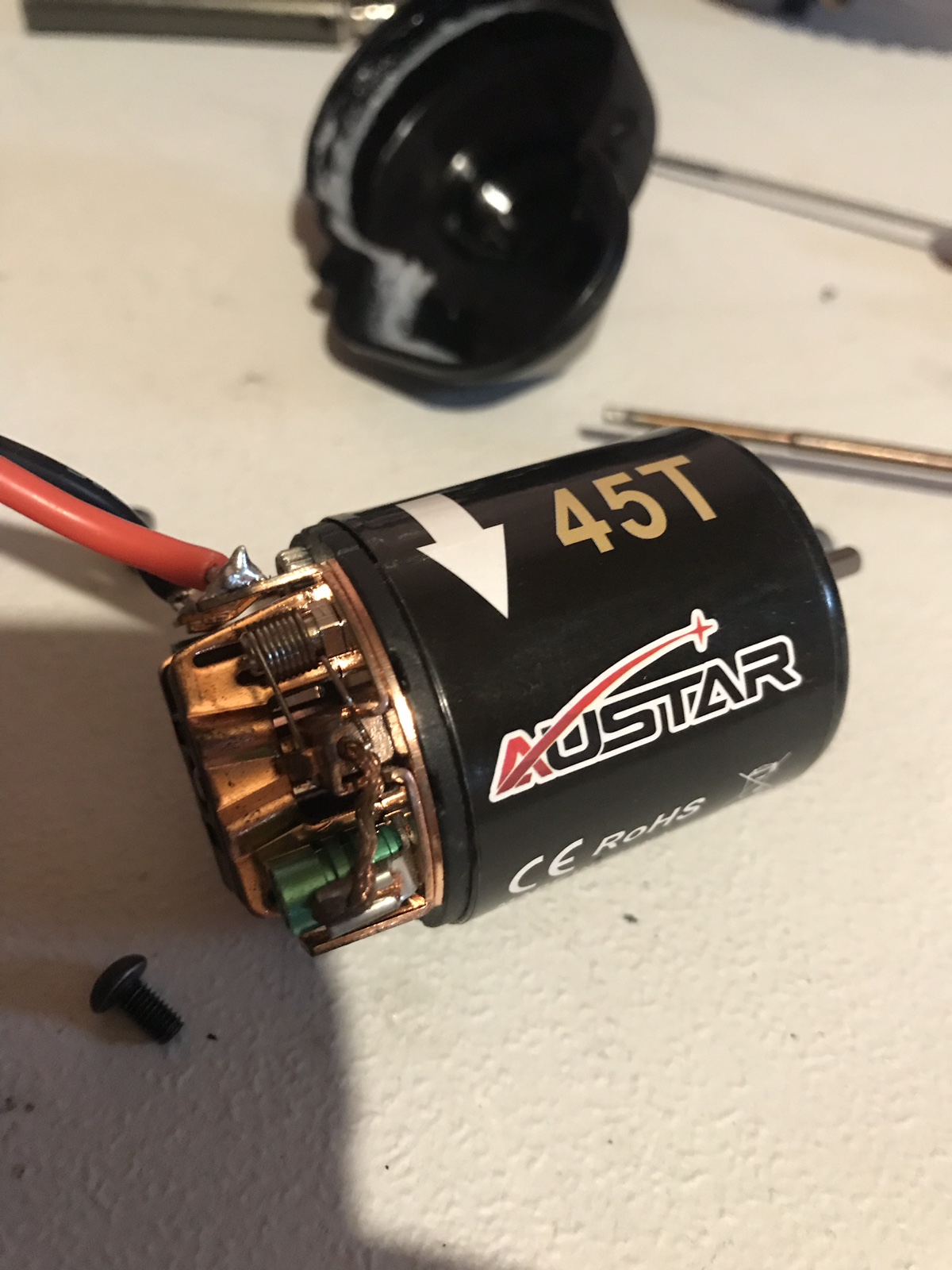

I had a 45T motor laying around so I installed it for some extra torque. The motor that comes with the Clone is the same brand “Austar” but 35T.
Transmission is all sealed up and tightened down.
