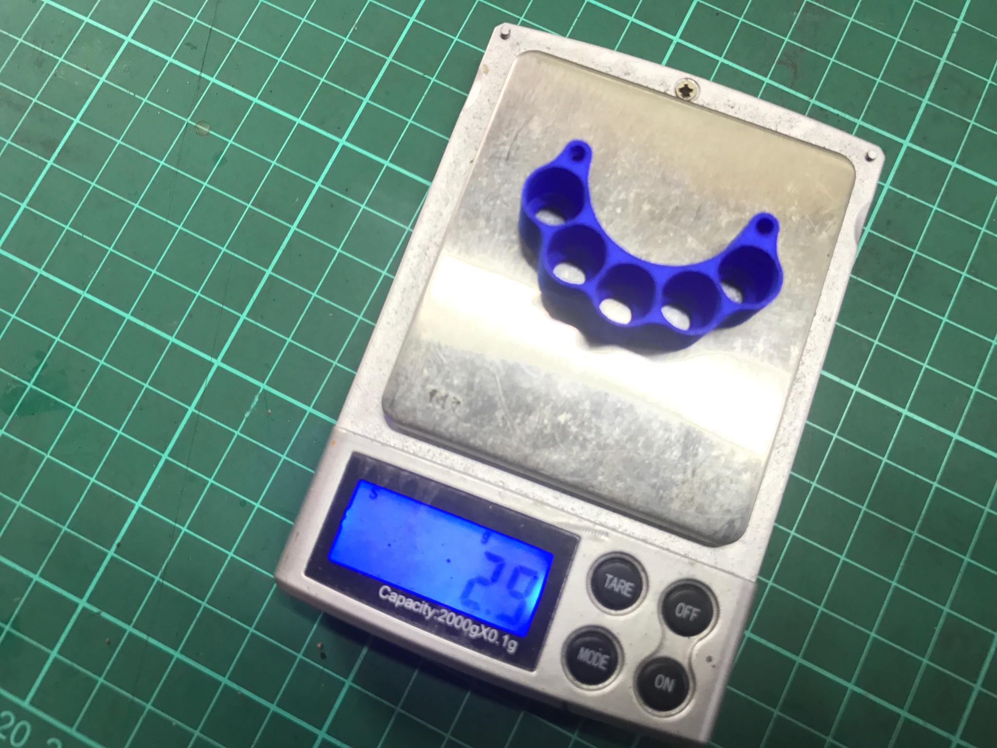

So a little update ...
My new weight hangers to suit dlux knuckles arrived from shapeways the other day. They came up pretty good and I managed to fit an extra tungsten slug in it and still runs on a two piece rim
