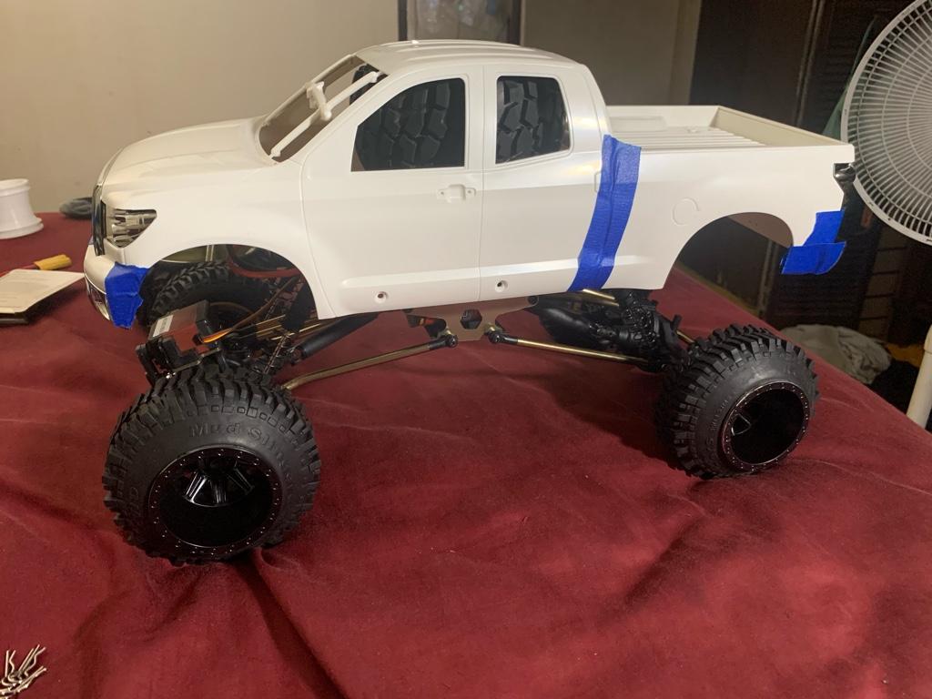

Already purchased a pair of used Gen7 frame rails to McGuyver onto this chassis. Something like I did with my RS10, except I’ll have some better suspension mounting options with the Gen7 frame & an easier way to mount the body. Need to swap out to some shorter links to bring the wheelbase in a little bit as it’s a little too long for the Tundra body.

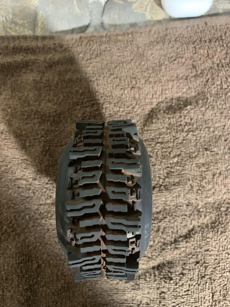

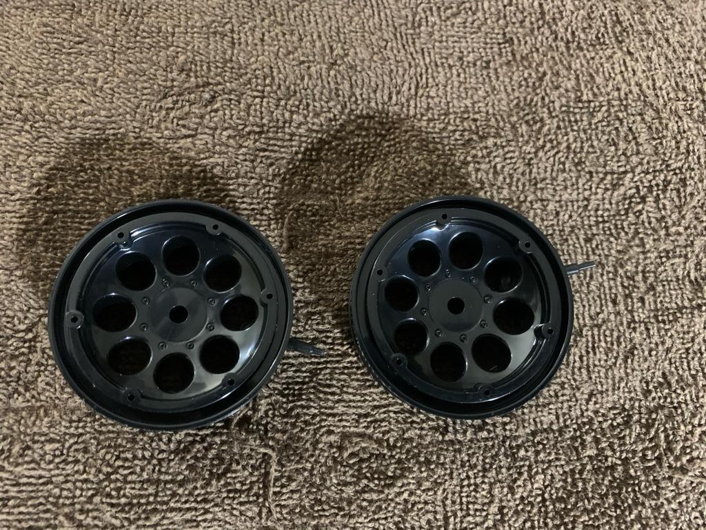

Cut up & mocked some 1.55 Mud Slingers onto my extra 2.2 wide monster truck wheels that I need to repaint black & clear over. Cut the stock Everest tire foams to fit the diameter of the Mud Slingers to “balloon” the tire edges out & stretch them a little better.

I had to cut the bead off the 1.55s. I originally bought them for my deep dish wagon wheels, but I wasn’t a fan of the look. Too much sidewall. Lol. These wheels pictured are actually 2.2 monster truck wheels that measure at 2.5” wide as opposed to the stock Redcat beadlocks which are only 2” wide.
Did it for shits & giggles, but I actually got it to work, so I left it. Lol. The passenger side has the stock Redcat wheels wrapped in the 1.55 & it wasn’t as stretched. It looked good, but I like that deep lip look. [emoji1690][emoji1690]

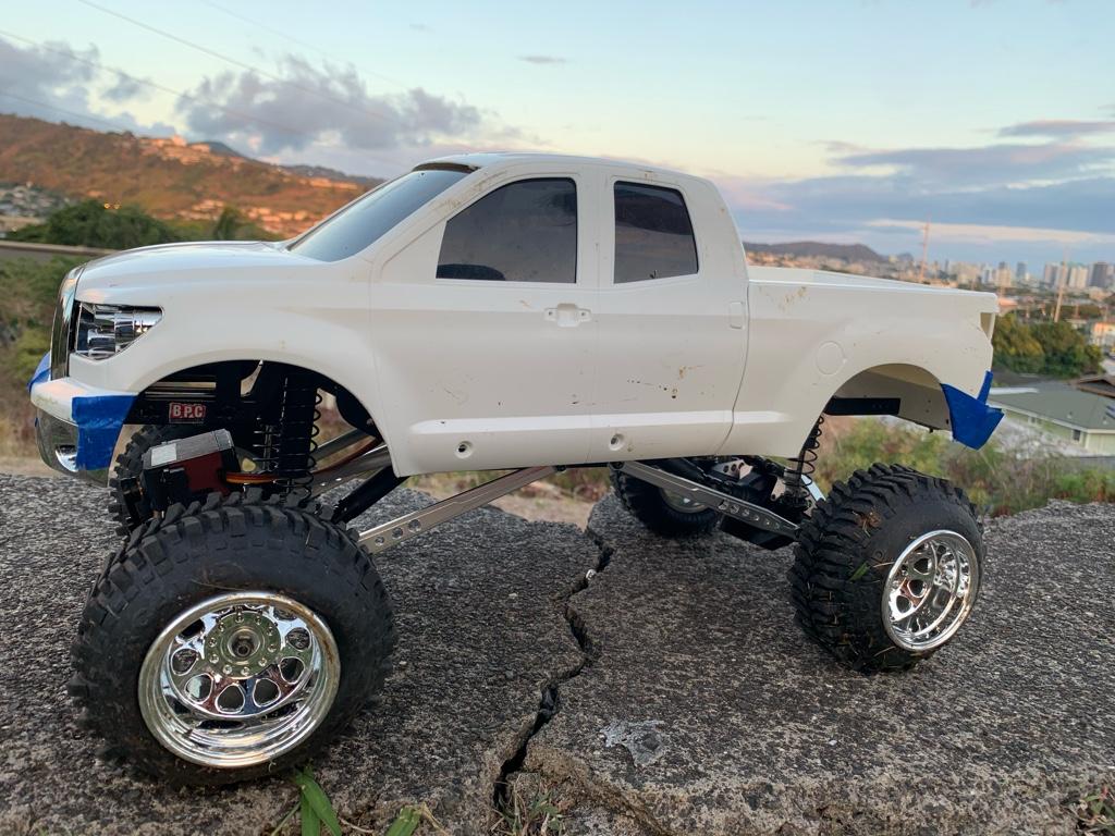

Slowly getting there. Need to paint today so I can mount & secure all the pieces to the body since the bed has already been secured to the cab.

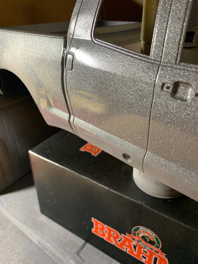

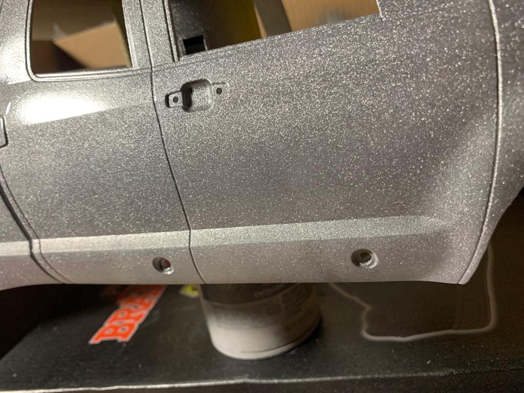

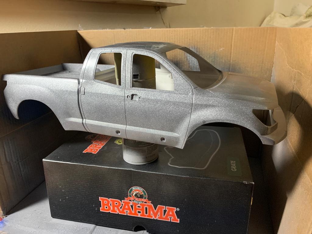

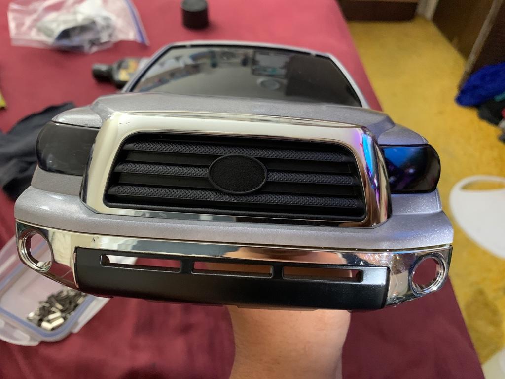

Got some color on the Tundra. Rustoleum Dark Steel Metallic.
2 coats primer. 1 light coat color followed by 1 medium coat. Finished with 3 coats gloss. Wet sanded & polished with Meguiars Ultimate Compound.
Sprayed the center grill & center of the bumper satin black. Tinted the headlights & tails with VHT Niteshades.

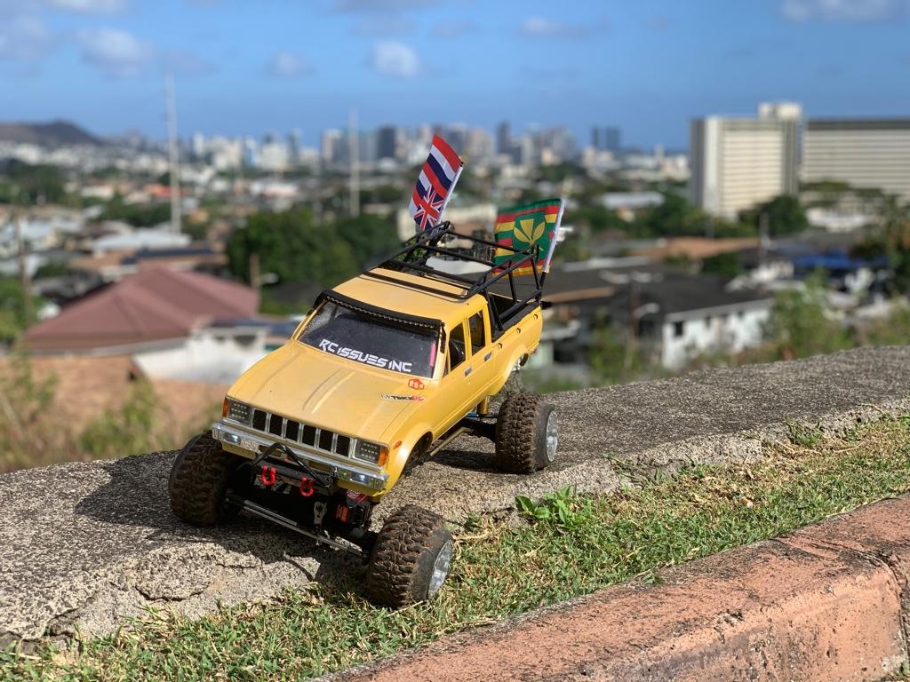

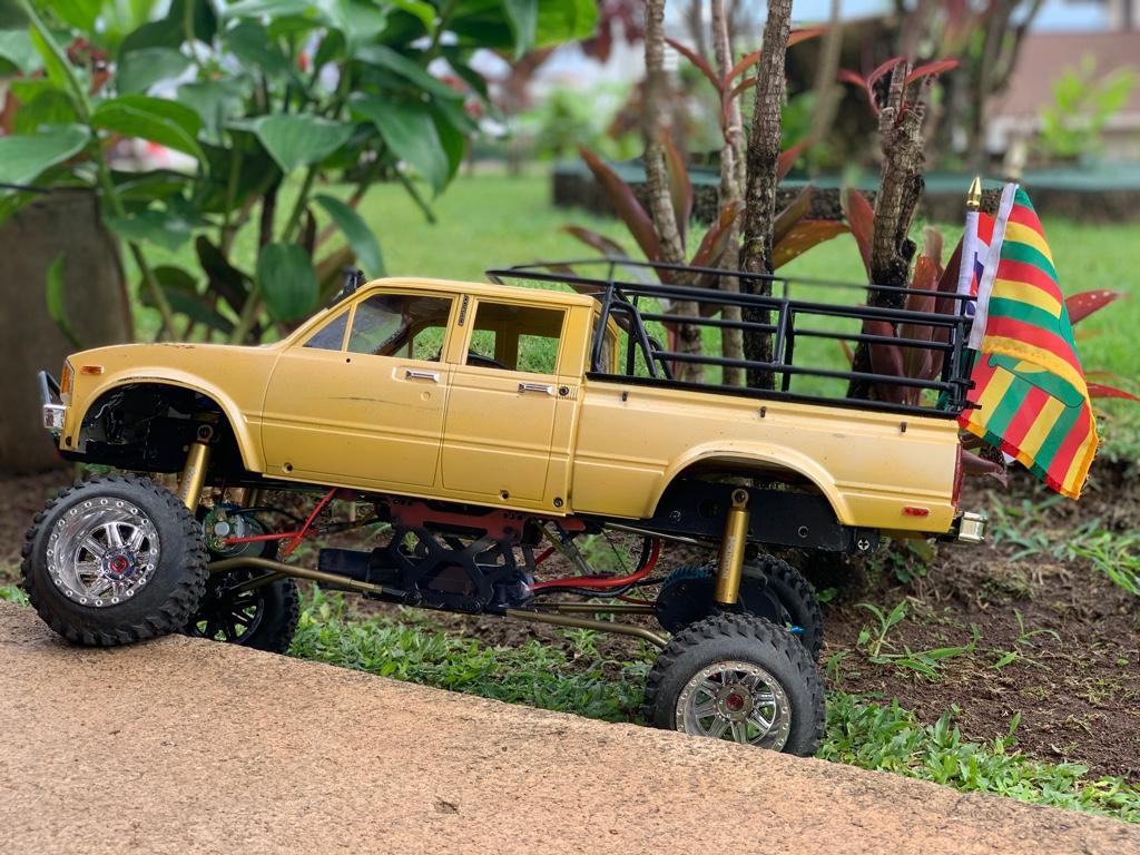

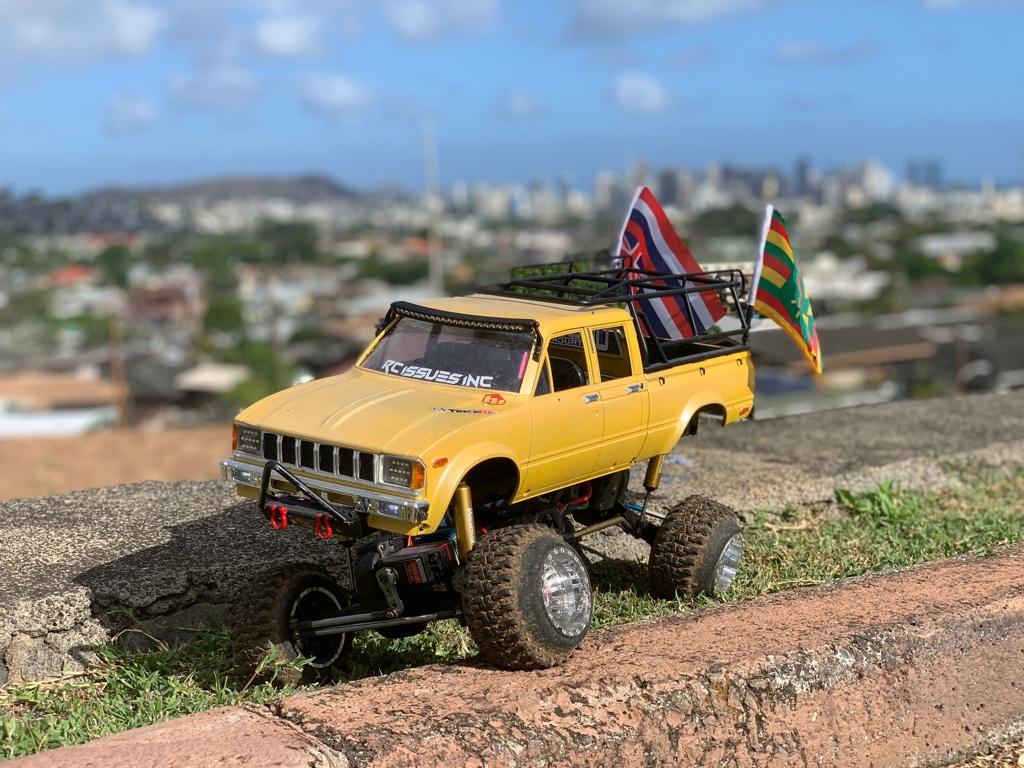

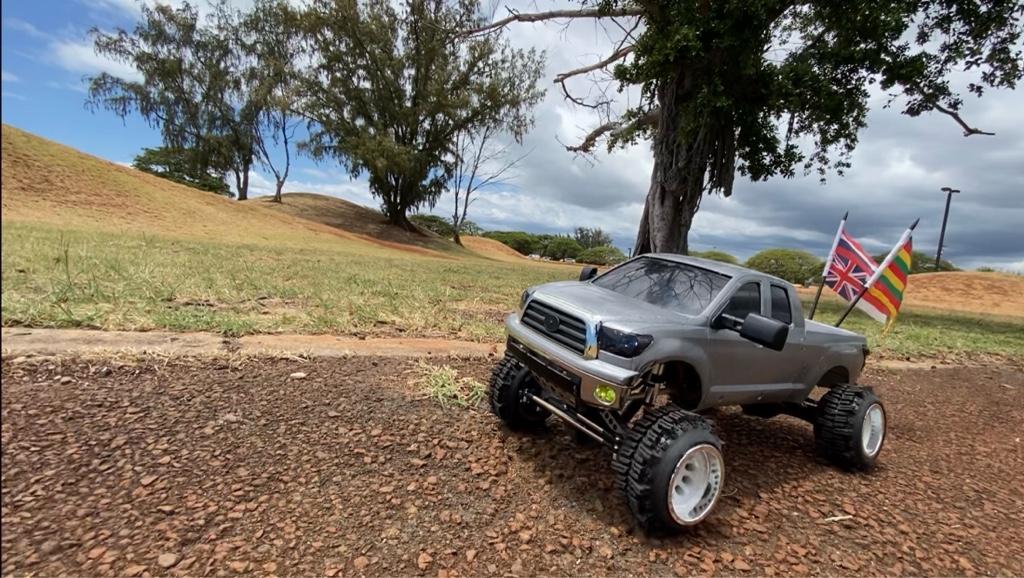

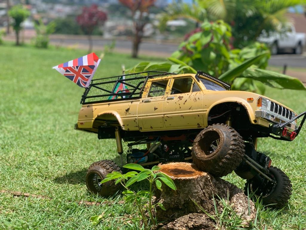

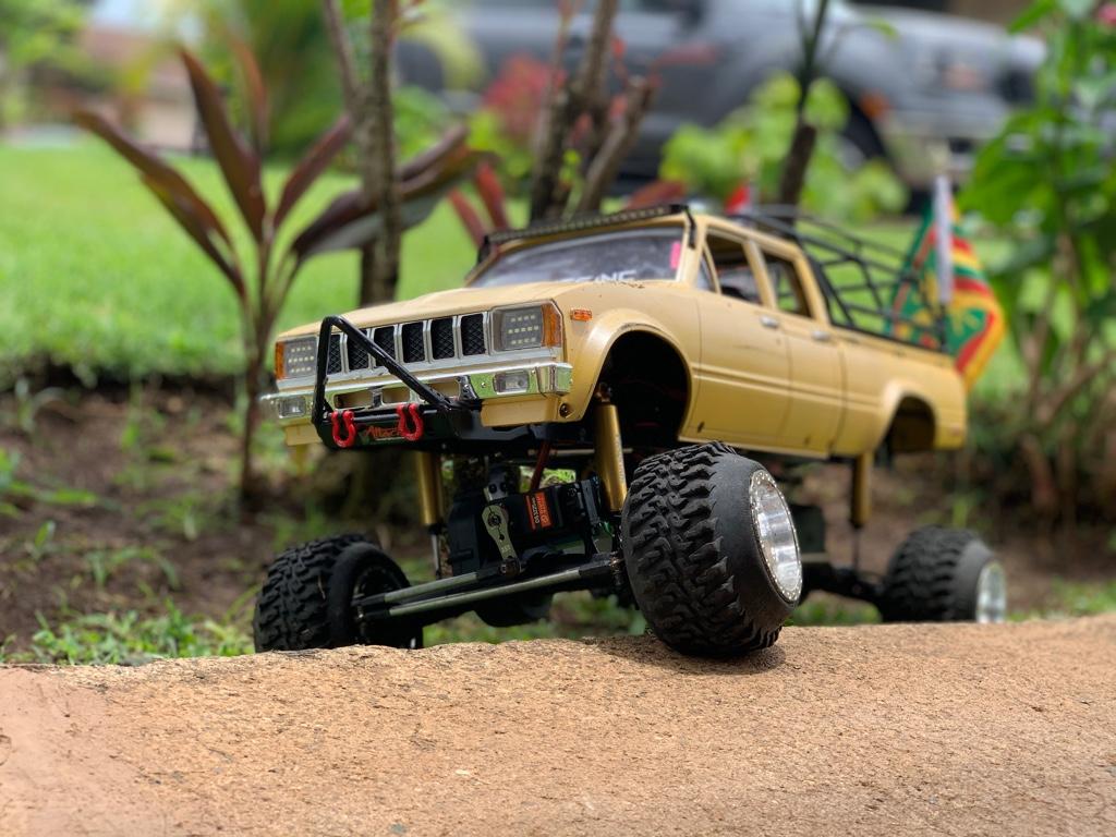

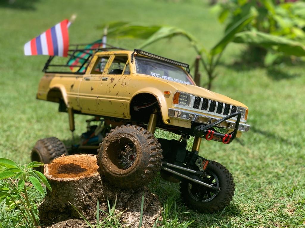

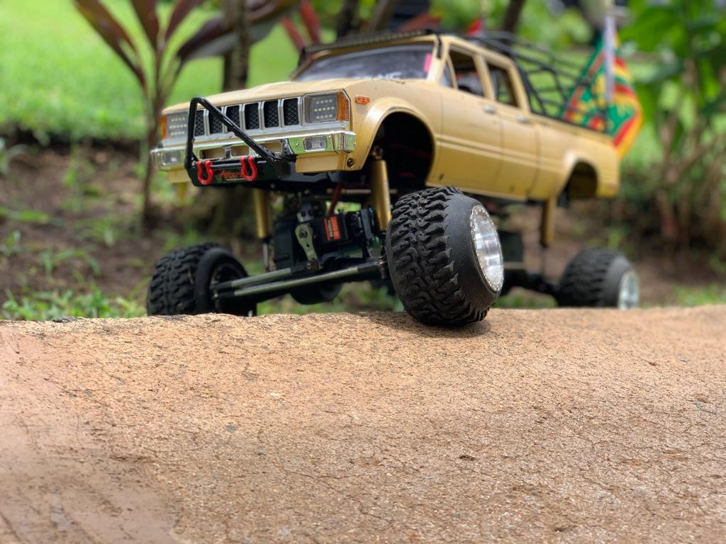

Some quick ghetto shots of the long bed hilux taken today at the in-laws. Love that backdrop view of Kalihi & downtown they have.
Did a little mudding around...

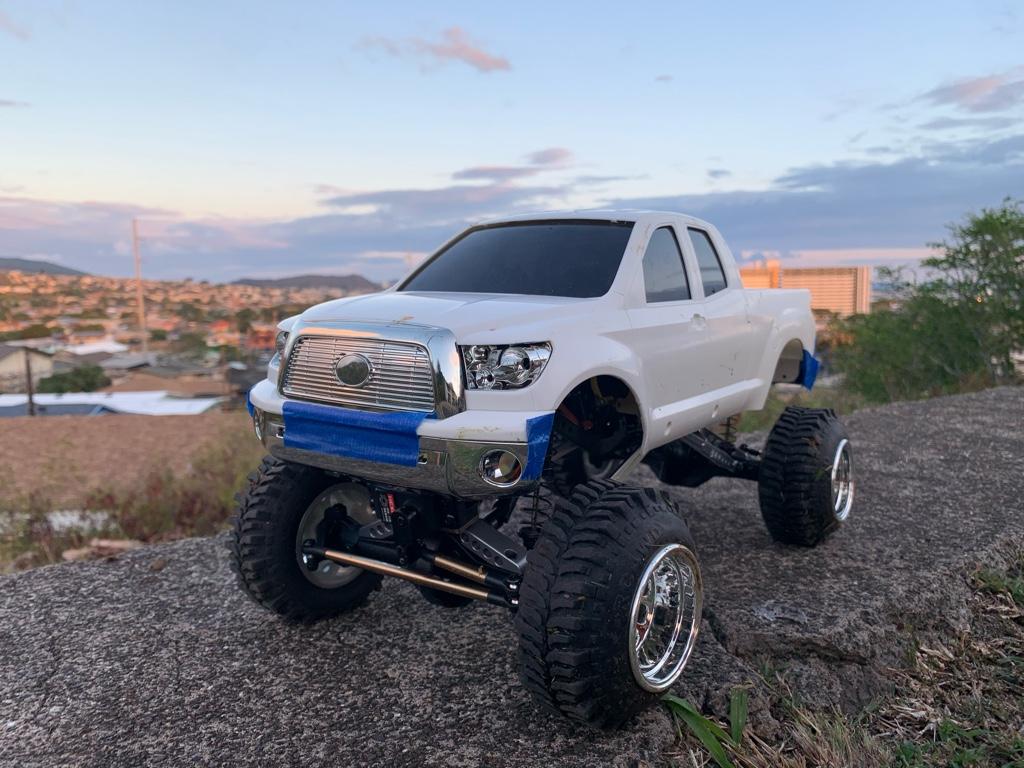

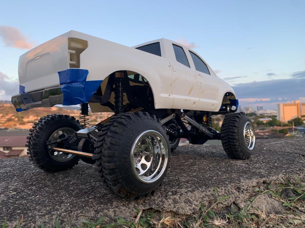

Everest-10 Tundra somewhat complete...

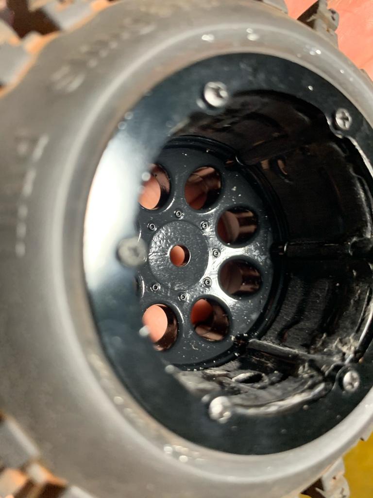

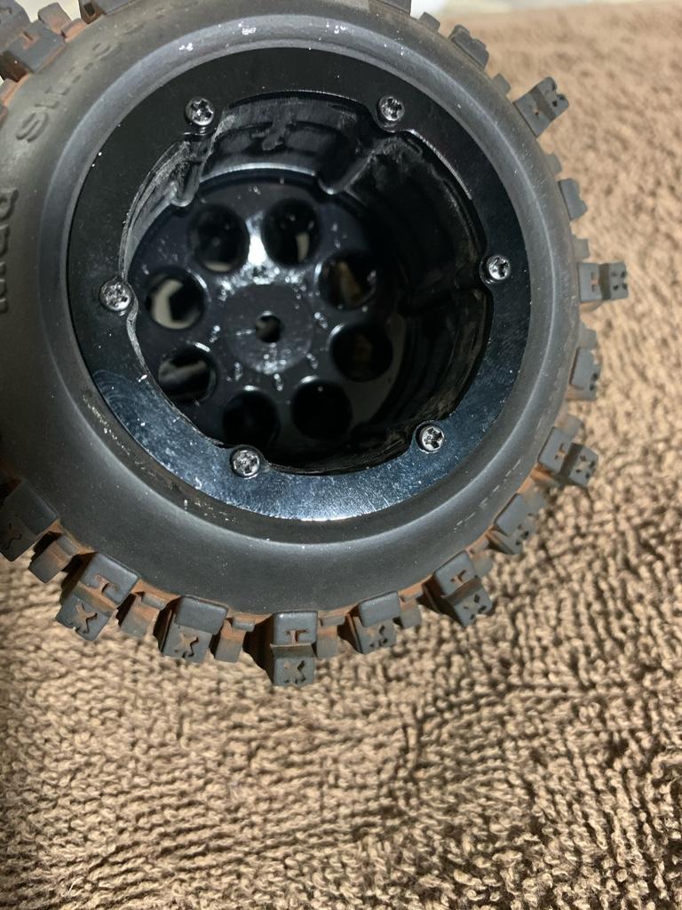

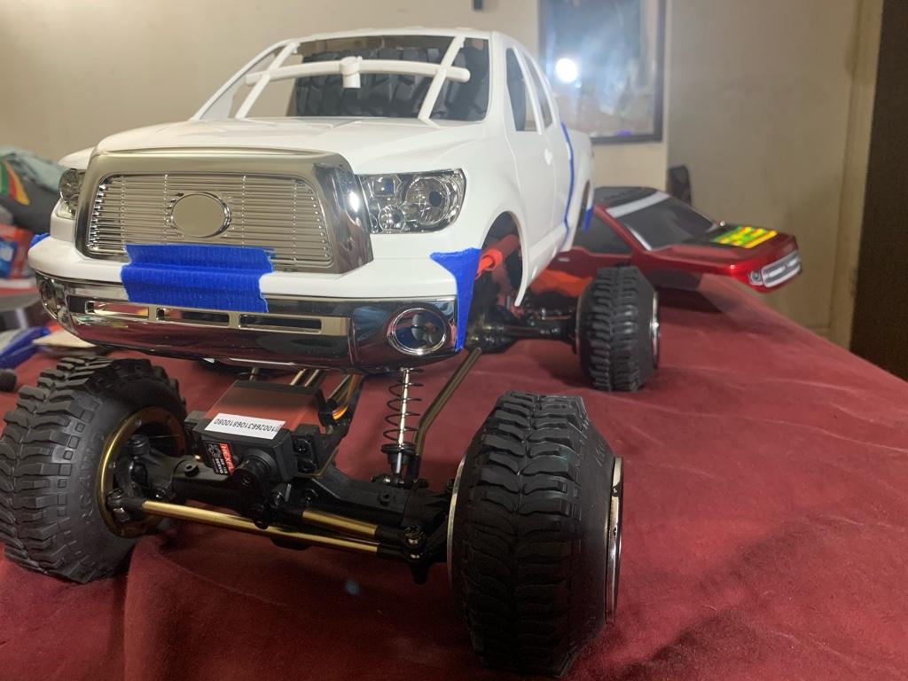

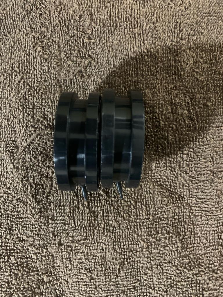

Trying my hand at some DIY deep dish rims. Using 2 sets of cheap 1.9 axial beadlocks, cutting the faces off one set, grinding & sanding down the barrel & gonna JB weld the 2 rims together. Looks good so far. Just gotta get some coarser sandpaper to knock down the barrel a little more, primer, paint & should be good to go.
Quick mock up with the 2 rims taped for now. Mounted a 1.9 Mudslinger on it to gauge the look.

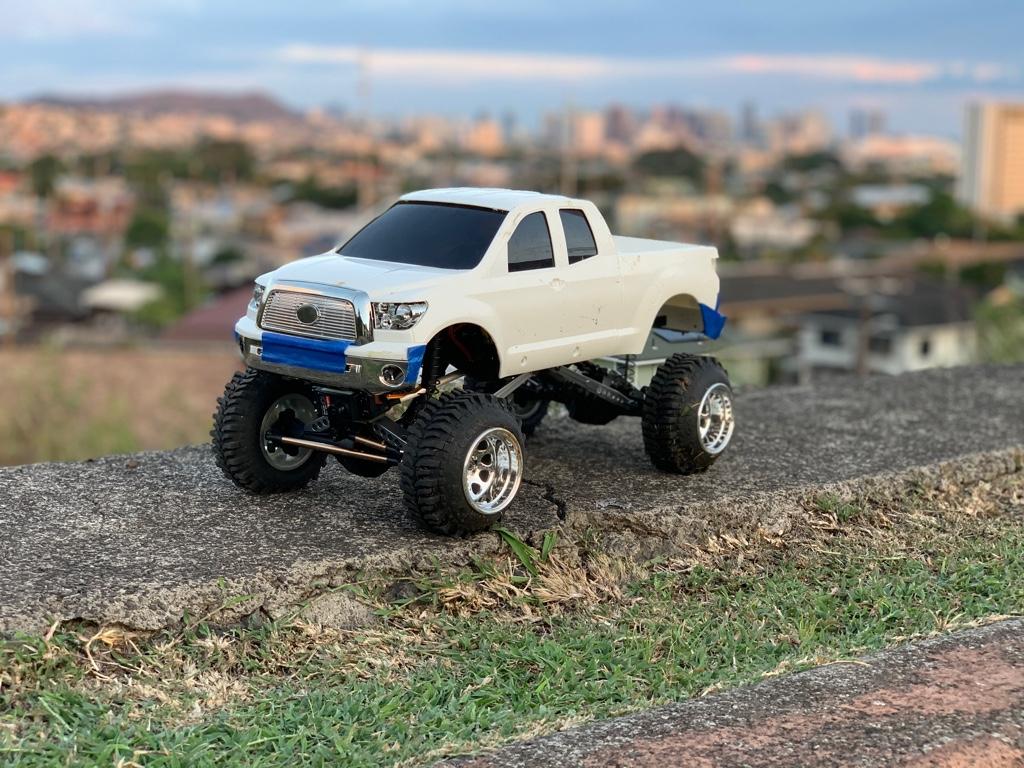

Tundra looks good! Try 2 sets of foams in the 1.9s. Should give the tire a more inflated look. Might be harder to put the beadlocks on too though. Just trim till it works
