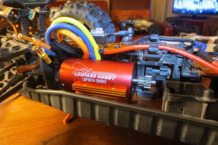

As noted in the "Electronics" thread, the motor in the Maximus is held by a very non-standard mount that is a "clamping heat sink."
That bizarre method of holding the motor limits it to only 36mm diameter. Most 36mm dia motors are meant for 1/10 scale rigs, not 1/8 scale monster trucks. The motor that came stock on the DHK Maximus has a can size of 3660 and is 2260Kv. It moved the truck along very rapidly, then died just as rapidly. Luckily, there is plenty of length in the motor bay, so I purchased the longest 36mm dia motor I could find, a Leopard LBP3674-1900Kv. I temporarily set it into the motor bay and took pictures. Here is the stock DHK motor next to the new Leopard motor which is significantly longer:
As can be seen here, the longer motor fits just fine (the clamping heat sink is omitted for clarity):

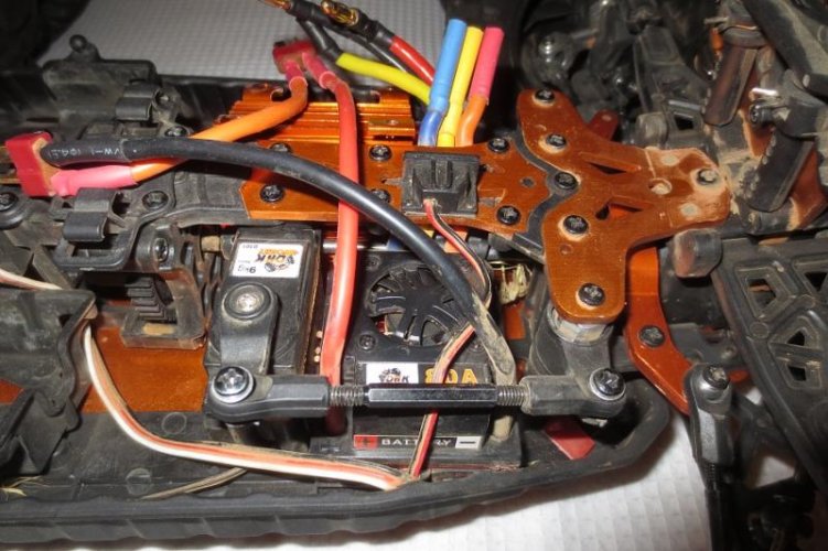

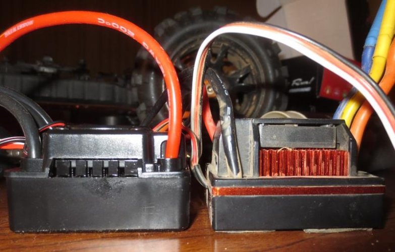

The stock ESC that comes with the DHK Hobby Maximus in a paltry 80-amps considering that the truck is designed to use dual 2S batteries in series for 4S. That pushes the ESC to it's max all the time. In addition to that problem, it has a very tight fit between the fwd bulkhead and steering servo such that the routing of the wires wants to rub on the steering link:
I wanted to replace the 80a ESC with something more powerful, but had to be careful with its physical size. I finally settled on a Hobbywing WP-SC8 which is a waterproof 120a ESC designed for use with 4S power. It is meant mostly for 1/10 scale rigs, but should do OK in the Maximus. Considering the size limitations, I don't have much choice anyway. Here are a couple of pictures comparing the Hobbywing 120a ESC on the left to the DHK Hobby 80a ESC on the right:
Due to the way the wires of the stock ESC wanted to rub against the steering link, I tried to locate the new Hobbywing ESC into the chassis with the wires facing fore and aft. You can see in this picture that I could not place it that direction because it would not fit in the allotted space:
Since I had no choice but to mount the new Hobbywing ESC with the wires facing sideways, I had to determine which direction was the best fit. In the following picture, I have loosely laid the steering link in place to see what interference would exist. It makes for some pretty tight wiring:
In addition to checking on potential wire chaffing, I needed to make sure that the fan power plug was easy to get to because that port is also used for attaching the Hobbywing external programming box. In this picture, you can see that the plug will be under the steering link, but at least that is easy to remove for access:
I checked the fit with the ESC turned around the opposite direction. That caused the fan plug to be under the center brace. The only way to access the plug is to remove the brace. I decided I would rather remove the steering link than the brace:
Doing this test fit is as far as I got today. Work and family time permitting, tomorrow I hope to solder on the connectors, get the motor and ESC installed, then take the rig out for a test run. If I do, I'll take pictures and video then post a report back here on the results.

I test fit the motor into the bottom half of the heatsink. Looking good so far:
To keep from putting too much pressure on any one point on the motor can, the four screws of the clamping heatsink need to be tightened gradually and in a diagonal pattern, kind of like tightening head bolts:
When all tightened down, this clamping heatsink actually holds the motor far better than I dreamed it would. Even so, it's still a royal pain in the butt to work with:
With the motor in its final resting place, the 74mm length is perfect:

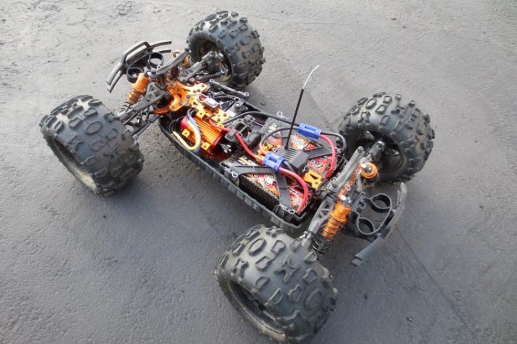

Here are some still photos to go with it:
Ready to roll for first run:
Ambient air temp today at run time was 81 degrees F:
The tarmac at run time was 97 degrees F:
When the LVC kicked in after 24 minutes, both batteries had 3.68V on both cells. Not bad! I was surprised the voltage was that high since I set the ESC for 3.2V. However, I think it can be explained by the fact that the ESC reads the battery while under load, so it probably sees 3.2V with the motor running:
The hottest that the ESC ever got was 106 degrees F. No big deal:
The motor maxed out at 159.5 degrees F, but my picture of that was blurry, so I didn't post it.

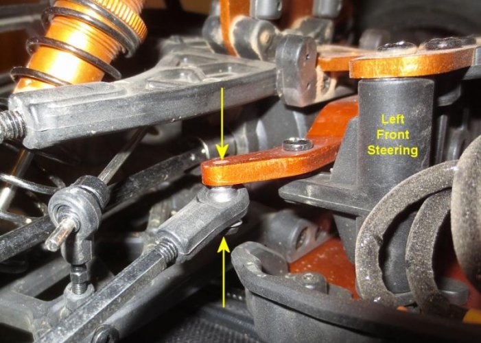

...lost a screw connecting the tie-rod to the steering plate. It's screwed from bottom to top so I didn't even see it come lose when I was inspecting it between runs...
I have had that happen to me. In fact, my truck had a problem from the factory where the screw on the right side was cross-threaded. I temporarily moved the right side to a top-mount position since it was cross-threaded on the bottom. Unfortunately, that didn't solve the screws coming out while bashing.
The RCScrewz company sells Kit Number DHK005 for the Maximus that has Stainless Steel screws with hex heads:
http://www.rcscrewz.com/product_info...ts_id/4422?SID
RCScrewz is located in the US with a distributor in Canada. They do ship internationally.
I actually prefer class 12.9 alloy black screws, but I purchased this kit so I could provide some feedback. Anything has to be better than the stock Phillips head screws. Even so, I was a bit leery about the order because the website stated:
"Some screws that are included in the our kits remain Phillips heads but are still stainless steel. We have done this for strength, as a result of our field testing, on small diameter screws (2mm and 2-56" dia). This may include some chassis screws and differential screws. All other remain socket head."
I now have the screw kit and am happy to report that there are not any Philips head screws in it. It's just a blanket statement on the website that may or may not affect a kit. The kit comes with basic L-shaped hex wrenches for each size of screw head. I didn't need that, but it's a nice touch. I've only used a few of the screws so far, but they are well machined and the hex tops fit tightly to my wrenches.
This picture shows the kit size compared to a laptop mouse and flip phone. The plastic box is pretty small:
Here is a close-up view of the screws:
This shows how the steering is mounted from the factory:
The right side was cross-threaded on the bottom, so I moved it to the top until I figured out what to do about it:
The permanent fix was really easy. I carefully drilled out the threads, then put in longer screws from the bottom with locking nuts on the top:
The finished product has a clean look and does not vibrate apart:
