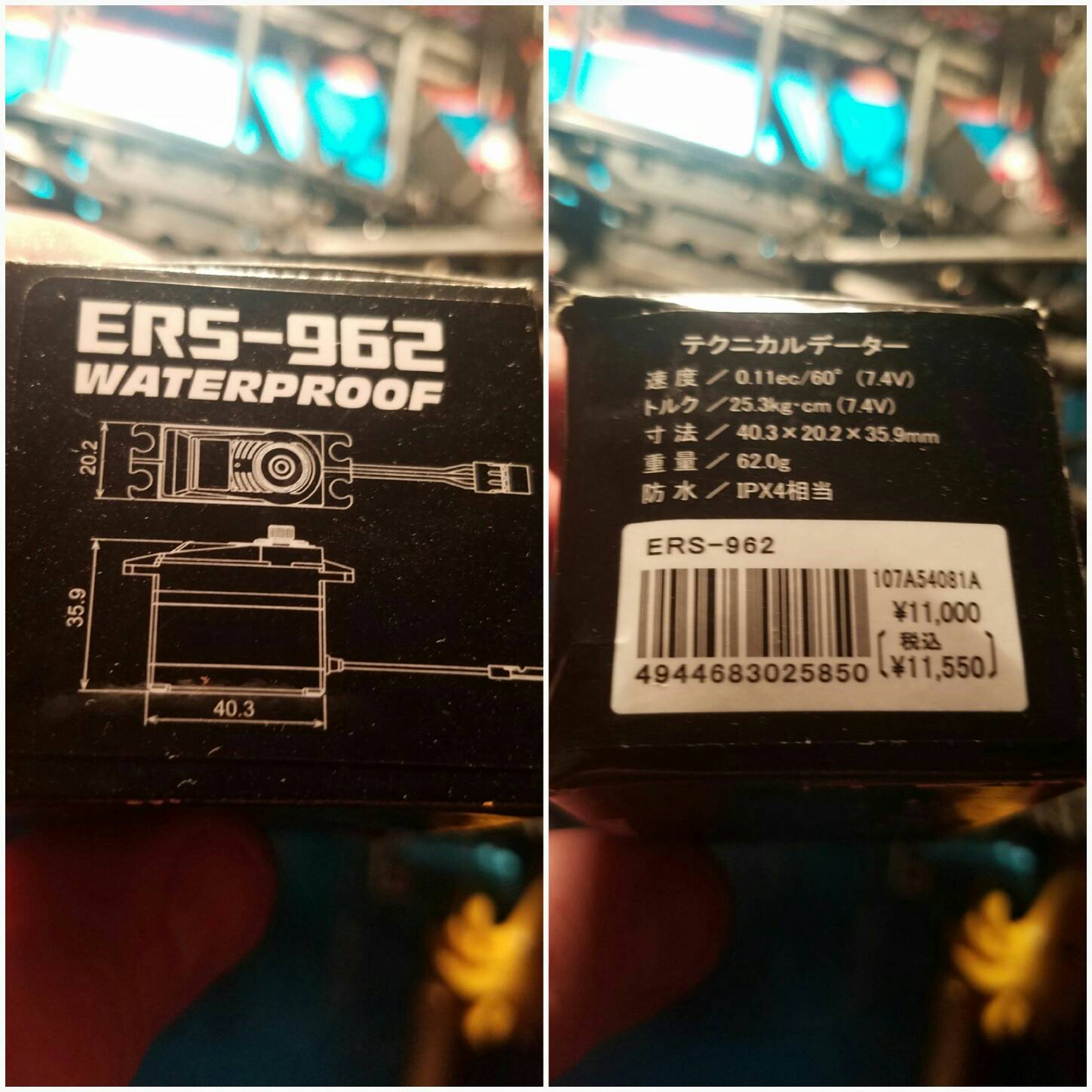

that servo is very slow and under powered. 277oz of torque is barely going to move the wheels if/when wedged
this is what I'm using, was about $100 and can be run at 8.4v
this is what I'm using, was about $100 and can be run at 8.4v]
that servo shows 277 at 6v and is rated for 7.4v max. It will make more than the 277 at 7.4v..... my power hd servos are similar specs and have absolutely no trouble turning the wheels when bound.....for a 1.9 based rig you dont need a huge pricey servo to do the job. The speed is fine as well, i dont want my servo flopping my wheels around so fast that it hammers my knuckles against the chubs and beats my u-joints all to hell....
