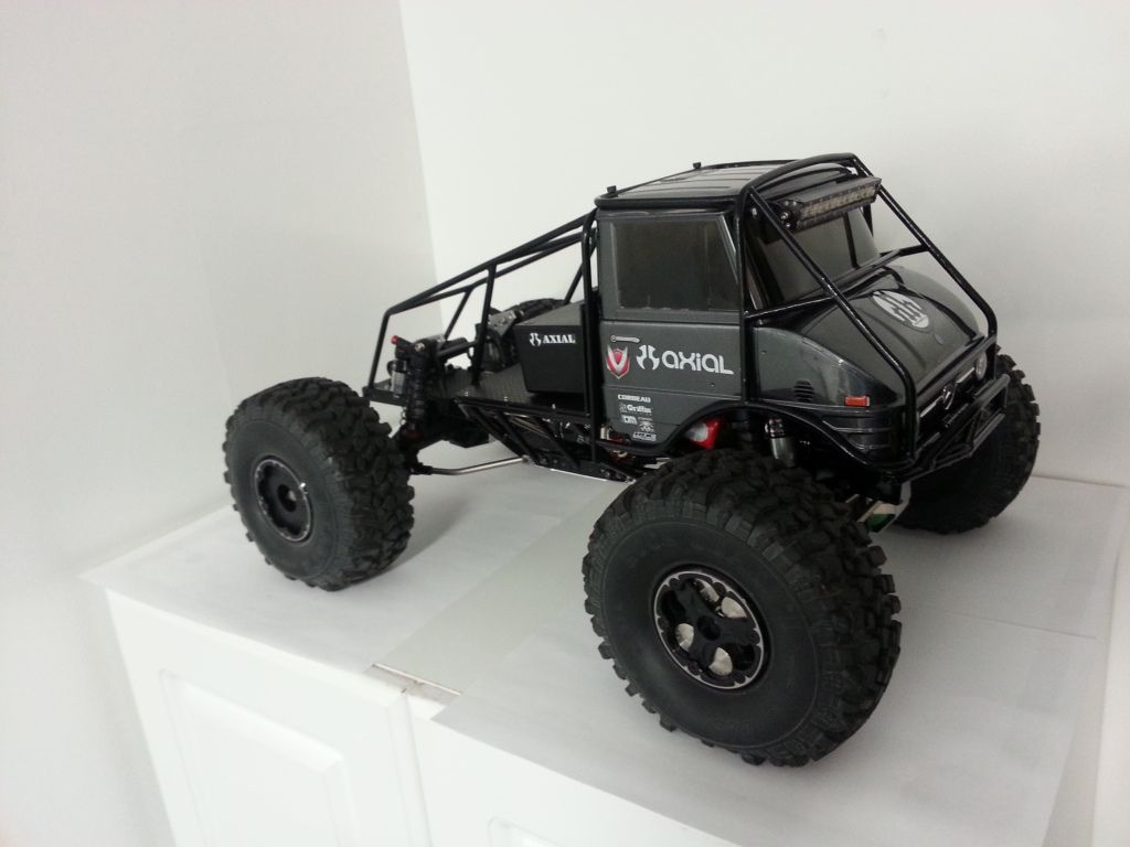

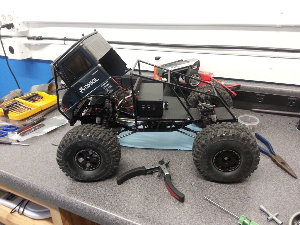

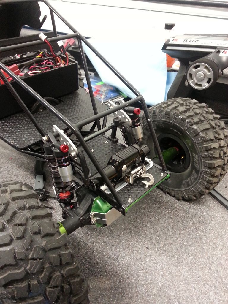

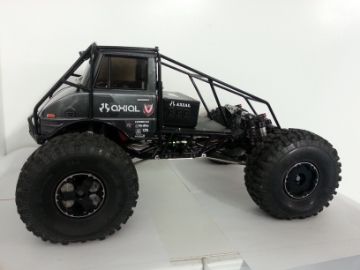

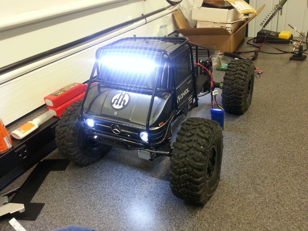

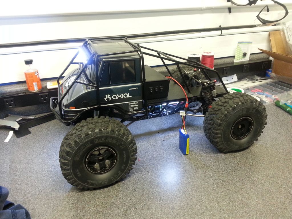

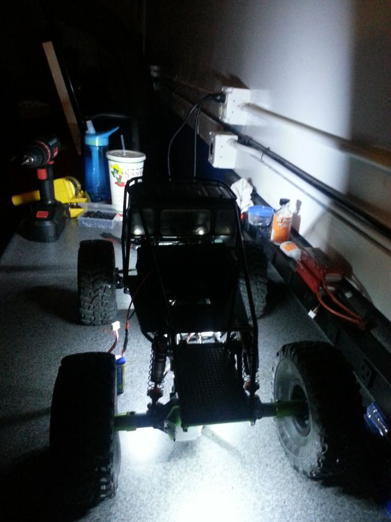

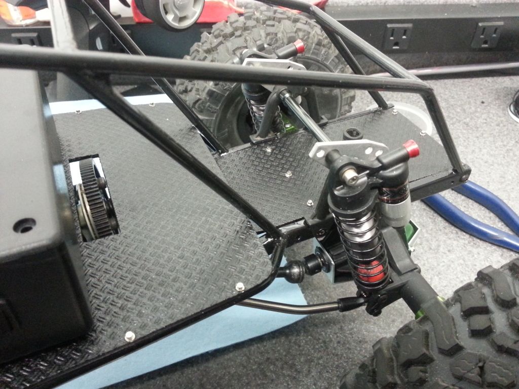

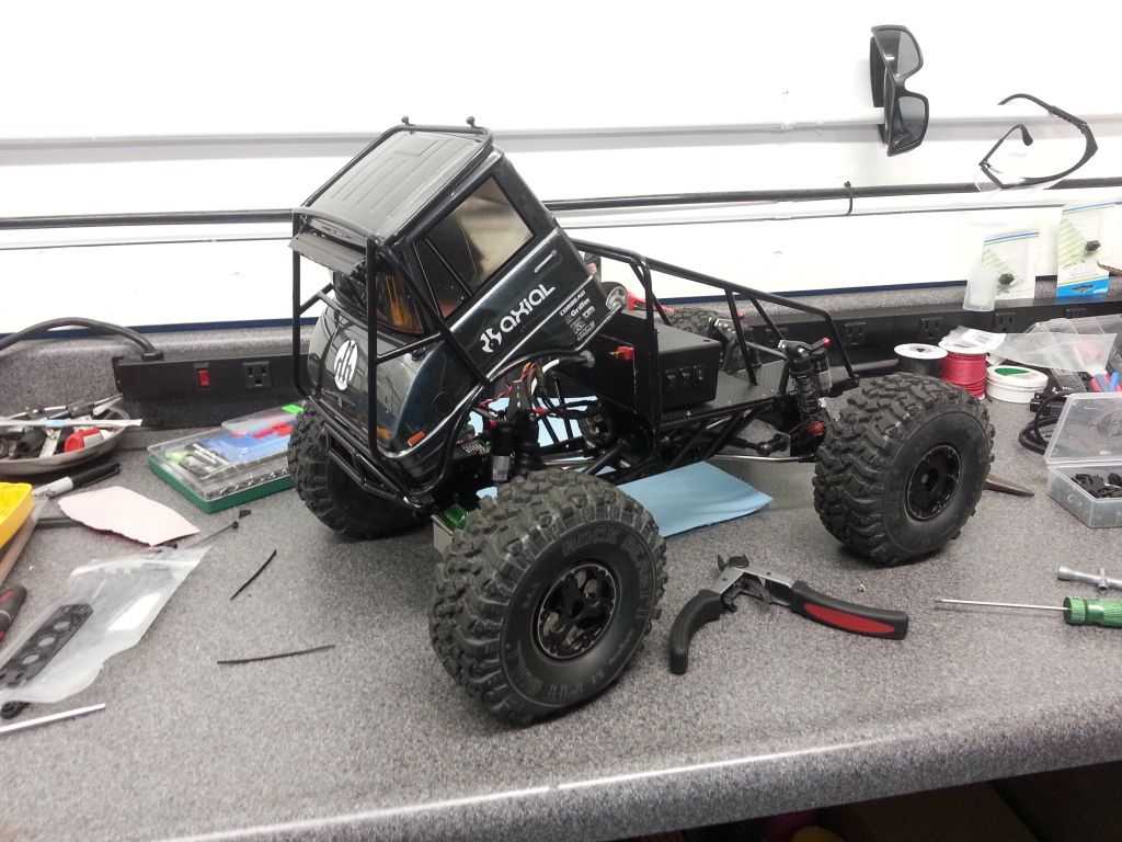

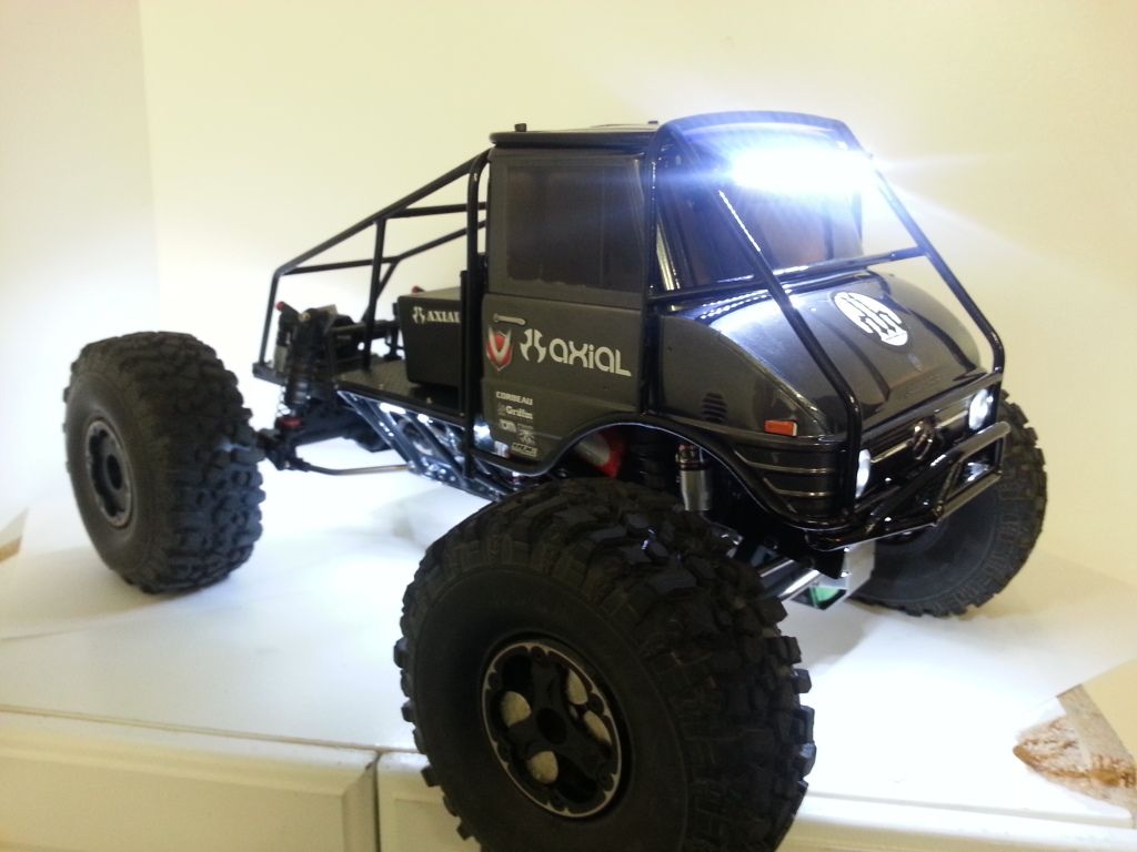

Did i mention its a forward cab? designed it this way to access batteries and plugs easier. It pivots forward on the front bumper brackets. Getting closer to finishing. Still have to do a little electrical, a bracket for the rear winch and some tuning on the steering and link setup (realized this after taking it for its first short test drive down the dock today).
Not happy with link setup, getting bad bump steer and Shocks need thicker oil. thinking about relocating the upper links. Still got some kinks to work out...in the mean time here are some current pics. still have some more scale details to add yet but trying to get the truck mechanically sound first.
GDamn that thing is SEXY!!!! I friggin' LOVE it!!! I hope that you show some killer insane working videos or pics of this rig climbing some KIND hillsides. I just want to touch the damn thing and call her baby/sweetheart! GREAT job....can't say enough good about it. Let's see it crawl!
"thumbsup""thumbsup""thumbsup"
I like it my man! I'll be watching the for sale section for this thing.
It could be the big brother to my 1.9 Mog.
I would like to see it in action though. Hope ya get around to posting a video in the near future.
Haha thank you guys!, your positive comments only fuel my push to finish it. RockKook as for it being up on facebook i'm sorry to say its not buddy. As for the working videos...never planned on making any but with your requests I think ill definitely try to make something half decent of its first run in the wild. expect lots of pictures, Going to try and finish by this Friday and take it on its first run.:mrgreen:

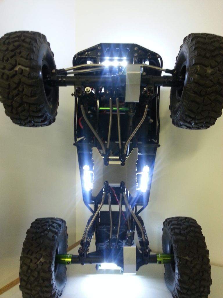

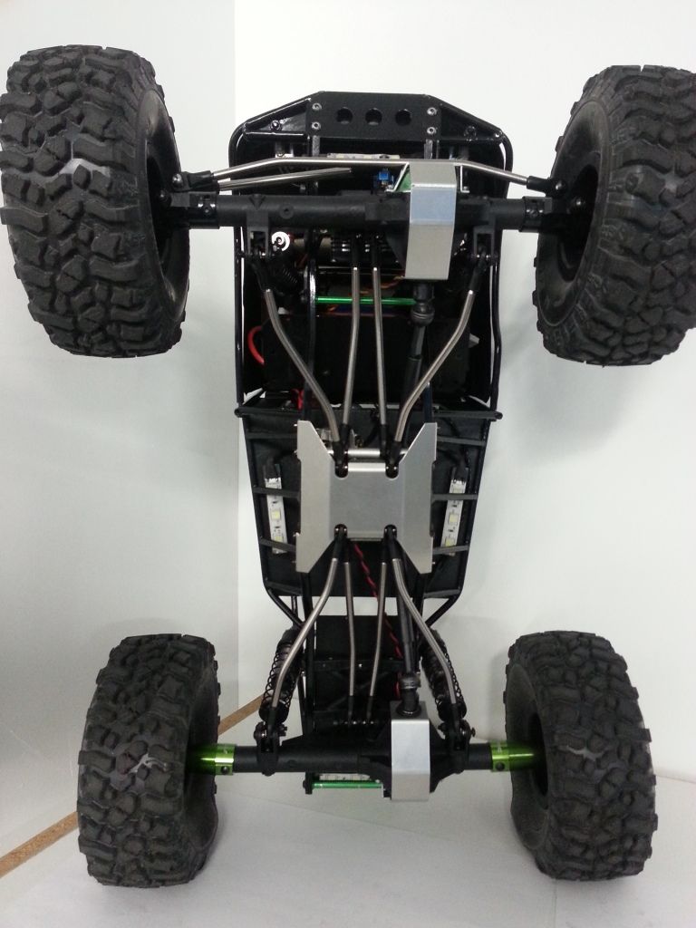

Decided to strip my honcho down and build something different, a Honcho at birth and a Wroncho Unimog when finished. Ive never brazed a chassis before or rebuilt a RC from the ground up. But i will give it my all anyways. I will Update the build as i go, Enjoy !
Build Parts
Gmade XD 103mm shocks
VP light bar
Robinson Racing hardened steel trans gears
aluminium transmission case
RR bearing kit
junfac drive shafts
CCBEC
Hacked 8channel fly sky
BRXL with Torquemaster pro 35t
2.2 Pit bulls
crawler innovations foams
Hitec HS-7950
VP links/knuckles

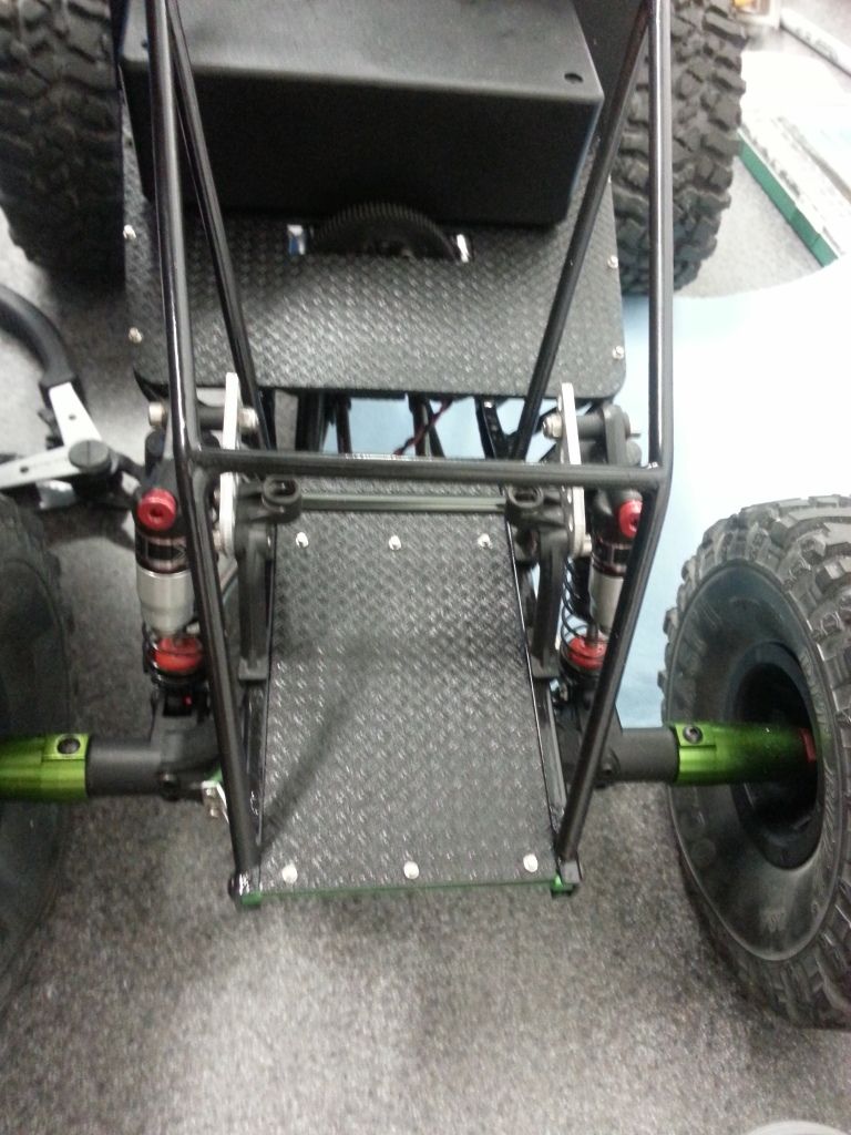

I wanted the Color scheme to be black and green. So started with some wraith axles and some Green HR Links (Soon after found out they were a waste of money and broke before they even got used) Put some VP links on order...wish they came in colors but oh well, i hear they're tough. "thumbsup"
