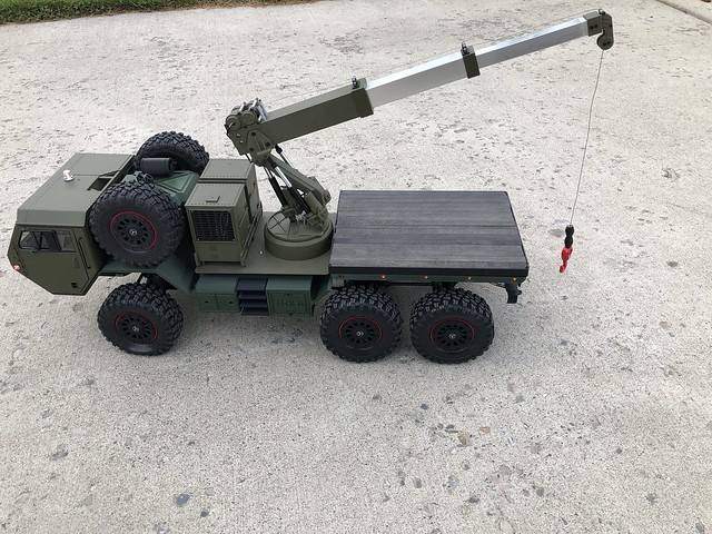

Well, just about done with this. I just need to figure out something for a back bumper. I also want to come up with some way to add weight to the crane hook, until I have about nine or so inches of line out, it does not have enough weight to go down on its own.
The boom extension on this crane is painfully slow, so I did not extend it for the video, but it works.
https://www.youtube.com/watch?v=Hi2awN5j2Us
I have added weights to the hook, and now it goes down on its own accord. I am not thrilled about the look, but it will do for now. I need need to come up with a hook keeper so that it does not beat the crap out of the rest of the truck when the truck is in motion.

Truly a Fantastic Build.
Love the crane, how ya got it all to work and hide the Electronics.
Even the 1:1 cranes got weighted hooks.

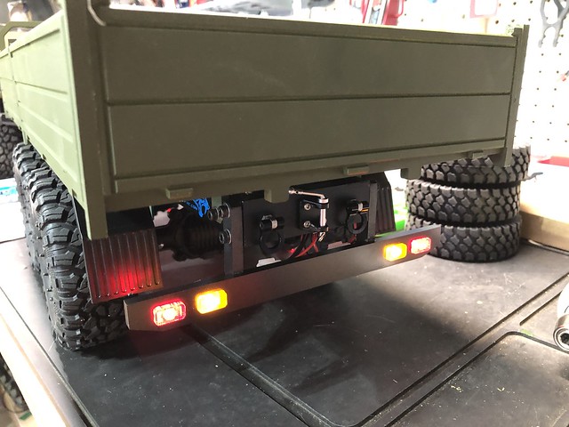

A night's worth of printing, along with some soldering and the back bumper is none. At this point, the only thing that I really need to do to put a fork in this thing is to make a cover for the battery tray.
Untitled by Scott O, on Flickr
