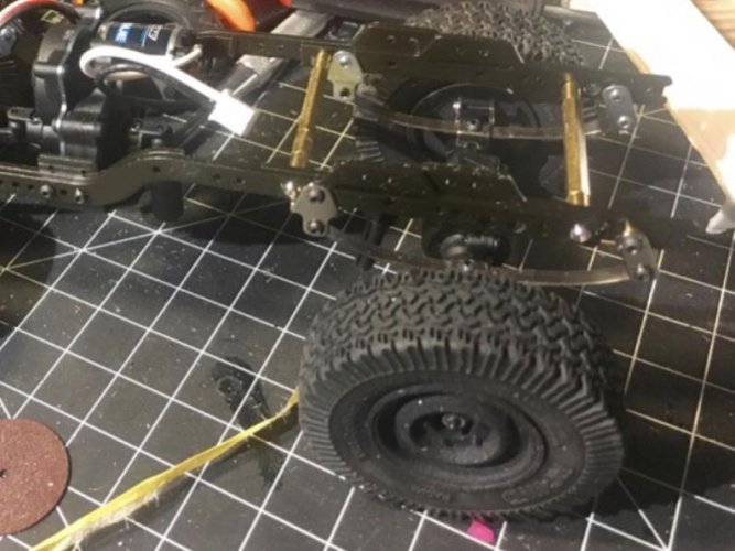

And yesterday it arrived and I started to cut
It fits perfectly on the battery
I need to cut the bed to adjust the wheel base
And after glue and sand it
I don’t want to cut the bed to get down the body. For me it’s perfect. Even I think I can make the interior with a little bit of styrene
It would have looked better, and been easier if you extended the frame instead of cut the body. It’s easily done by cutting one of the dual frame plates. I did it for my 1:20 Toyota.
