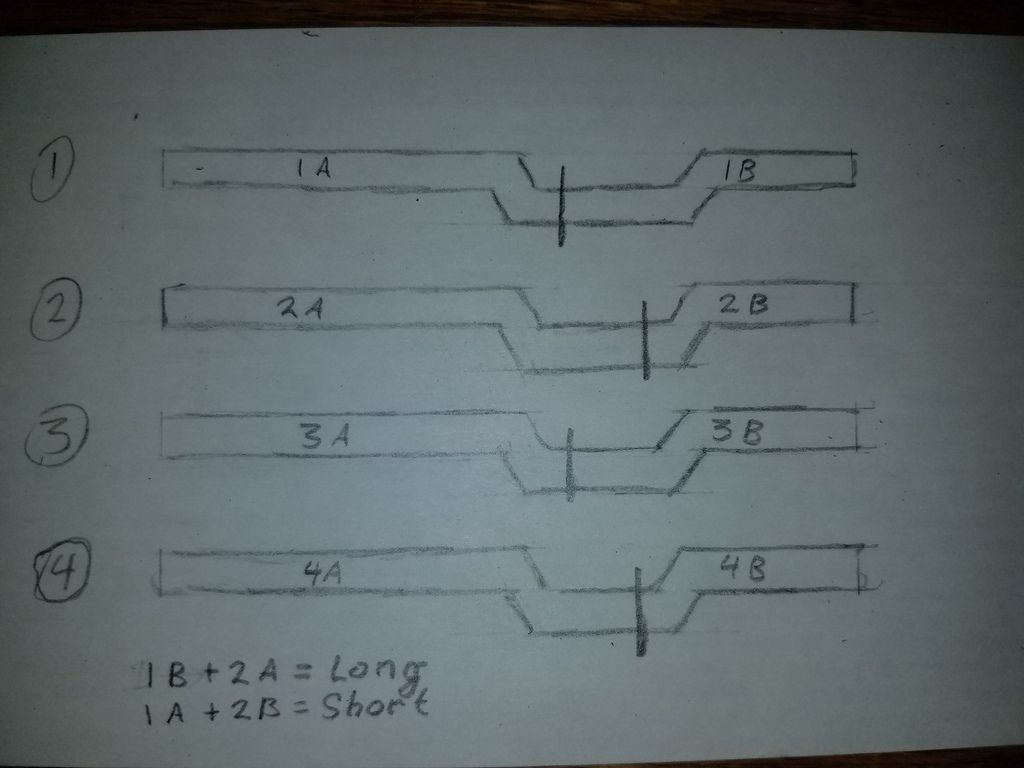

The frame rails being 4 parts made extending the wheelbase pretty simple. Cut in two different places and bolt the longer bits together. I filled the gap with a bit of aluminum stock and used some 2mm bolts I had on hand.

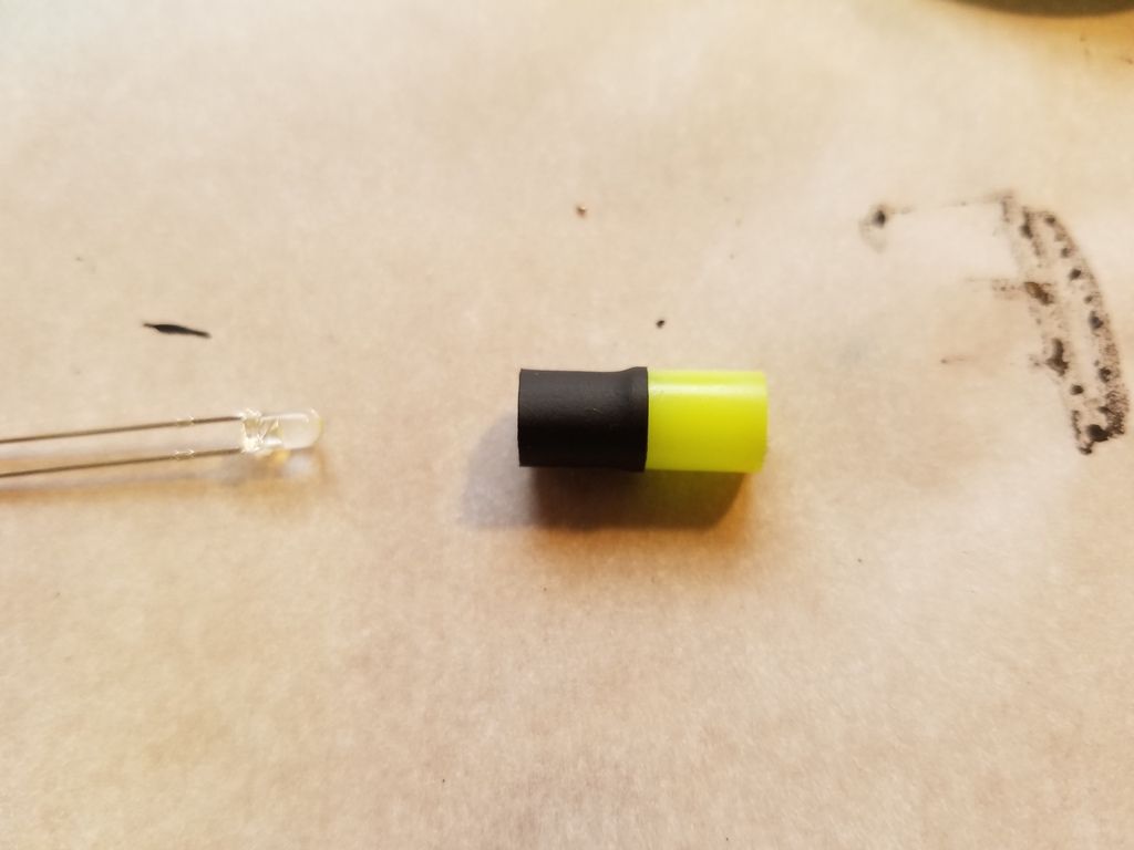

The grill came pained chrome and had some really shallow buckets already. I drilled a hole for the LEDs and used shrink tubing to stop the light bleed. I fogged the lenses a bit so it defuses the light well.

So I ran with the idea of shrink tube for light buckets. Force the bell shape. I tried hot glue to secure the LEDs and make the lenses at first, but it warped the shrink tube. I went with some 15 min epoxy next. Its a bit yellow, but should add some warmth to the white LEDs.
I'll see how they work once the epoxy cures.

This epoxy was already pretty old, so it's started pretty yellow lol. I'm going to need to wire them 2s2p, once I figure that out I'll post a photo. I did test one and I was pretty happy with the color.
