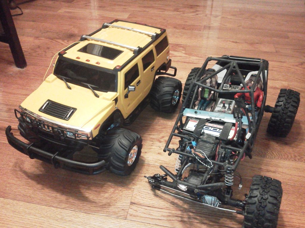

Hey guys I got some new updates! I went to a children's consignment sale with my wife and daughter yesterday and I got this Hummer RC vehicle. Has no batt or remote but only $5. The body is in great shape.

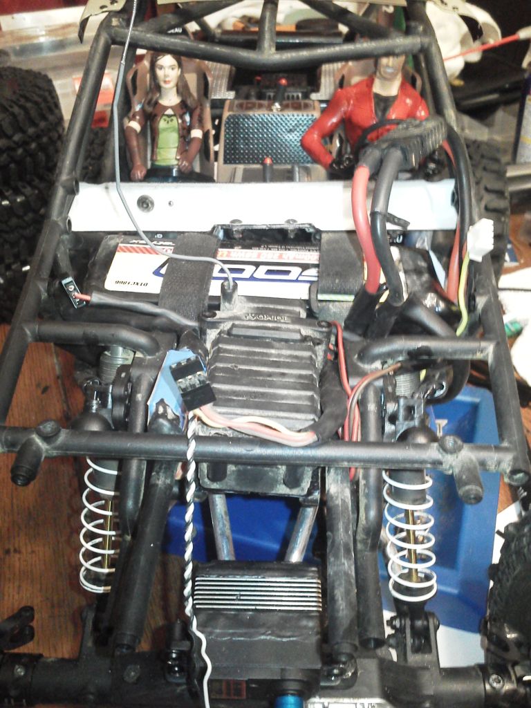

Also thought I'd send a pic of my front under hood wiring
There is a lot of wiring in this girl now. Feels like it weighs several more pounds .

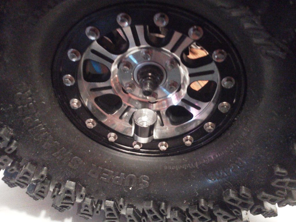

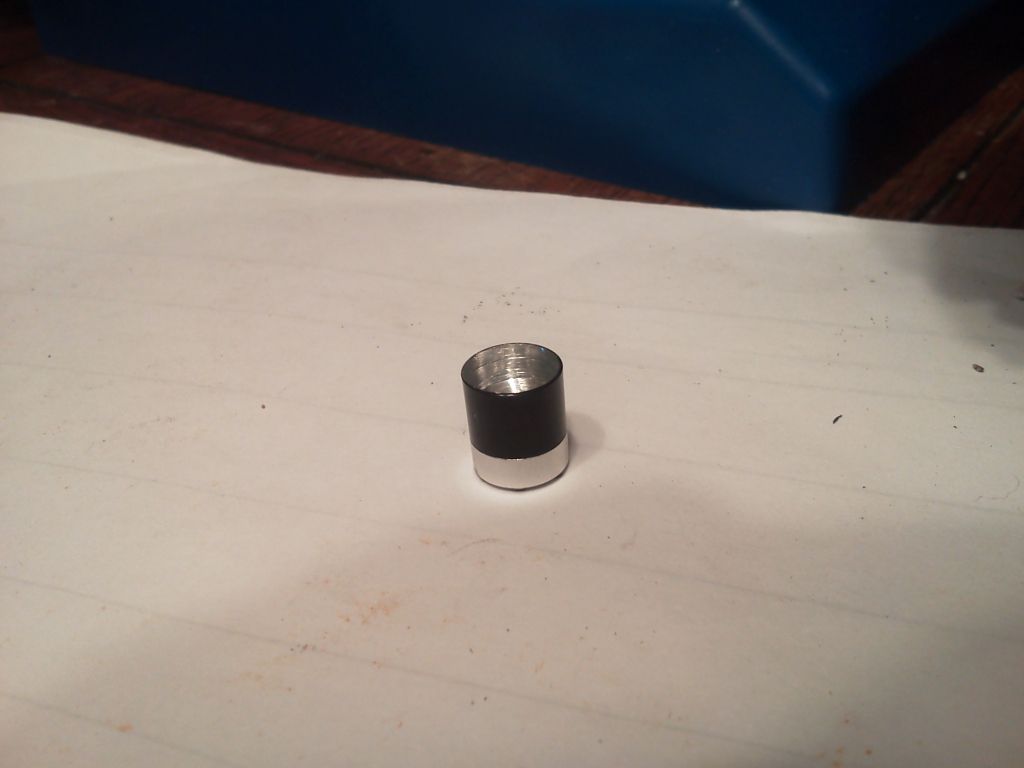

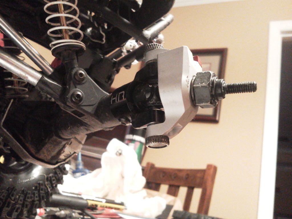

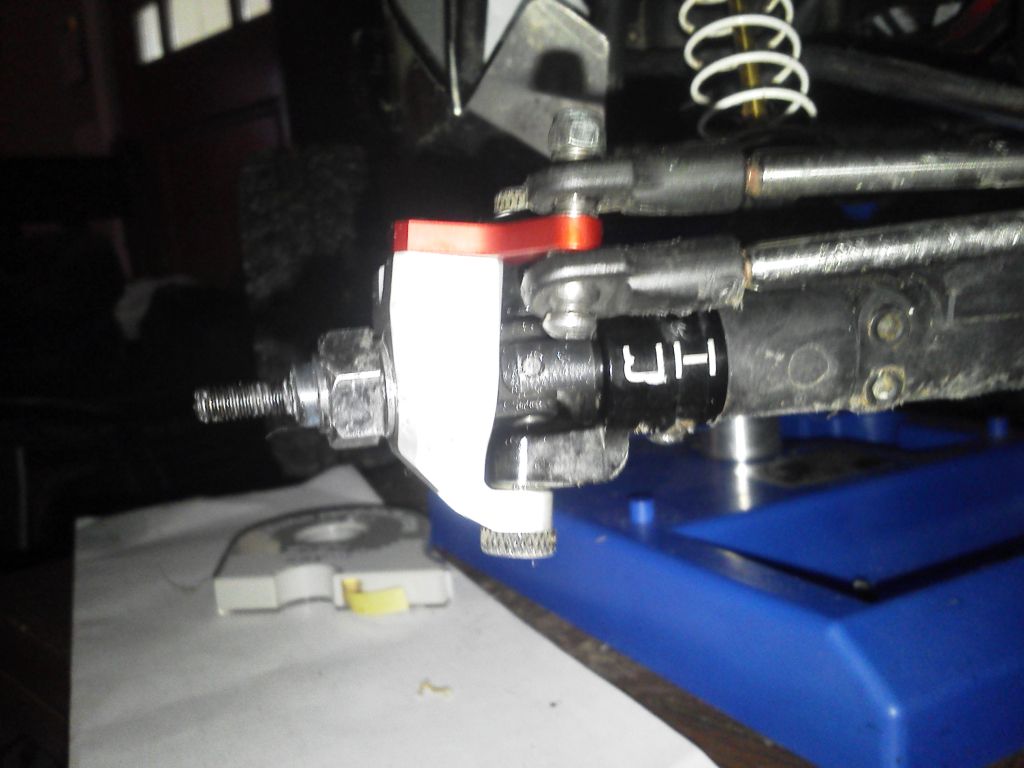

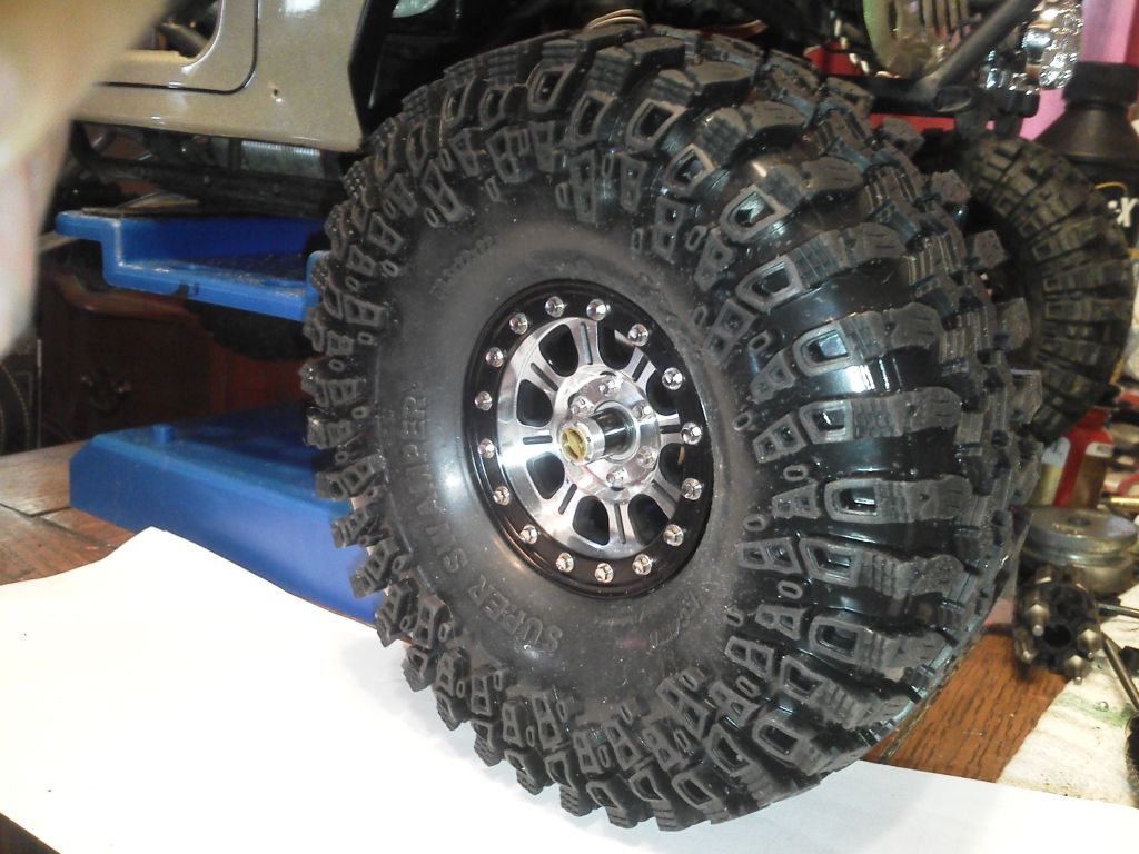

Also the scale rc4wd hubs are horrible about backing off even with loctite. So you can put the regular nuts on first and then the hubs on and it works great but with these new wheels it looks stupid.
So I took a 5/16 drill bit and drilled the rc4wd hub out to go over the outside of the factory wheel nut.
Works great!!!

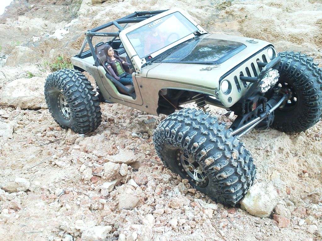

And some outdoor pics, the head and taillights turned out great!
I actually used my little round original lights as taillights and shoo goo'd them to the inside of the body! You can see a close up of the headlights earlier in this post. The shoo goo is clear although it can get little bubbles in it. But you can't see them with the lights on "thumbsup"
wow looks great! I dig those wheels!! so how do you like the rc4wd swampers compared to the proline swampers? they look to be taller, are they softer compound aswell?

Thank you lkracer, I agree, I am very happy with how she turned out too. I love the new wheels and tires. It was hard getting the tires out of the plastic bag they were in due to them being soo sticky! I haven't had a real good run with them yet but I do have a small rock course in the back yard and they did great! The swampers were super sticky too. While it seems they have lost a little stickiness, they still do great too. I'd say they are about equal when new. They are taller by half an inch or so!

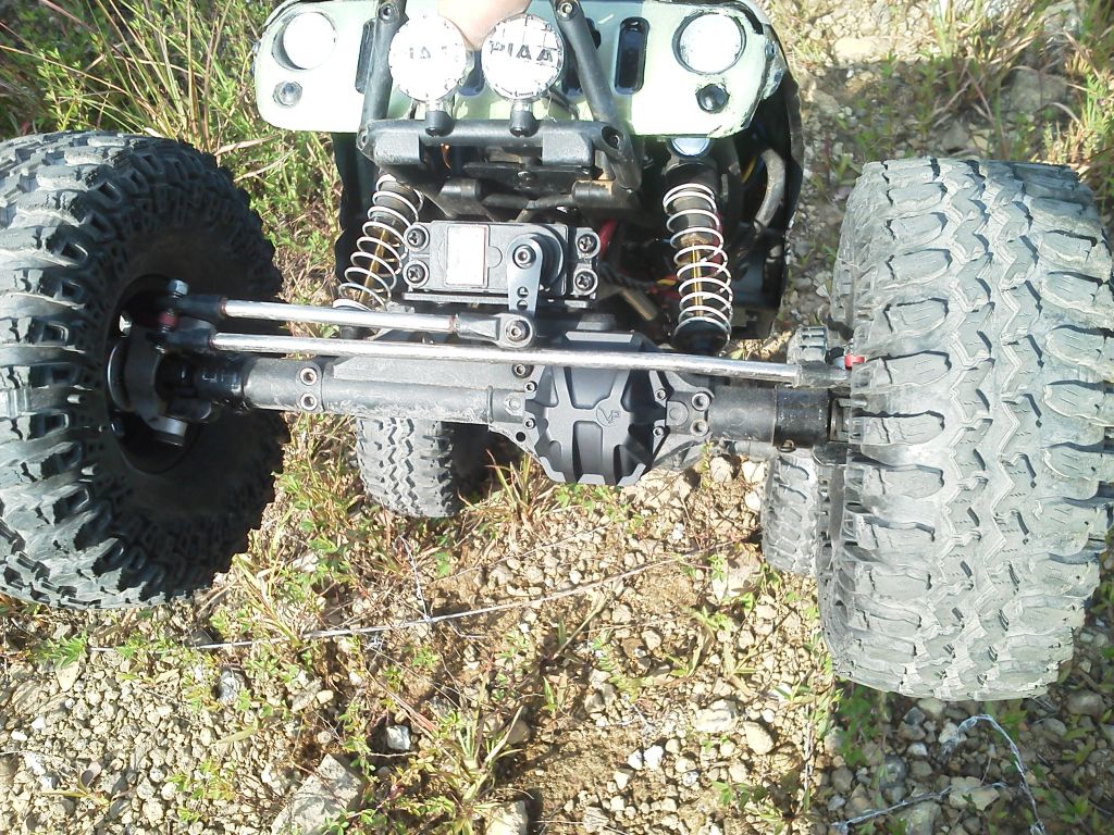

Small update, I have had a more than acceptable amount of play at my front wheels. Looking closely at this issue I noticed that there was some slack outside of the bearing in between it and my HR brand knuckles (outer c ) as well as play in the bearing too. So I picked up some vanquish Knuckles and installed them on to my HR inner C's
Now this cured 90% of my play issues until I drove it for about 15 min and it seems that half the play is back. I hate this but appearantly am going to have to live with it unless anyone else has an answer!
is it in the bearing bore? is the bearing loose inside the knuckle? if so a tiny bit of rtv silicone around the outer race of the bearing may help. will basically be glueing the bearing into the bore but should should still be able to disassemble if you ever need to replace the bearings. green loctite is made for this but i'm afraid you would destroy the knucke if you tried to get the bearing back out.
It could be that your wheels are coming loose because you are still using the stock wraith 12mm wheel hexes they only work with stock wraith wheels because of the little centering flange the sticks out witch does not let the wheel have a nice flat surface to mount against. I fought this for almost a year before i figured it out and now several outer crawlers that were having the same problem hope this helps.

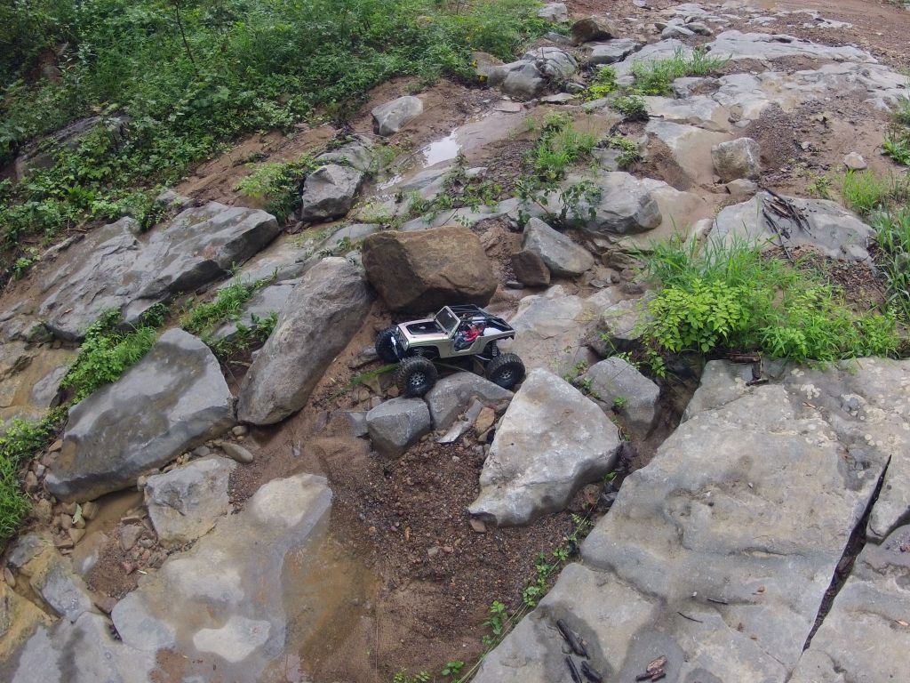

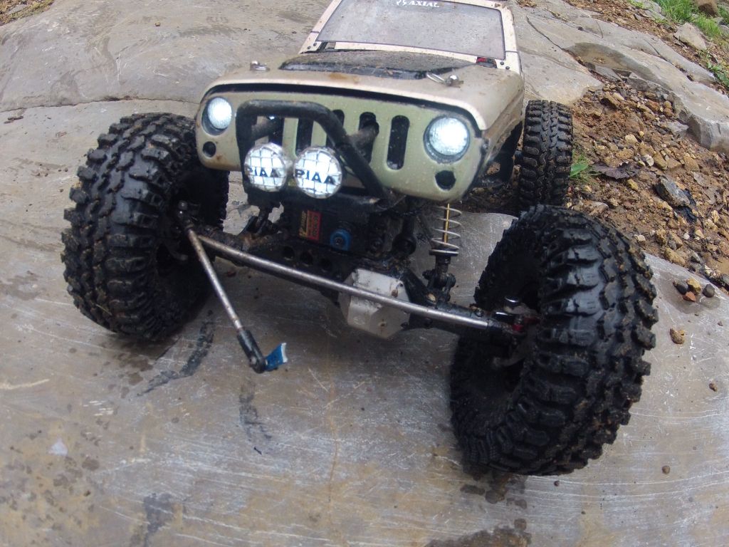

Took my new girl out for a day of play! Must say I love the new Iroks. It's wet here and they still did awesome. I'd say possibly stickier than the TSL's I was running before. She did great, the only thing I'd change is I wish it had a low gear for when I'm in heavy rocks. That should be solved soon when my rc4wd two speed tranny gets here this week. :mrgreen: anyways here is a few pics from today. I have a lot of video to go through and edit that I will post later. You can see how well the iroks do yourselves.
And one from a few days ago

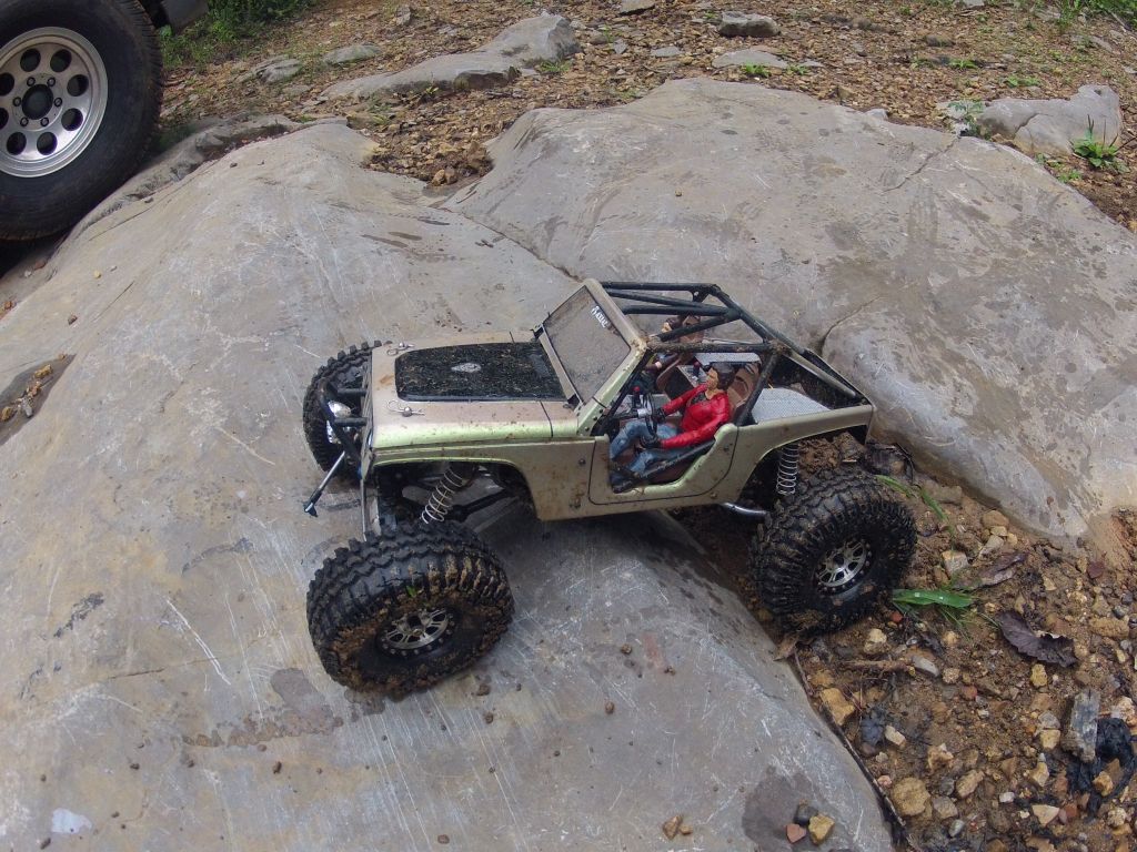

Some pics of today's run. New vp 3d covers thanks to Docs!
Some tire spinning action!

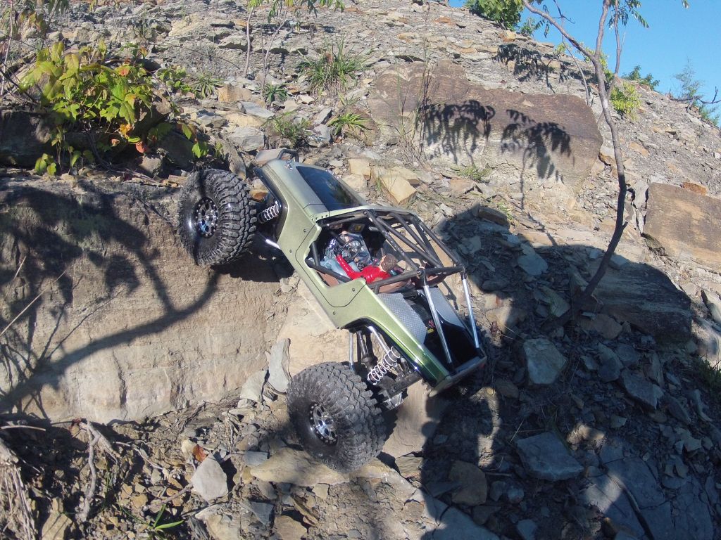

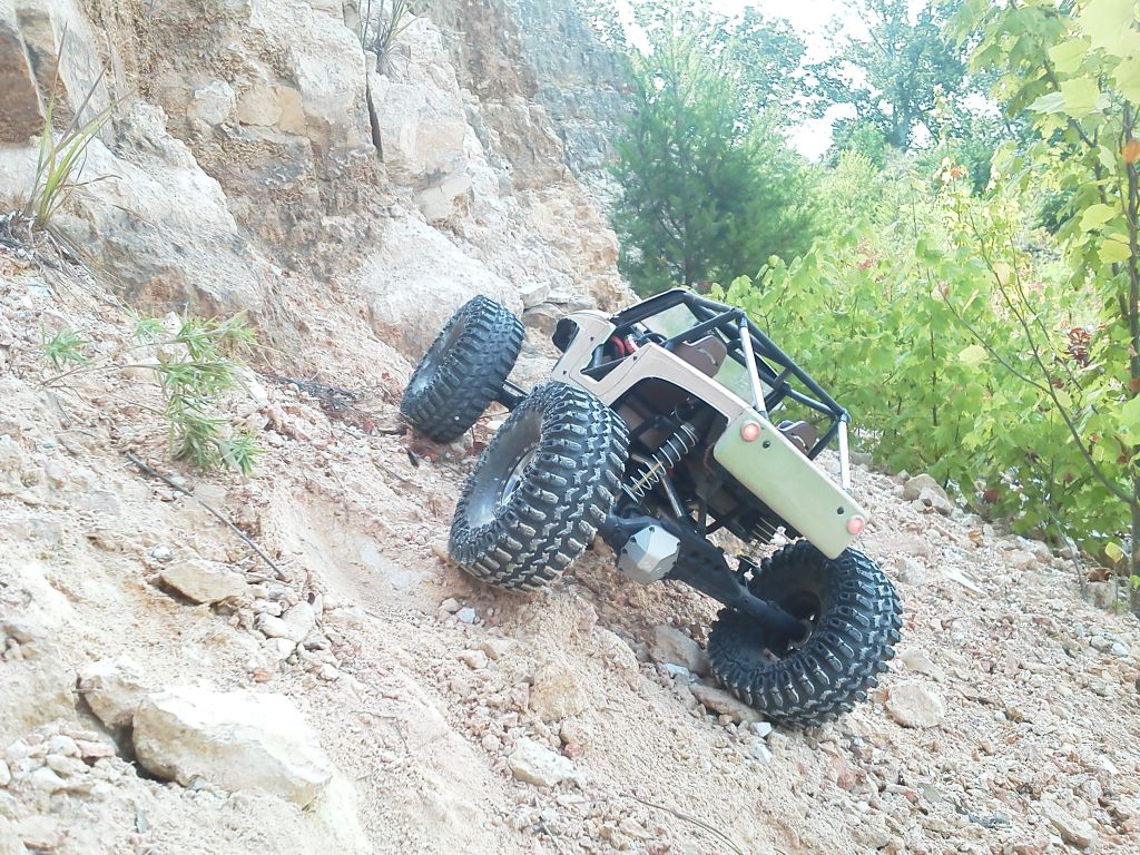

Hill climbing with these tires and front battery swap made a big difference.

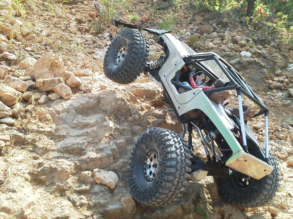

These tires side hill well. Look at the pass rear, this hill is steeper than the camera shows!
Hanging on by a tread! Lol the front tire is not in a hole, it's folding under due to how steep it is!

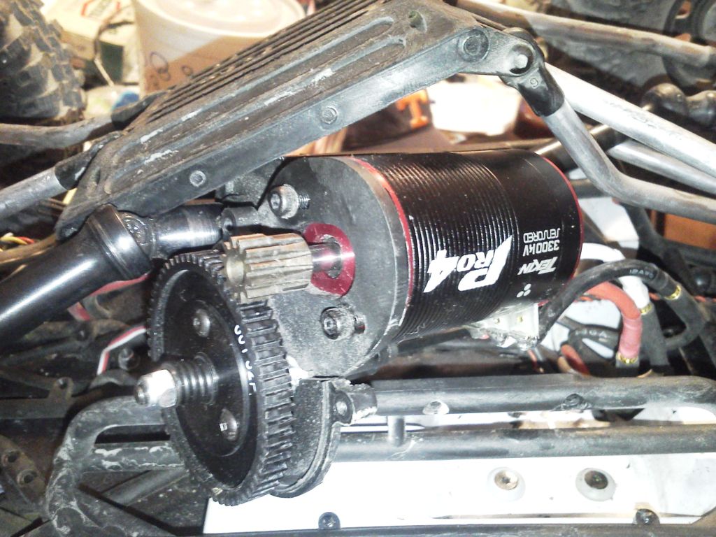

Well my Tekin 13.5 is not running right and is going back to Tekin for some warranty repairs and lord knows I have limited patience so I got this to use while it's out for repairs. You know just something to at least keep it rolling in the meantime :lmao:

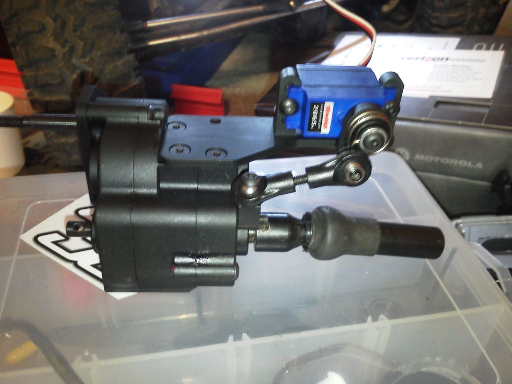

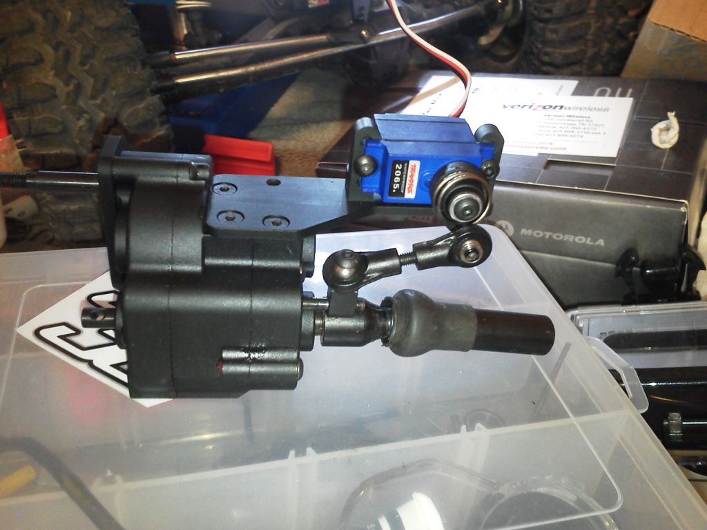

I am installing this with a twelve tooth pinion and the stock 60 tooth spur that came with the rc4wd 2 speed trans

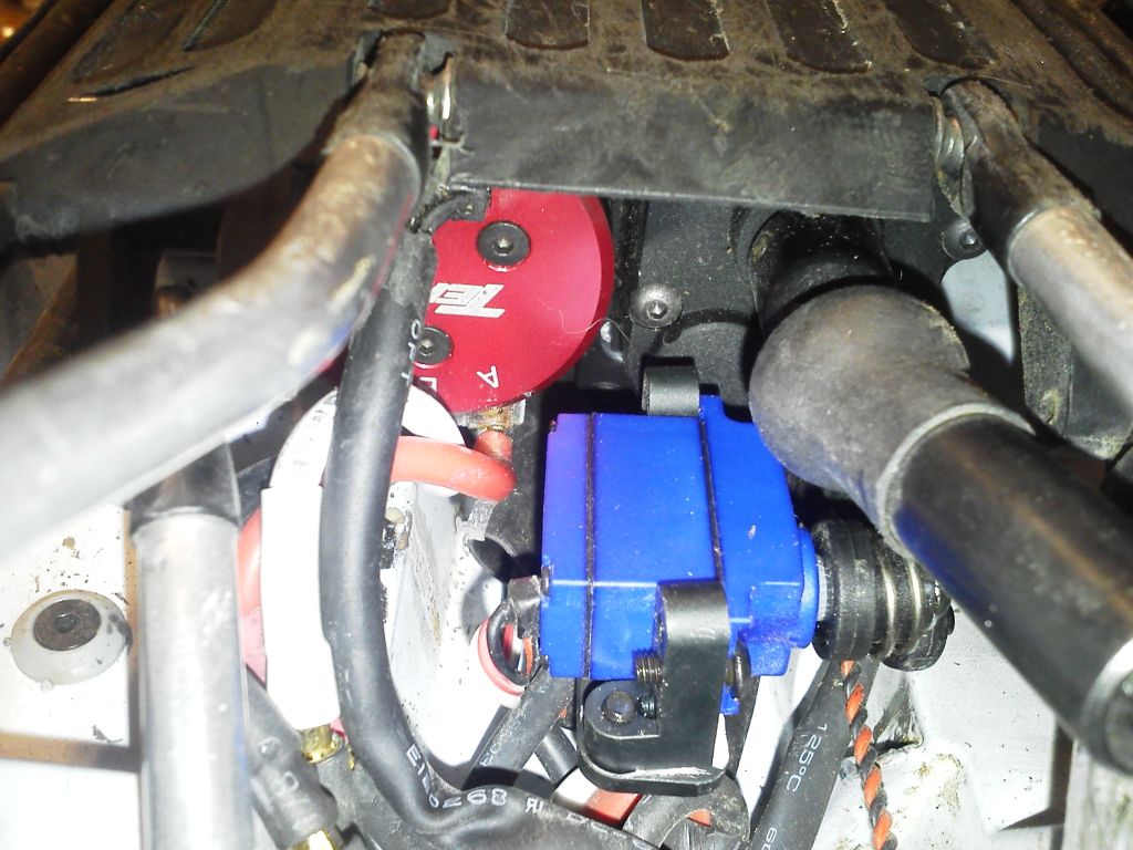

I also put my shifting servo under the rail on the trans instead of on top. Gives a lot more room on top of the trans for interior room and room for wiring.
By the way, I liked my Tekin 13.5 but my pro 4 with this transmission is crazy fast but is the best at crawling that it has ever been. I ran it today and yesterday for a long time and the motor never even got more than 120 degrees if even that warm. I'm in love with this drivetrain. If you want to know what would be good scratch that, awesome in a wraith then "save up" it's well worth it!
Works great!!!
