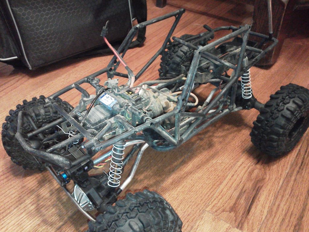

Hey guys I got in some parts for the Wraith and the work load basically meant tearing it all apart. I just put in a Tekin 13.5 and Robinson gears in my tranny. Now I'm doing a Dynamic Concepts Rubicon body in kryptonite gold with black flares. Im moving my big front lights to the headlight position, moving my small headlights to the taillight position since their round like the molds in the body which leaves the rectangular lights will be my new fog lights. While I'm at it I'm putting in a battery forward kit and moving my mmp out back in a new Dinkys drop box. Waterproofing the Mamba Max while I'm at it.

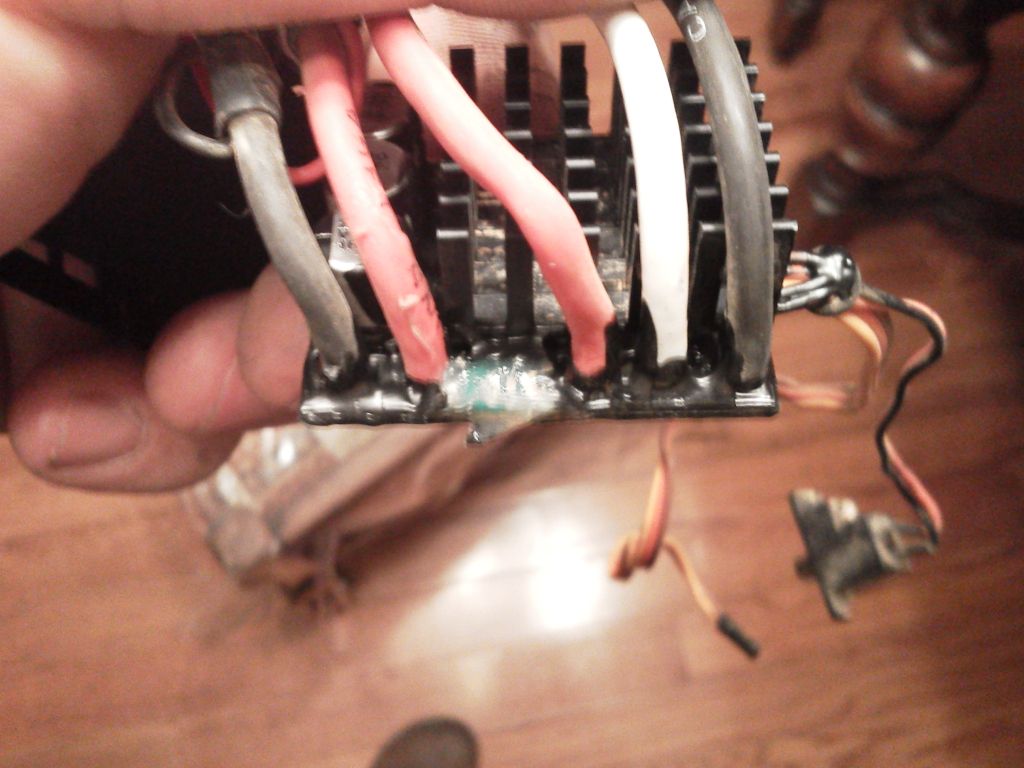

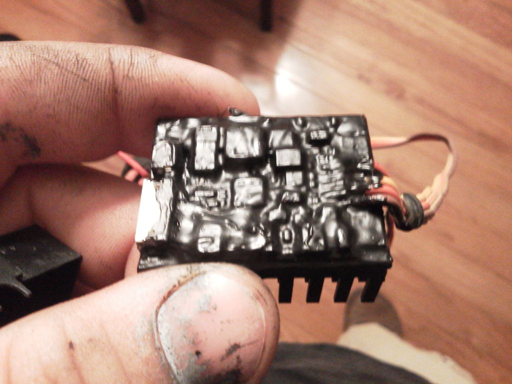

Waterproofing the mmp with clear silicone over the LEDs

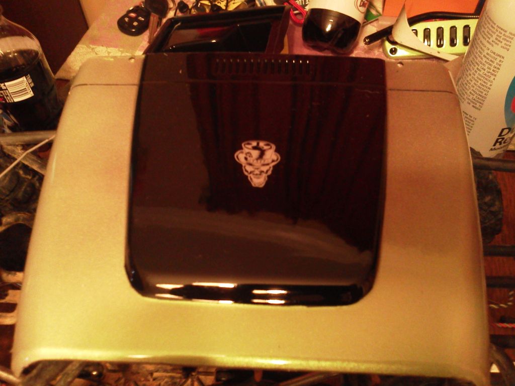

A pic of the hood. The sticker is under the lexan with the paint! Slick trick ;).
Is that all you are doing to waterproof the esc? I have the MMP also and was curious as to what all needs to be done to make it water resistant. Sweet build by the way.
Yep there are several YouTube videos on how to waterproof an esc. I'm doing liquid electrical tape because it is what I had on hand. Real easy to do. Here is a pic of the bottom.

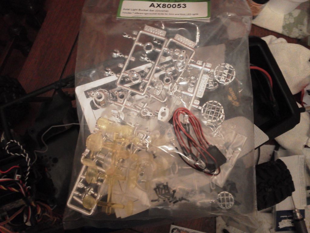

Well I got some more goodies tonight soo I guess it won't be finished tonight after all.
I picked up a losi night crawler rock light kit and a set of chrome axial light buckets and lenses

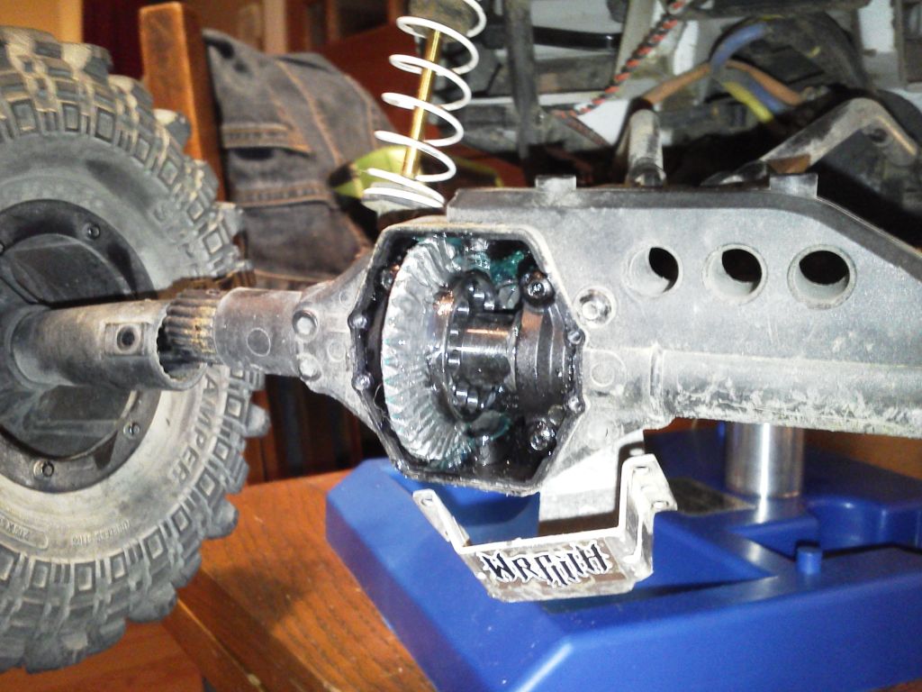

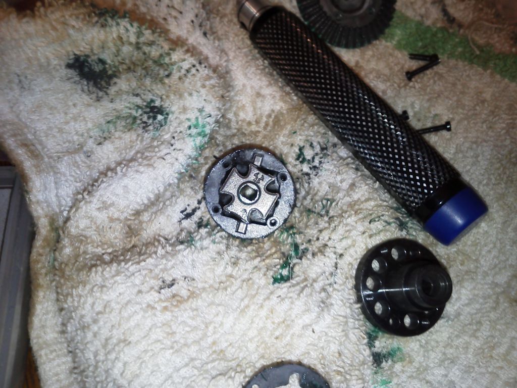

Also since my factory lockers can't take the power of the Tekin 13.5 . . .
I went ahead and installed front and rear HR steel lockers. By the way I have to say I really like these. They look well made.

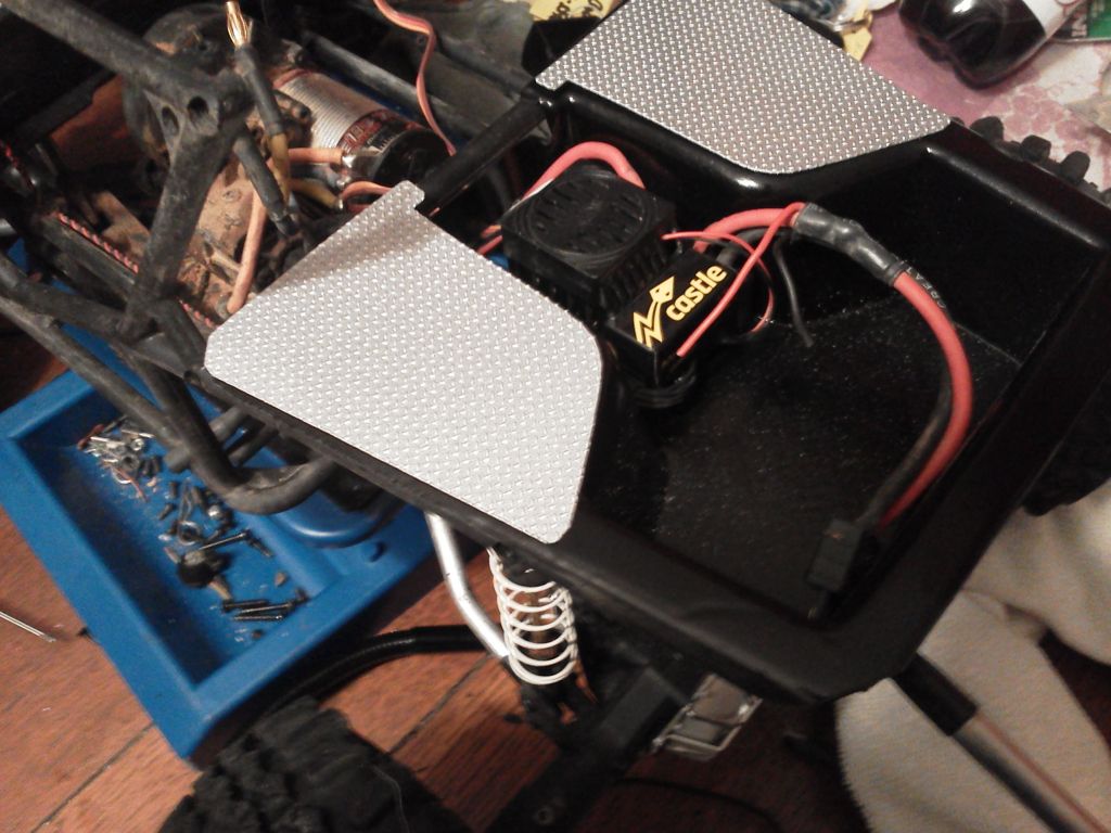

Also installed some styrene diamond plate on my dinky drop box.

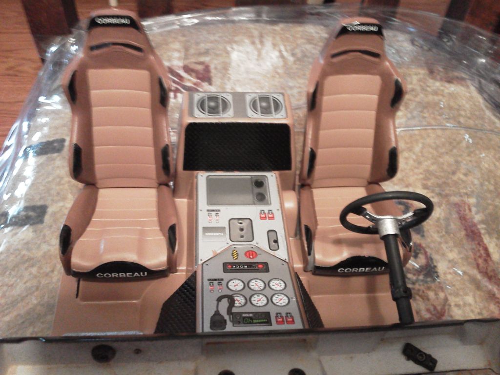

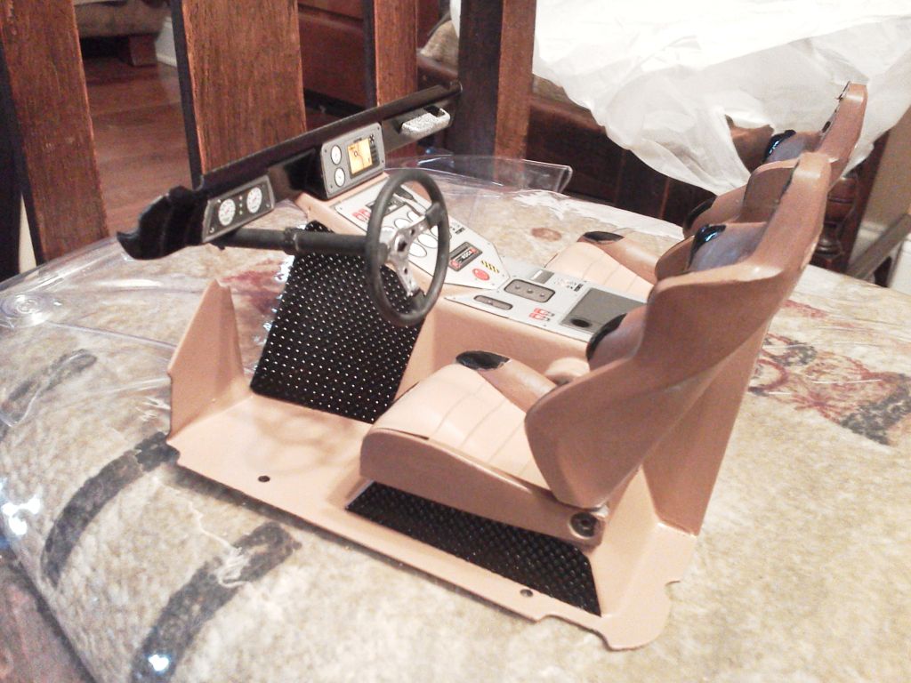

Ok so I got some more work done. I figured while this thing is apart, I would try and fix everything that bothers me. I couldn't find a good looking tan for the interior at the Lhs so I mixed my own with fascolor brown, white, and yellow (equal amounts of each, or close). I used that on the floor and center of the seats. I mixed in some more brown for the edge of the seats and cut some diamond plate and painted it black for the kick panels. Hope you guys like the way it came out!

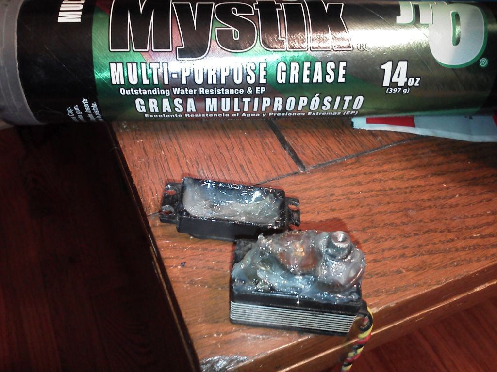

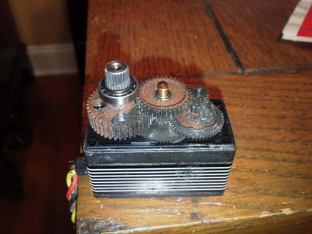

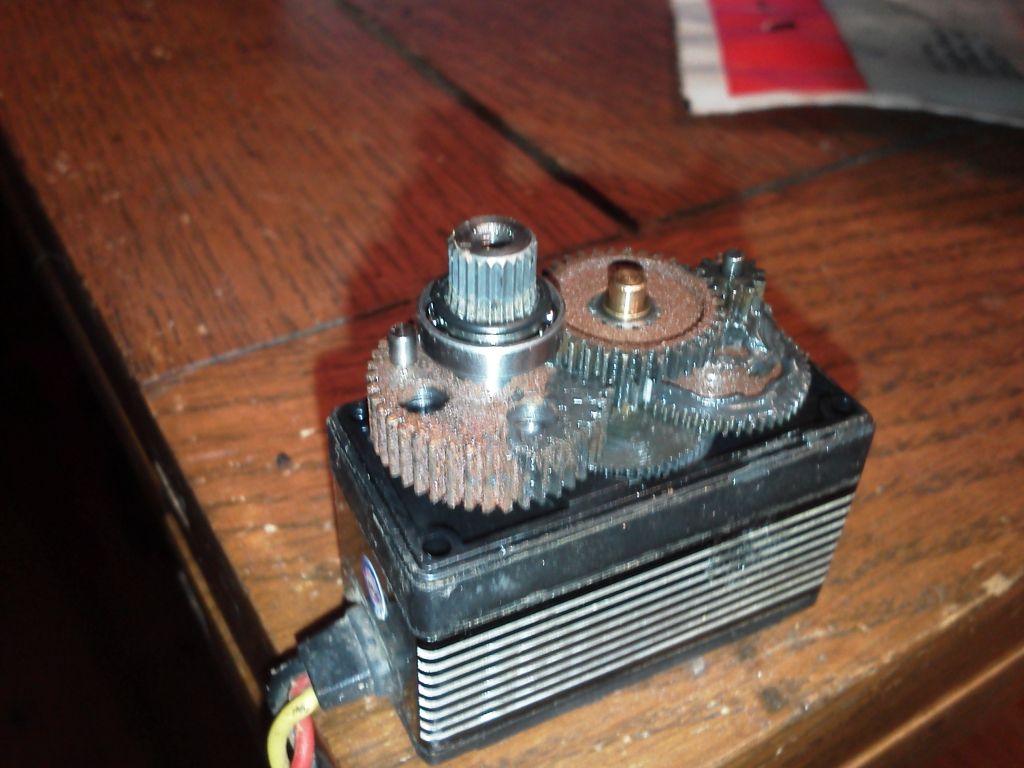

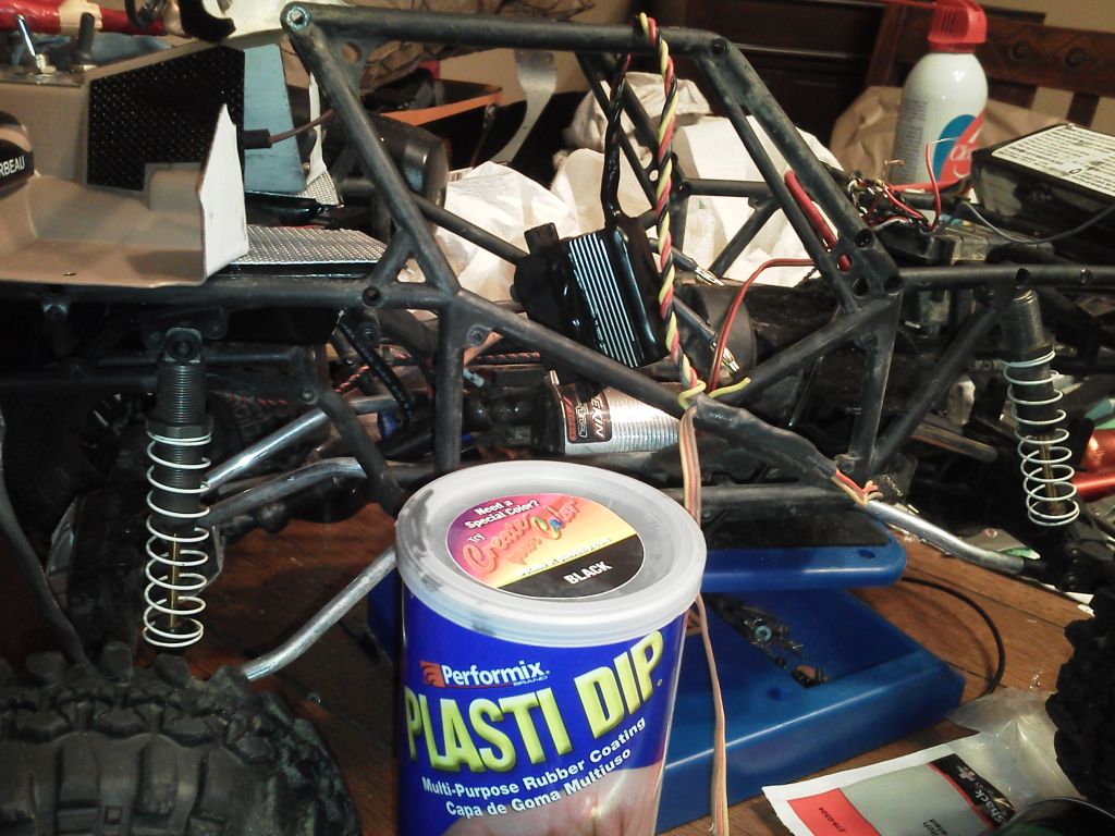

What's up fellow RCers ! I was stoked tonight. I found plasti-dip in the paint section at lowes. That stuff is cheaper than I thought. So when I got home I thought I'd pull my Hitec 7954 metal geared servo out and waterproof it using Medics methods. So I've been really careful up to this point not to submerge it. It has only been splashed with a little mud and of course some light waterhose action when cleaning. When I pulled it apart it had nice rubber seals all around. Although they hadn't done much.
This made me a little sick.
I went ahead and waterproof greased the mess out of it.
And I dipped the very bottom up to the heatsink in PlastiDip and put it around the upper case halves too

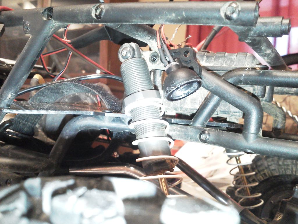

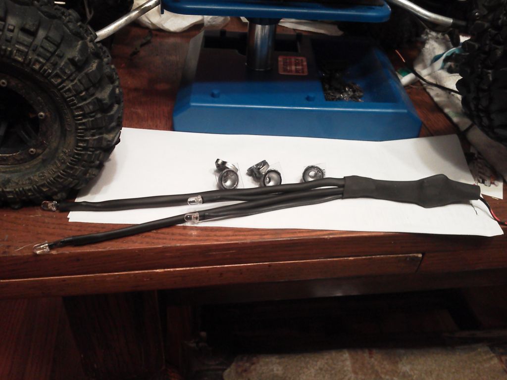

Ok so I got the losi night crawler light kit and it didn't come with any lenses to keep water and mud out of the lights. So I took some clear lexan and cut out some squares and shoo-goo'd them too the housings. Also plasti-dipped the losi light controller.
Then I protected the whole losi harness and all in shrink wrap
Then took a dremel to the left over plastic around the light housings and mounted them to the upper shock towers
(this pic is a test fit before I shrink wrapped)

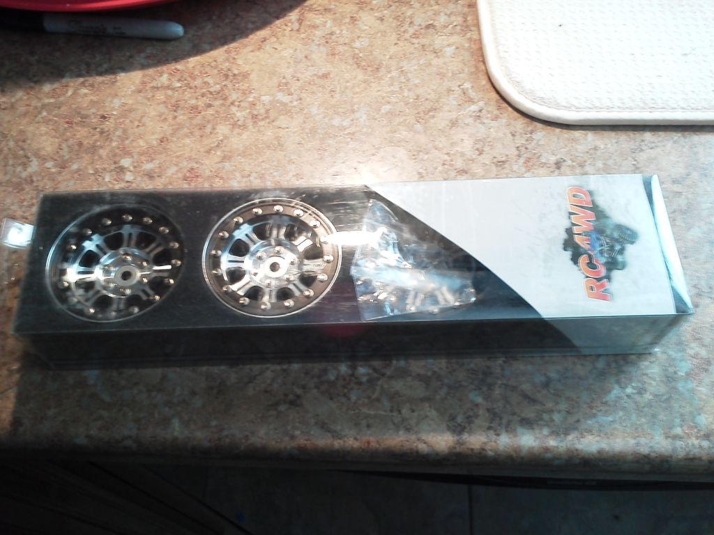

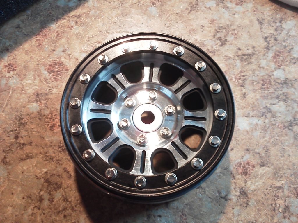

Ok, the wait is over, I almost died waiting on this package. You would figure that 45$ for shipping would take less than 12 days when it's in the same country. Also they never sent an email saying that they shipped. Ohh well off my sandbox. Here are the pics!
Pulled em out of the box!
Took one out of the package!

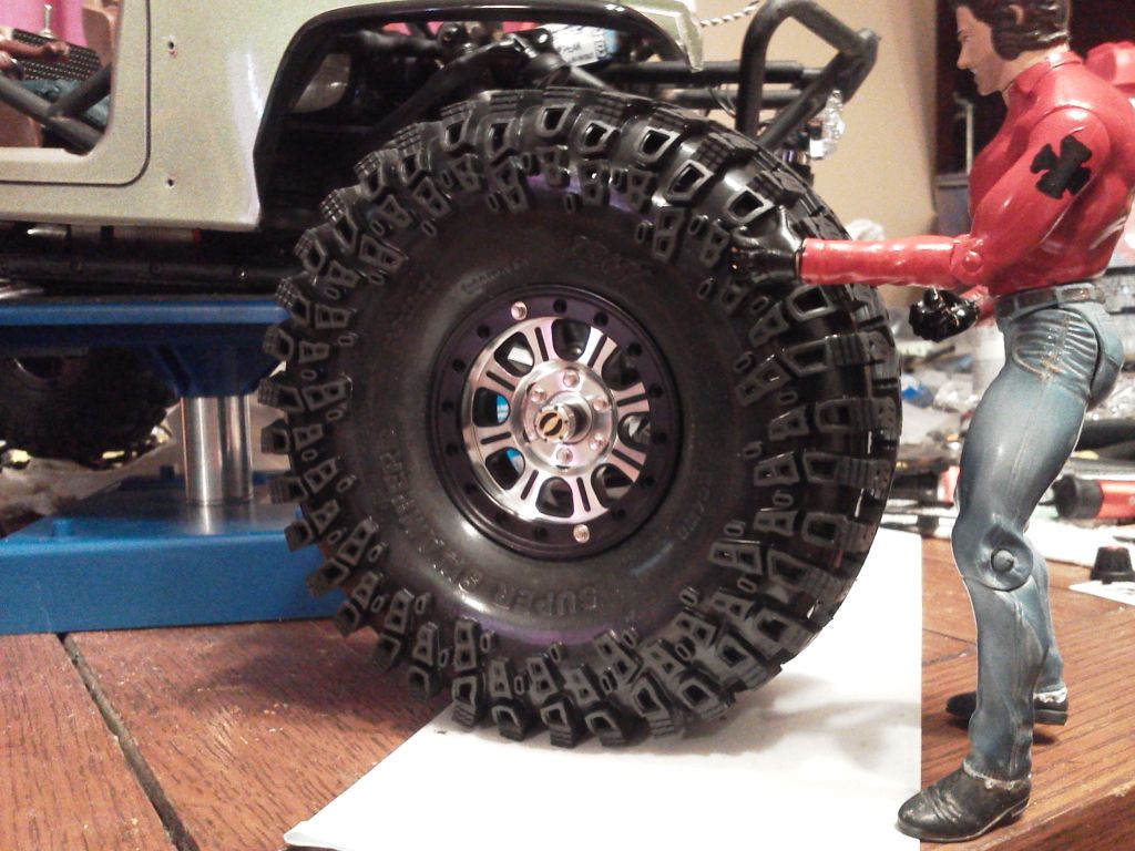

Man I love these wheels and tires!!! These are the most expensive RC wheels I have ever bought! Love em, but after pulling all the bolts and putting a small amount of antisieze on each one and reinstalling... WHEW !! I have to say there was no binding with any of the bolts. Nice scale hardware!
