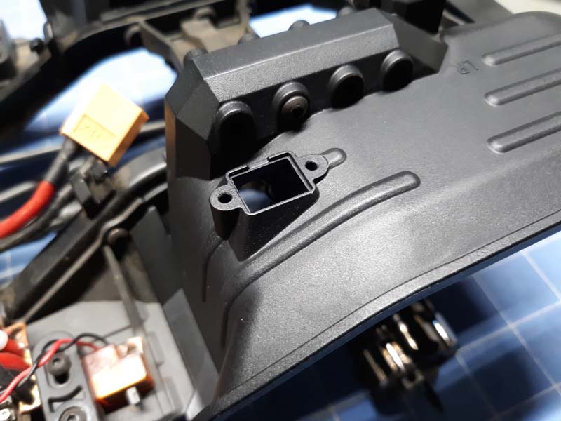

Goes quick, nice to have inner fenders again... They'll stay on regardless of body swaps in the future.
Traxxas doesn't include the light covers, they are sold separate. Really? C'mon, that's really nickel and diming.

@OSRC, if you need the rocklight covers I can print you some and send them. I had the same issue and 3D new ones.
