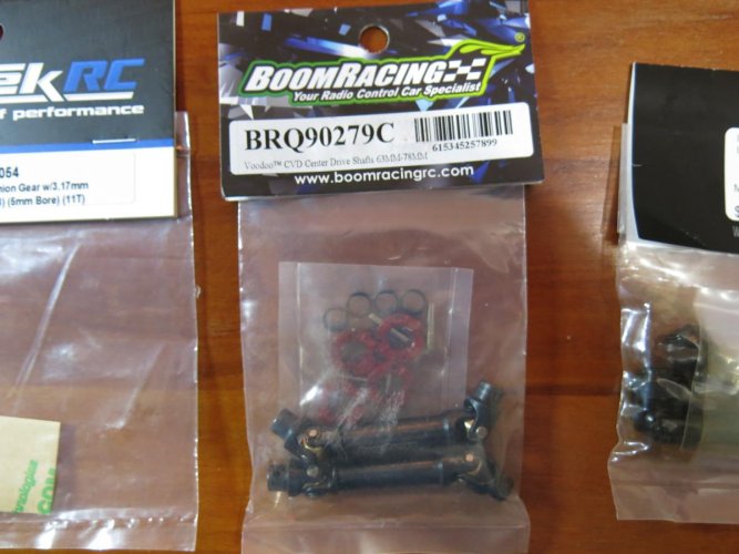

Looks like you have most everything you need except driveshafts you will need 3 one from the motor to the trans and then front/rear axles here is what I got !!!! BUZZZZ....
