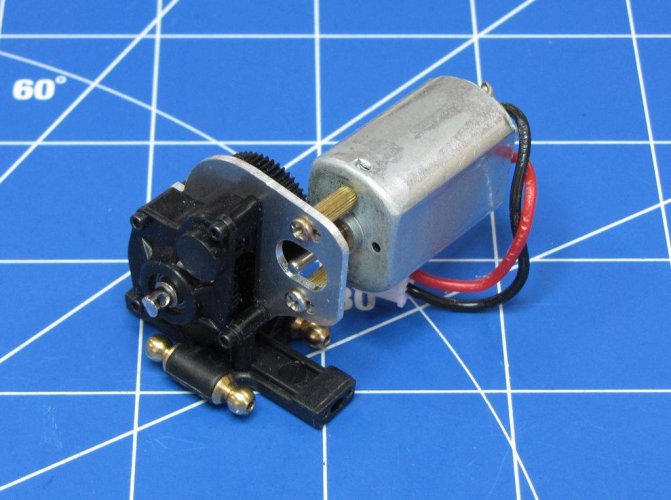

I have heard both sides of the esc cut off issue. I haven't done specific testing so will not comment further. I think the brushless motor is too fast to fix with gearing. Here is a good motor for $10. PN Racing Mini-Z PNWC 70 Turn Offcial Stock Motor You have to find a .3mod pinion to fit the 2mm shaft, or make one. I have received some but have not tested them yet. You can mount the motor as normal but will require a larger pinion to reach. I think 20tooth but have not verified that yet. You can also mount the motor from the front using standoffs and use as small a pinion as will fit on a 2mm shaft. I got the motor plates ready but I don't have the standoffs or pinions available yet.
