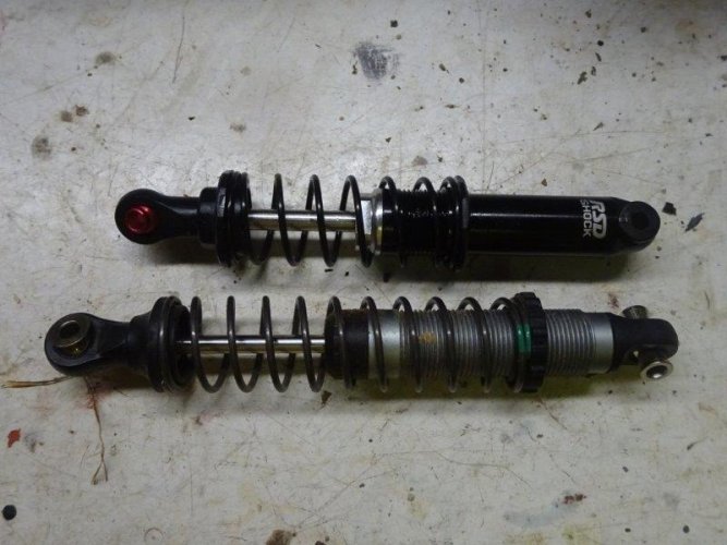

I just tried out a set of 80mm shocks (Gmade RSDs), and what a difference! The truck is much more stable, and the stance looks much better.
So I've now updated the suspension section to make that a recommendation.

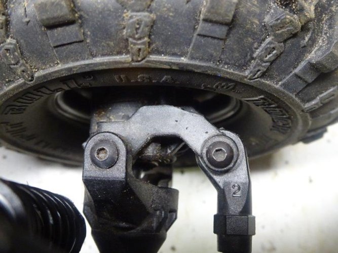

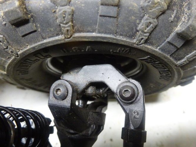

Thanks! Yes...those are RC4WD deep dish wheels inside out, and they work great. I had to do an ever so slight bit of trimming on the upper steering arm to avoid rubbing with the wide tires staying tucked. Before:
After:
With that and a washer to cover the 6mm portion of the stub, the fit is spot on. "thumbsup"
Glad you're finding it helpful! "thumbsup"
