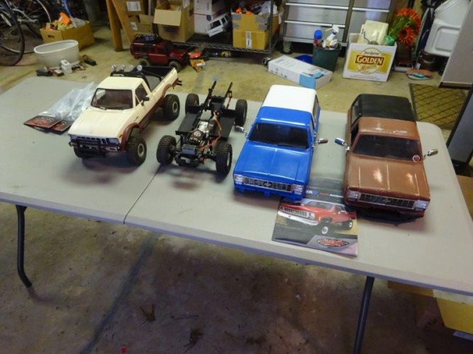

It started with picking up a couple of already painted Blazer bodies, one looking nice and clean and one...well, not nice and clean at all (but in a good way). Then out came my Mojave 2 TF2 and CMAX chassis set up for a Blazer body:

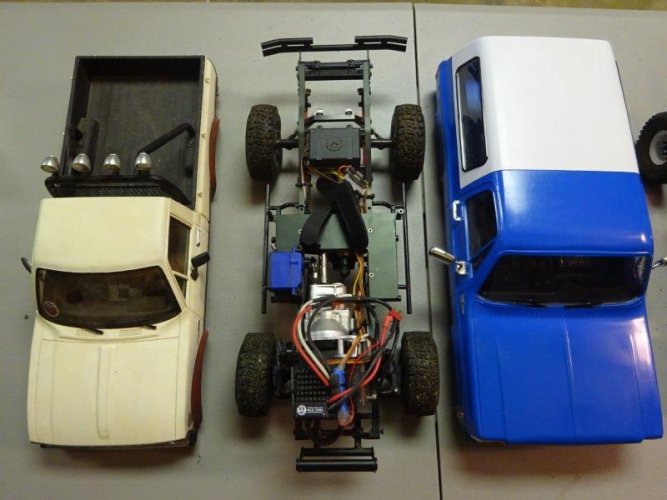

Can see where this is going...? Off came the Mojave 2 body to make room for the nice, shiny Blazer body:
That Mojave 2 body is going to show up again on a CMAX chassis with our 152mm NCYotas in just a couple of weeks, and the not-so-nice Blazer body has already found a good home on the CMAX chassis. See what I mean about killing a few birds with a couple of stones?

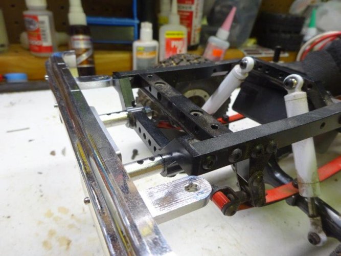

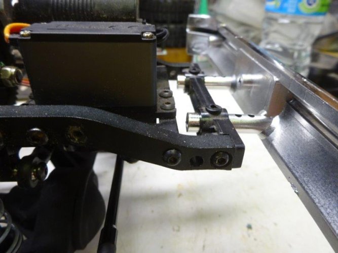

To get things started, first up was reversing the front and rear bumper mounts so that everything lined up properly:
There...that looks pretty good:

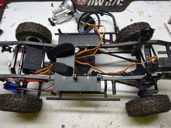

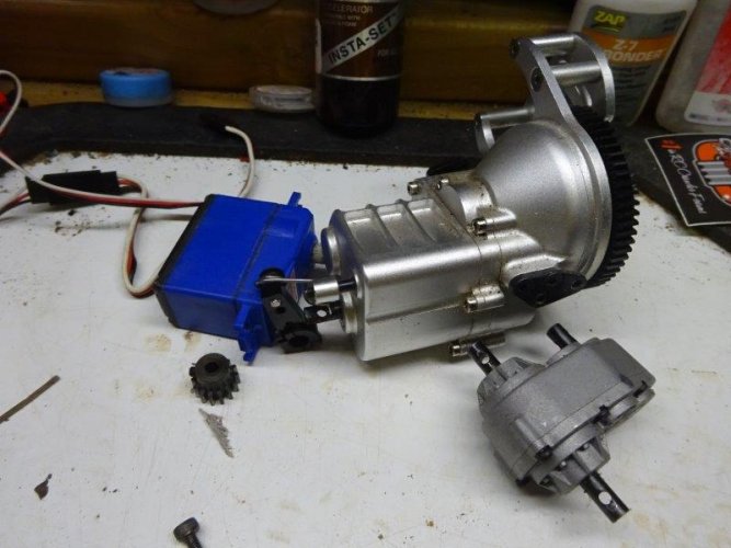

Then out came the tranny, t-case and shift servo:
Here's some stuff I won't be using on this truck anymore:

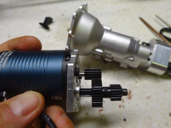

All to make room for an R4 mated to a GCM LRT2 t-case:
Why the LRT2 you ask? Because it overdrives the front wheels. :mrgreen:

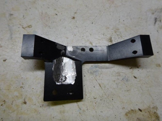

The t-shaped bracket that holds the back of the tranny and RC4WD hammer t-case needed a bit of grinding to make room for the LRT2 t-case:
With that little modification, everything went in just fine:

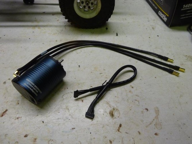

Castle has done a really nice job with this motor. I like the shorter sensor cable, but what's up with the 3' long motor leads?
Oh, well. Onto the motor plate it went:
And then back in:

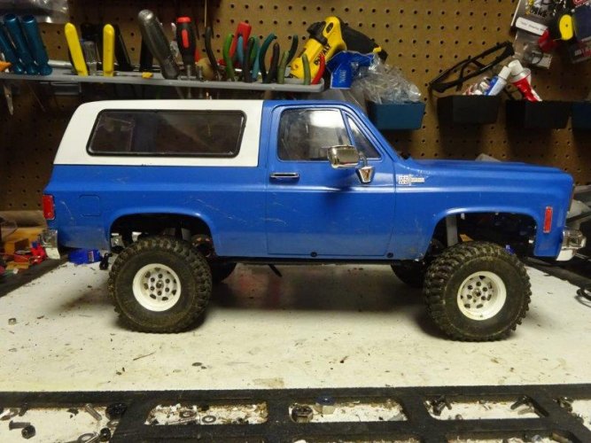

With a temporary tire swap, here's how she currently sits:
I was able to do a quick bit of testing in the yard, and the motor is perfect for this setup on 3S. Startup is super smooth, there's enough juice to lift the front wheels from a standing start (that may have more to do with a high CoG and rear weight bias from the body, but it's fun regardless), motor stays nice and cool, and the top end is fun without being irresponsible.
There's still quite a bit to do. I have a set of cast K44s to put on, and I'd like to lower the suspension (probably by going leaf under). And then there's the unfinished interior and engine bay to think about. Anyway, more updates will come as I progress.
