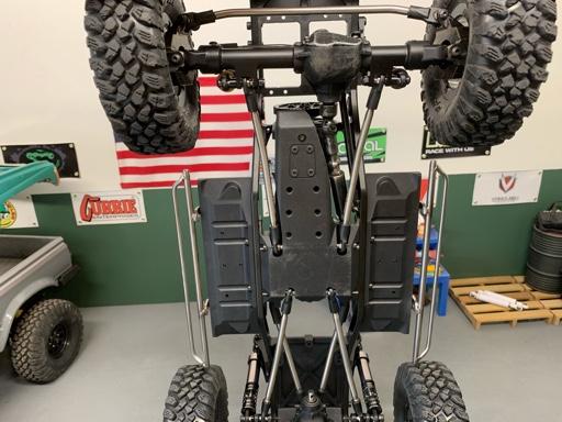

I installed these on my TK. Very nice upgrade option. The machining is super clean.
Also for guys running the VP VFD Trans these tubes will do the trick. It just involves some slight trimming of the skid.

That looks great! "thumbsup"
