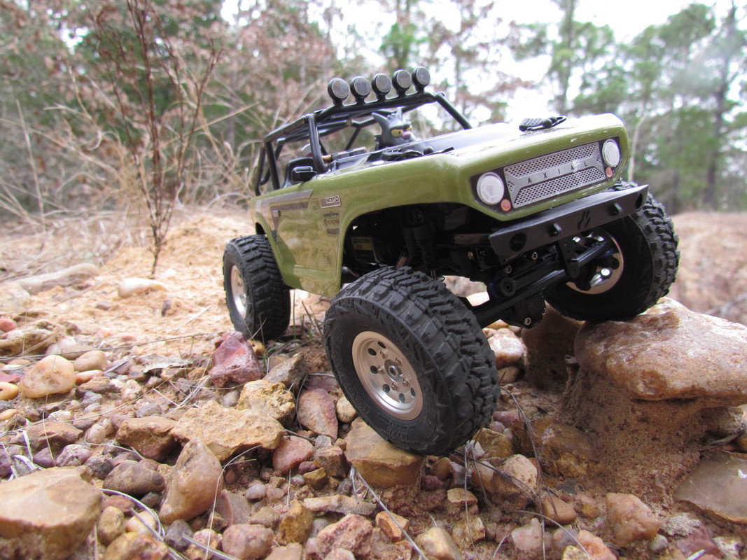

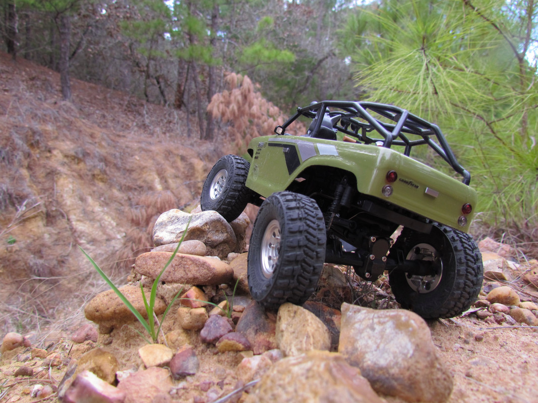

Just for the heck of it, a couple pics of my scx24 Scratchy Edition with lots of little aesthetic additions-
Nice pics. Btw, the barrage motor works in different way than the scx24 motor, you have to open the pins and connect them the other way, or solder the wires. Otherwise when you hit the throttle, it starts reversing. Forgot to mention that earlier.
Ah, thanks. And I appreciate you letting me know about the polarity. That saves me some potential hassle if I decide to drop the Barrage into this rig.
