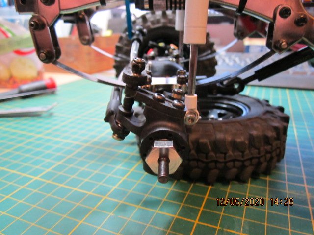

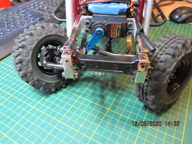

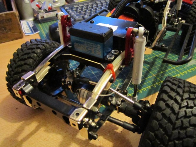

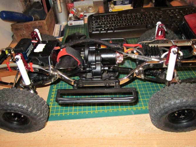

The previous pic was the first incarnation of a CMS setup, great steering but uneven throw. The CMS plate is a slightly modified plate to suit a TRX-4
I also modified the front axle assembly by giving it adjustable caster and building in KPI, turns very well now although it still needs tweaking.
