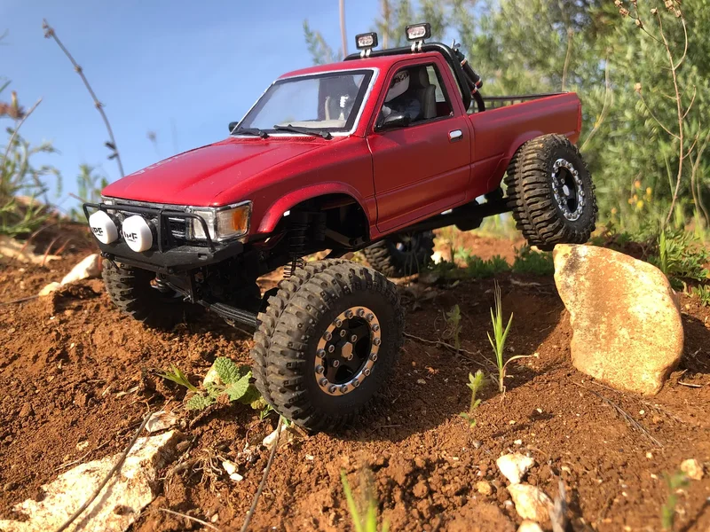

New project .. Scx24 plus Hilux 1:20 body from AMT
I moved the 'attacks of the front shock using a bracket of a servo fixed in 2 points
I have relocated the rear shock absorbers, now they work much better .. I used 2 mm forex that gives support to the frame.
I left the original springs adding some springs, cut very short, harder .. we will see with the weight of the bodywork how they behave ..
I have added brass spacers
Tire change .. I have inside some nice Super Swamper TSL Bogger mounted on Micro Losi plastic beadlock rim painted .. They are at 20gr full wheel against 10gr of the stock ones.
I placed the battery in the center
To lock the body, I added Velcro to the rear and magnets to the front hidden in the engine compartment that grip directly on the iron of the frame.

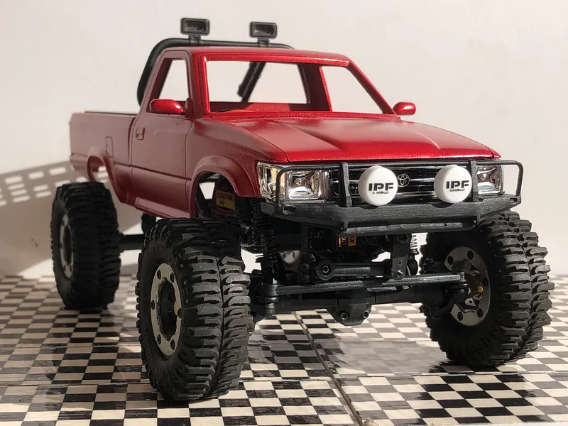

I changed the bumper .. Now ARB style.
After removing some material, the bodywork now sits as low as possible and rests on the chassis, both front and rear.
Color .. I chose a Tamiya Mica Red, I wanted something metallic ..
I replaced the servo with an Emax ES08MD
I finished the bumper, painted semi gloss black, added spotlights
That's all for now..
More details..
I found the space for the LED cables, now I have the lights
I added some shackles to the bumper

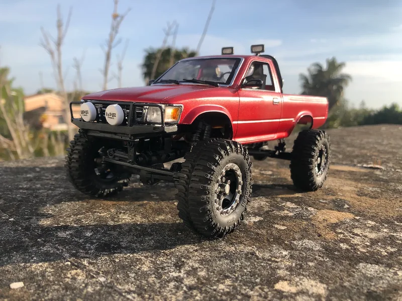

New rims ..
I put the Super Swampers, they are narrower and a couple of mm smaller than the Mickey Thompsons ..

I painted the interior, added the windshield and wipers .. I would say the project is over ..
upload images to web
Outdoor test. Very satisfied, it moves well and the shocks have a very realistic movement thanks to the weight.
