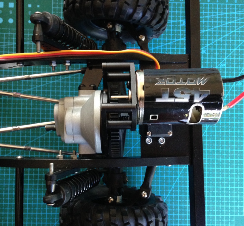

In the last pic it looks like the motor sticks out past the bumper.does the body fit with the Rc4wd motor and transmission?I think we are both building the same truck lol.
Good eye. It does not fit with the motor mounted. That was the first test fit I had done with it mounted. Without the links and moved back between the shock towers it may work.

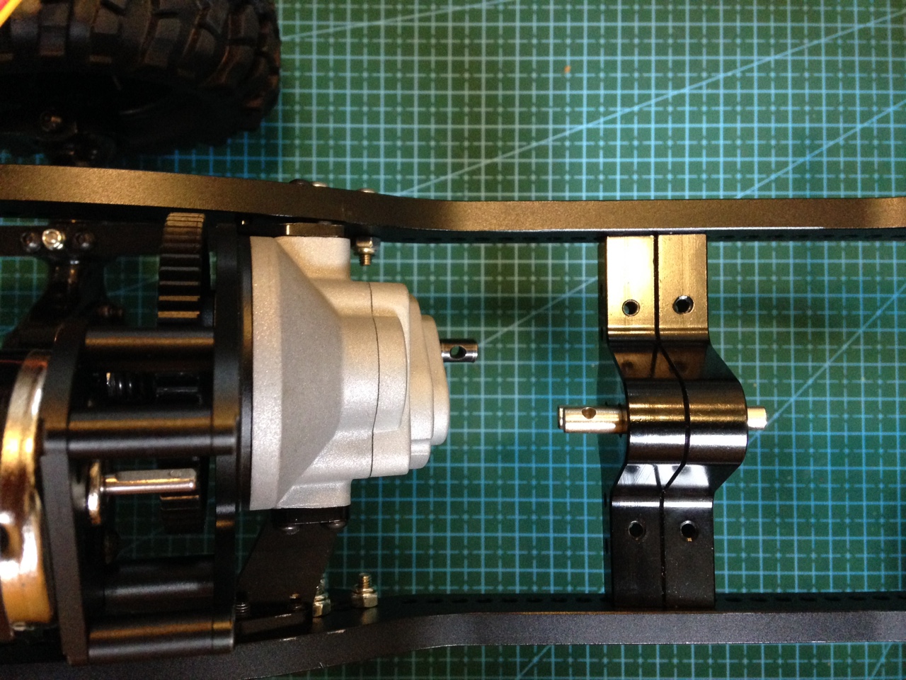

Started trying to sort the RC4WD tranny and discovered that it'll mount up just ahead of the rear spring perch for the front springs.
But nothing lines up right.

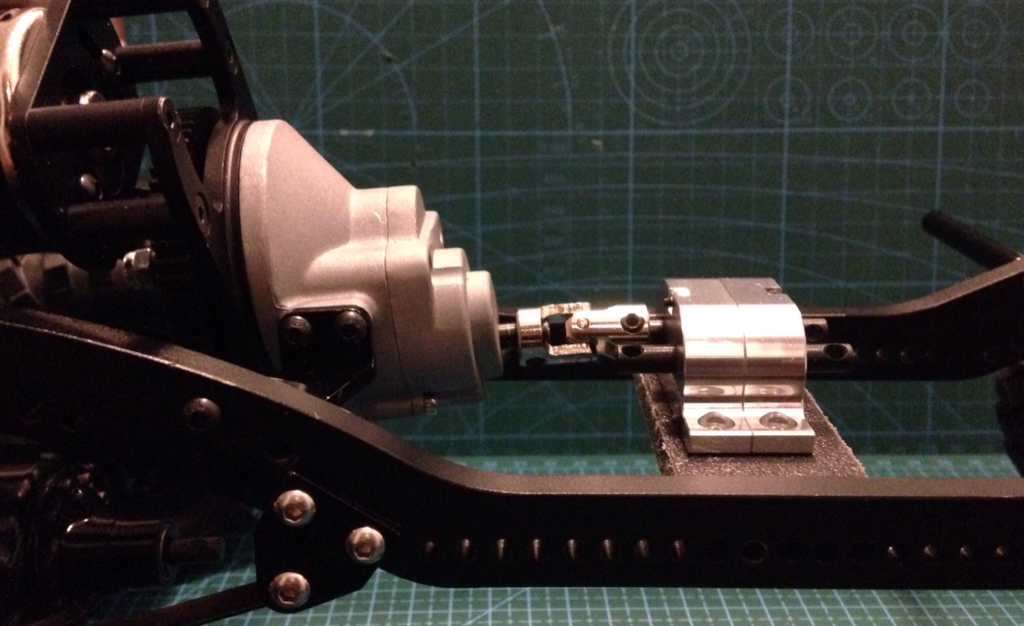

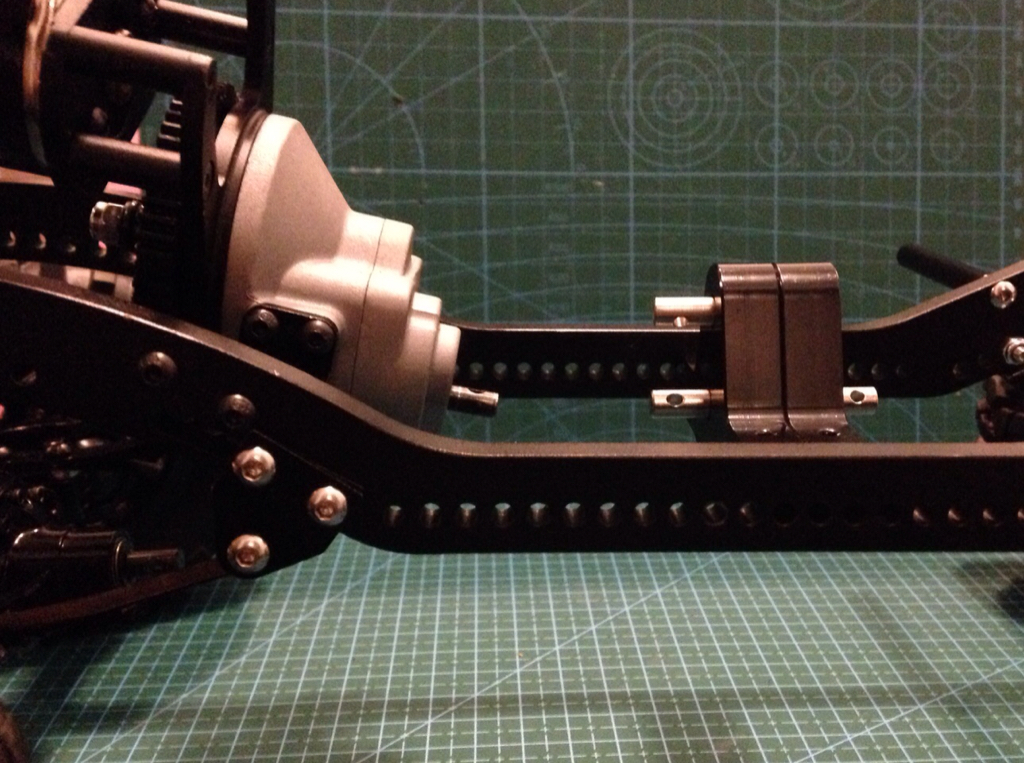

Figured out the RC4WD tranny does indeed mount up and nearly the same location. But the angles are all wrong.

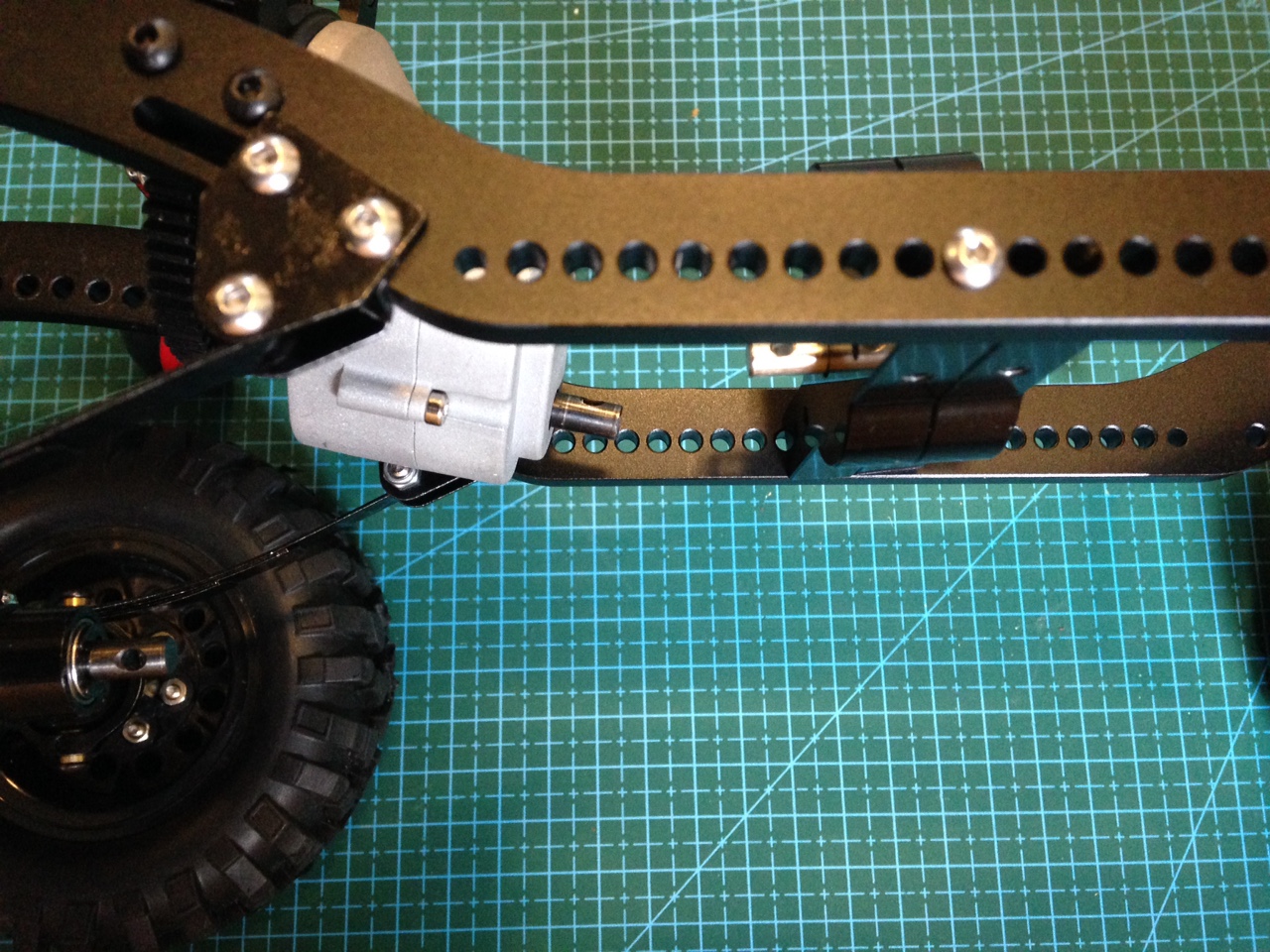

But I can remove two bolts and rotate the tranny a little past level. I'll need to drill two new holes to be able to mount it like this. Then I cut a skid from a scrap of black cutting board.
Only need a single U joint and the 1:1 transfer case may work nicely.
The driveshaft angles may not be too bad either.
