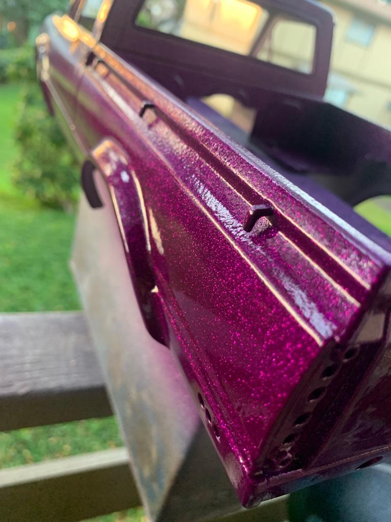

Painted her up last weekend. 6 coats of DupliColor Anodized purple.
Was a little too much purple for me, so I broke up the color with the 64 side engraved stickers from KandyNChrome on the body line & threw some aluminum tape on the bottom portion to add some contrast.
Would have loved to do a lowrider style paint job, but I’m not that skilled. Haha.
