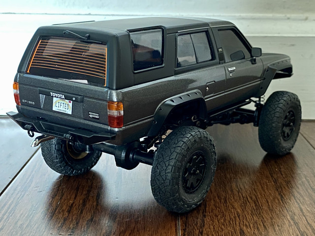

Yah...I’m trying to see if a smaller set of tires would look ok with these 1.0” wheels.
Back to stock wheels for now. Added acorn lug nuts to add scale it better.
Also picked up this little background so nobody has to see my messy shelter.

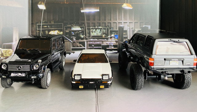

Anyone know off any painted body shells in stock. I've bashed my about and lost a wing mirror haha. I'm going to need one for bashing and one for dancing !
Ya'll got me thinking about ditching my 1:10 plans and picking up a couple of 1:24. I saw this 4Runner, absolutely love the little details on it, but not loving the tires. I'm sure they're more functional, I just lean toward less aggressive. While I do feel that 1:24 is too small to scale on natural terrain; I also have a Revell Nissan 720 1:25 model kit that's been hiding in a box for 10+ years. Getting both my darlings on RC chassis would be quite the mini garage.
The wheelbase fits 110-120mm, Damn it all to hell.
