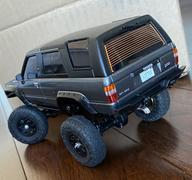

First thing done was I removed the rear spare and mount to climb up steeper inclines and balance the body/chassis.

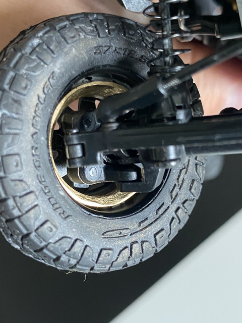

Hot racing 9.5 wheel weights helped a lot since the body seems pretty heaving. I also have HR's 9g weights that I need to trim to fit around the front hub and trim to avoid contact with the front track bar. A little putty or modeling clay can be used in between the wheel and weight to secure it.
With the wheel weights and lower center of gravity and doesn't flip as much. Instead it would lay on its back and I can go reverse from there to get it back on 4 wheels.

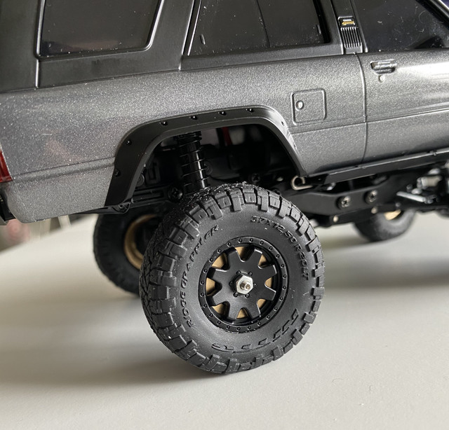

Picked up some M2x8mm "set screws" off ebay to get rid of the stock screws that secure the wheels. Now I can use lock nuts and the hub thread won't wear from continuous removal. You can also see the grease leaking from the suspension. I need to figure out a better solution since the shocks oil filled gets rid of most of the bounce and weight transfer and looks more realistic crawling around.

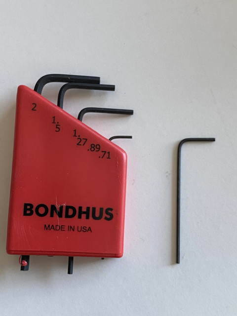

You can either go finger tight or use a hex key to tighten. I ordered a .9mm hex key to make sure they’re snug since I can’t feel if the m2 is spinning or not when snuggling up in the thread before installing the lock nut.

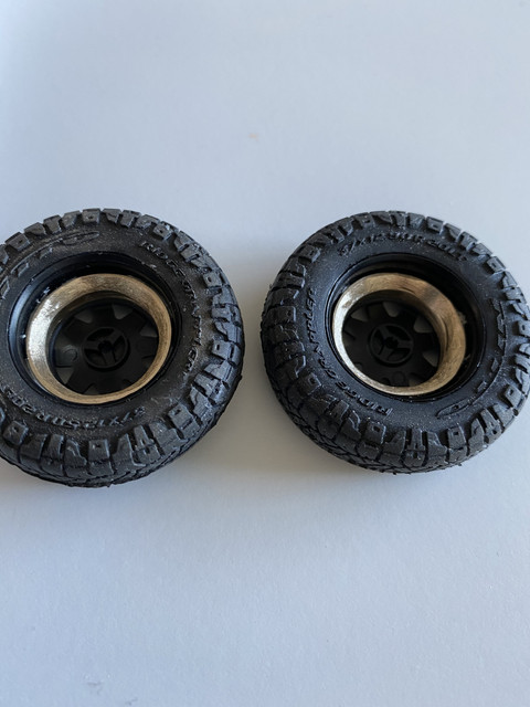

Got a couple things in the mail today. I think the next move is more grip, maybe shave off the tire mold seam.
Small hex wrench for the “wheel studs” 0.89 or .9mm is what you would need. My fingers were sore trying to tighten with bare fingers.
Got another set of Hot Racing wheel weights that I trimmed and shaved to fit around the front hub and steering. Seems to be pushing instead of climbing up over objects on my coffee table like it use. I think this is due to the lack of grip. Also, going down steep inclines, it seems to flip over on itself instead of rolling on the front two wheels and balancing for a fraction of a second then landing in the rear. I’m probably going to remove the front weights to confirm performance is worse, until I get grippier tires or lower battery weight. I’d rather not fabricate the actual chassis though. I may trim the body I crossed out in my very first post. https://ibb.co/VSh4XFY

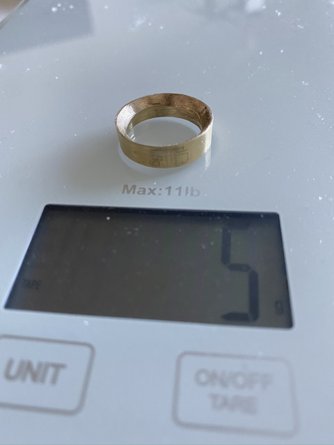

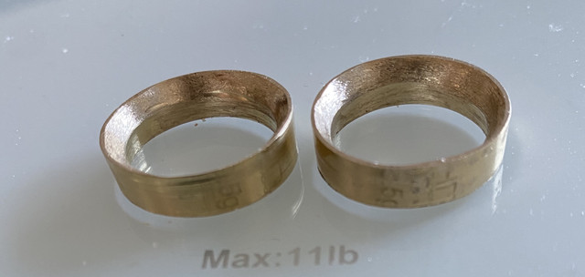

They’re now 5g so I removed 4.5g each. Now it says 5g instead of 9.5g. Kinda worked out aesthetically.
Flat side that sits inside the wheel.

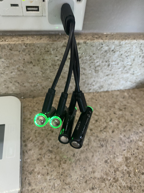

Trying these out to get rid of some battery weight.
Amazon basics at 52 grams for 4 nimh.
A LiPo pack would be around 18 grams from what I’ve read.
These are 28 grams for 4 li-ions rated at 1.5V each.
What’s the mAh on those?
They’re only rated at 400mAh. I can probably get around 30 mins of crawling around the living room. I wanted light so I had to get the lowest mAh which is fine since I only run it around 10-15mins a session.
They’re advertised to charge to full capacity within an hour.
After a couple runs with the lighter batteries, I noticed a bit more punch, likely due to the continuous 1.5V. Because of this, I’m hesitant to run these li-ons often. I’ll have to check voltage with a multimeter when they’re fully charged.

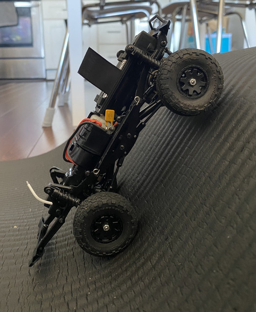

With less 24 less grams in the high mounted battery holder, it’s well balanced now. Instead of rolling forward, it will now balance on the front bumper slowly rolling down a steep decline.
Without the top heavy body, it can climb up about 80 degrees up. I used the my phones app to measure these grades. With the body, it climbed up and down about 70 degrees.

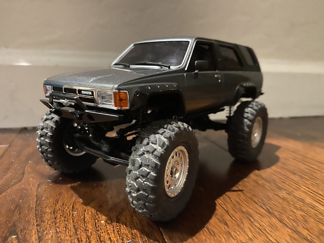

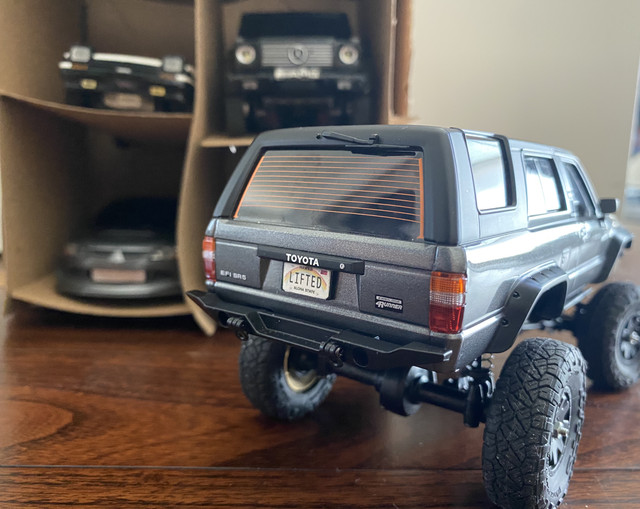

They are going fast, and I was lucky to find one. I was hoping to add some things to make it look even more realistic, but it tends to roll over. Wheel weights are a must, and if I add more weight to the shell, it is going to be difficult to find a good balance to keep in grounded. I may make my own weights using my 3d printer, and as I model up stuff I put the file out there for other folks to use.
Pic I took on the shakedown run:

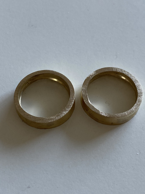

Spaced out the wheels about 1.5mm

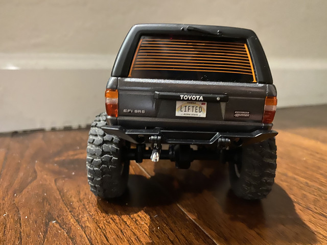

Had to flip the rear wheels weights to avoid hub contact so it looks like this now. Not sure if I’m into it, might spray black. You can also see the 12mm set screws I installed to act as “wheel studs”. Hopefully, these are long enough when I use wheel hub adapters to run the more common hex wheels like the scx24.
I wouldn’t have had to shave the front wheel weight lips as much if I had these spacers at the time.

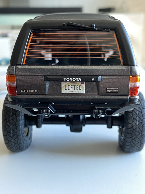

Need a better printer to redo this. Maybe I’ll get this printed on photo paper.
Apparently, letting the printer cool down for about an hour will give you better prints after some use.
Looking good NevetzG! What kind of paint do you use to paint the faux wheel bolts and tow hooks?
Small update on my end: definitely print on photo paper if you make a license plate:
