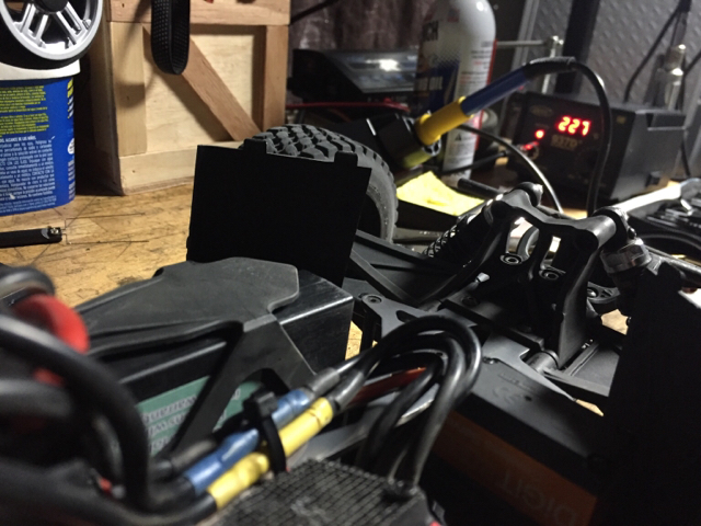

Waiting on front bumper and she will be good to go!! Word of advice, tie up the motor/esc cables down.
