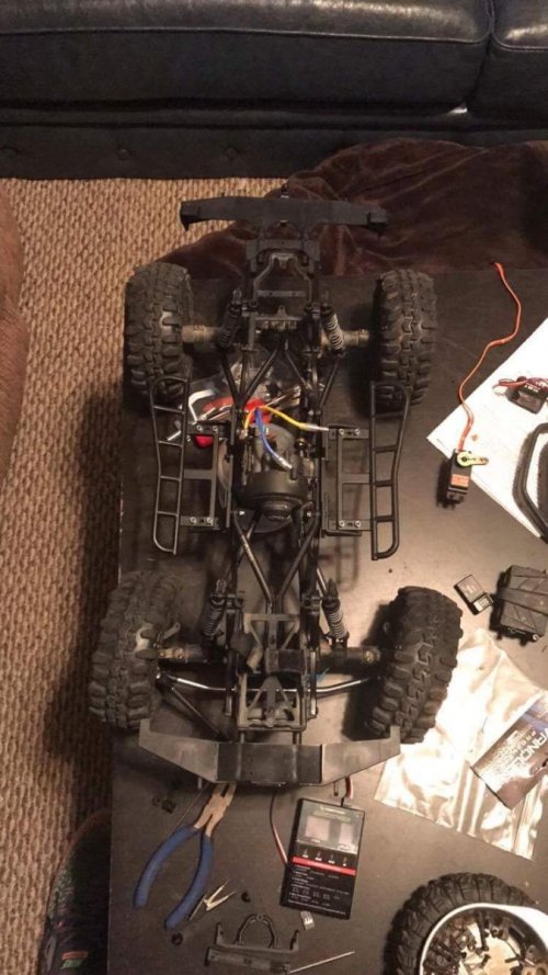

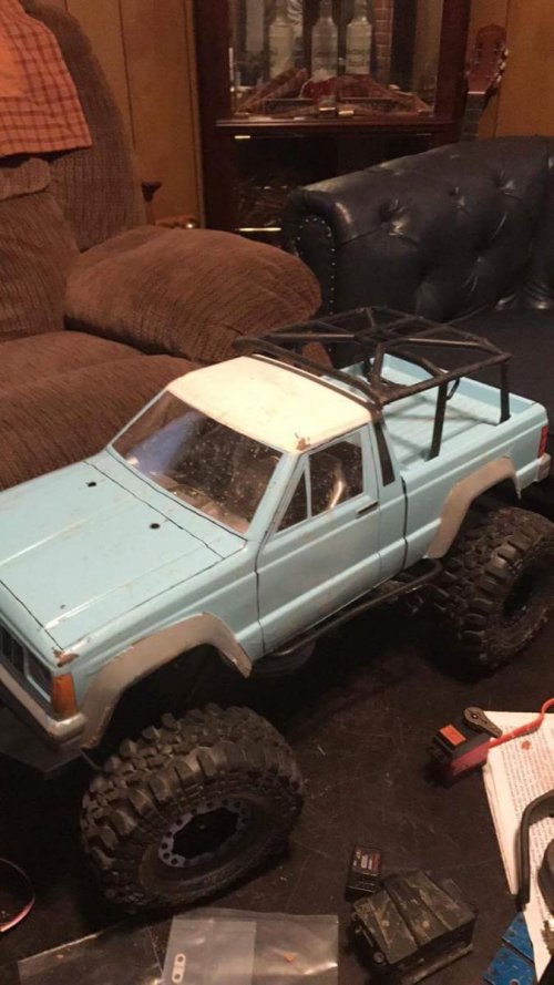

I started out with an ax10 also. I too wanted something more scale. I found that utilizing my transmission, axles, links, driveshafts, I could buy a few key components and build myself a "wroncho" pretty cost effectively. So i sourced an scx10 chassis and skid. Got myself of "wroncho plates" from one of the vendors on here for like 30 bucks, you'll need shorter shocks, but a set of stock take offs can be had fairly cheap or free. I first used a proline MJ comanche body before I pillaged that for a bomber truggy build, and now run a g6 recon wrangler body on my wroncho.

Awesome! Any pix per chance?
The AX10 can give you usable axles and transmission, the rest will have to be changed to make it a scale truck. I would say it would take at about $200 for a SCX10 chassis, skid plate, shock towers, chassis braces, links, and shocks. New driveshafts would probably be a good idea too. Then you need a body, wheels, tires, and electronics. You may not save much money on the AX10 route but you would end up with a truck that would be much more personal than a straight kit build.
I think Im about 60 into my complete chassis with all bracing. I used the battery mount from the ax10 and radio box, I had to get creative with the mounting of it all but its all there. I reused what I had on the ax10 as far as body wheels and tires, and my driveshafts swapped right over. So I have about 90 in the chassis and plates. I got the bumpers and bumper mounts from ebay for 15 bucks shipped I think, which I'm subsequently not using for the g6 body, the side rails for another 15 or so, they are plastic rpm i think. If i had to buy a body, another 30-50. So yeah most likely 150-200 is a fair estimate "thumbsup"
