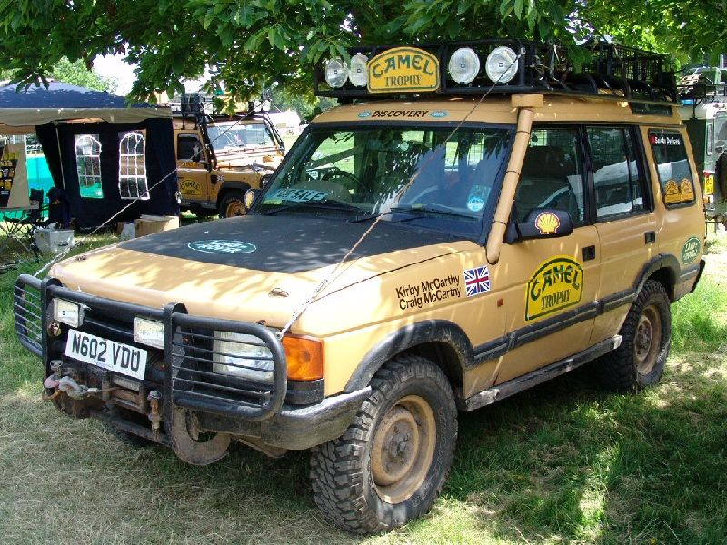

Found a GREAT pic of a CT Disco that has been mildy modified since it's participation...This is exactly what I'm shooting for.
